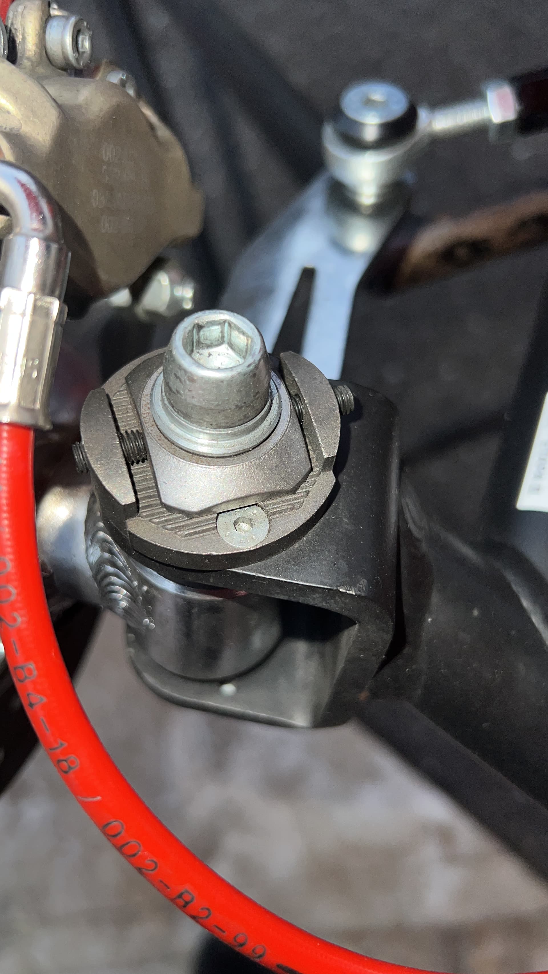

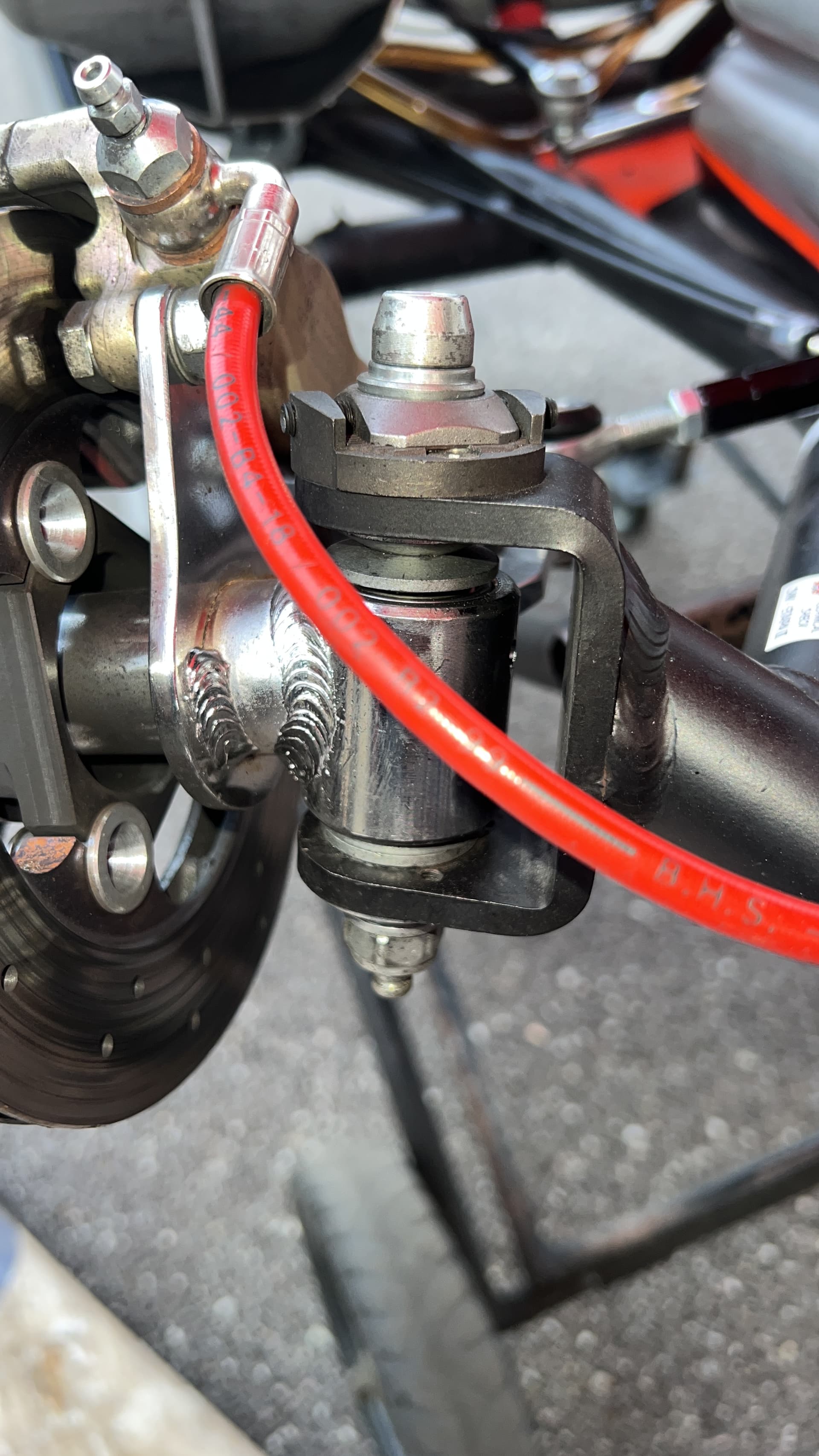

I’ve noticed your front spindles are also in the up position, with the washer at the top, raising front ride height. Try putting the washer at the bottom to raise the spindle and lower front ride height, and see the effect.

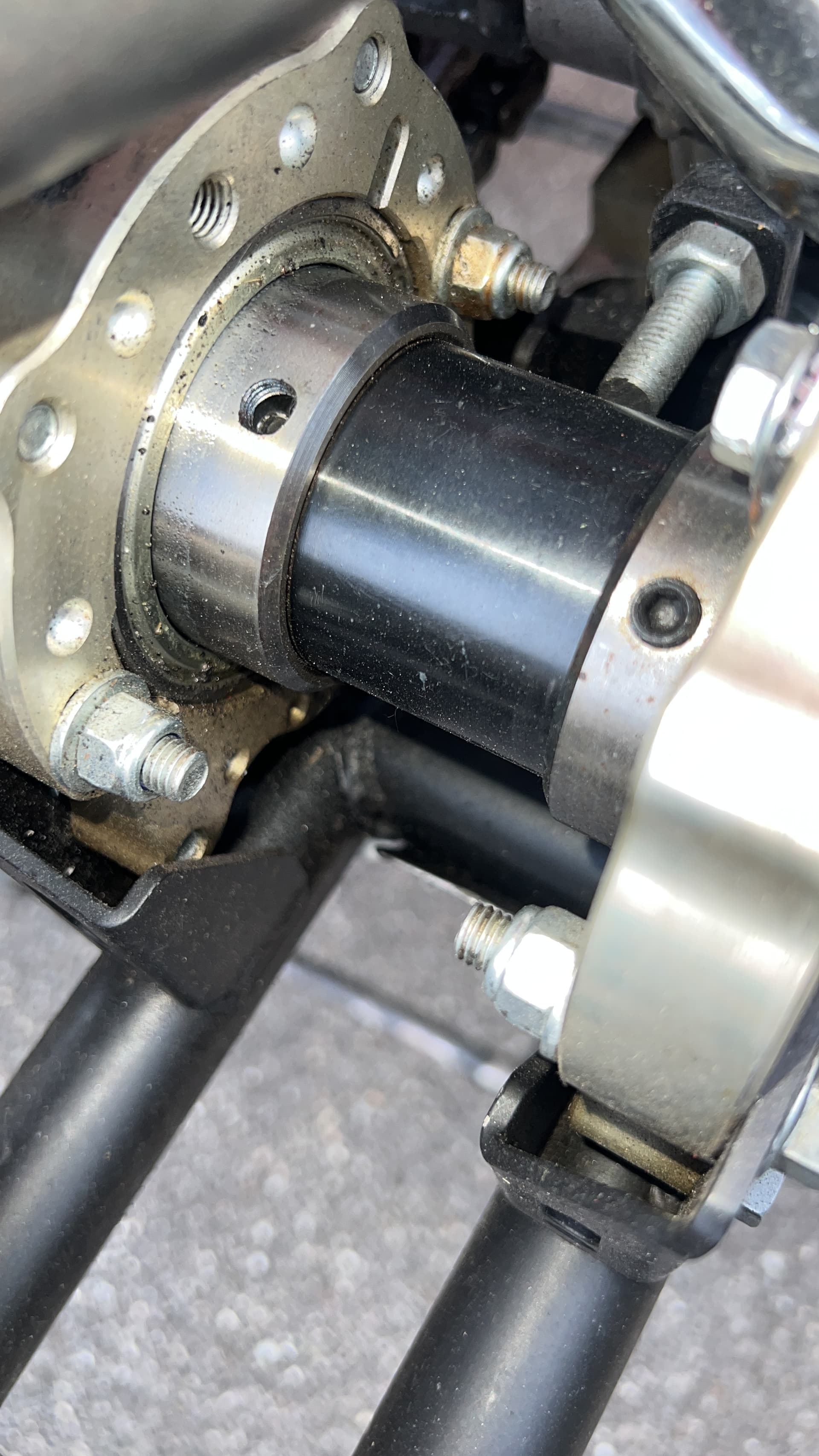

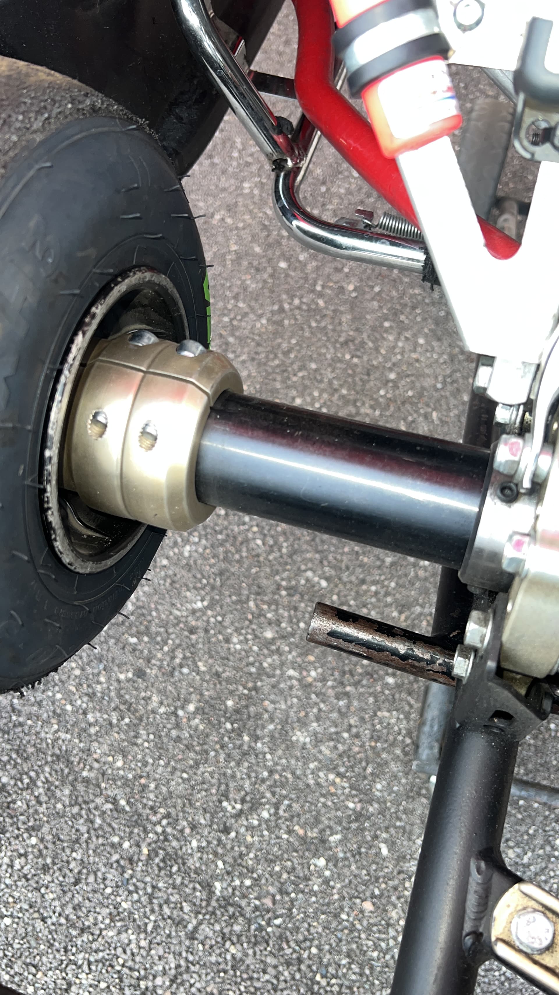

Conversely, you can also try putting shorter rear hubs at the same overall rear width. As Luka pointed out, it is also possible that you’re sliding because the tires are overloaded due to too much grip and “unhook”, instead of sliding.
This :point_up_2:t2:
Definitely a way I would go, a shorter hub could give more bite mid/exit😁
I ride the chassis at the top because there are slight bumps in some places but I don’t think the problem is because everyone rides this way as I see. The pressure I drive is 0.8-0.85 bar. Is it a problem that the chassis is 32mm? A lot of people tell me that the 30mm works much better
I would try anyway to have medium height at the front. I tend to not go to far away from base setup😁

crg has no front mid rise. Either at the top or at the bottom.

I would follow the suggestion to take a click of caster out, and also lower the front ride height. CRG makes “half spacers” that allow you to change the front ride height in smaller increments. With past chassis I’ve had from the CRG factory (DR and Zanardi) we would ALWAYS lower the front as the track grip levels came up.
