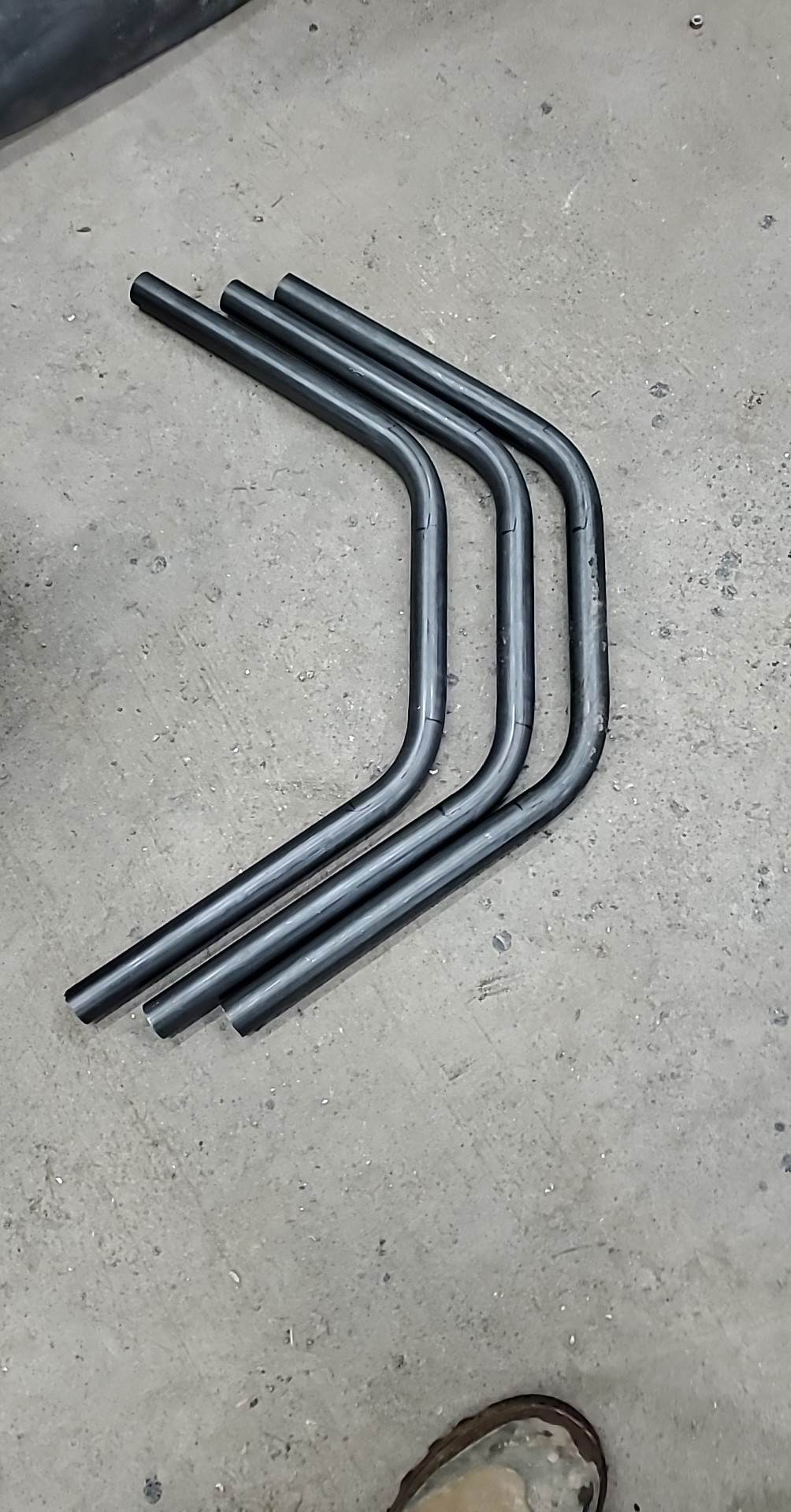

It’s bending day!

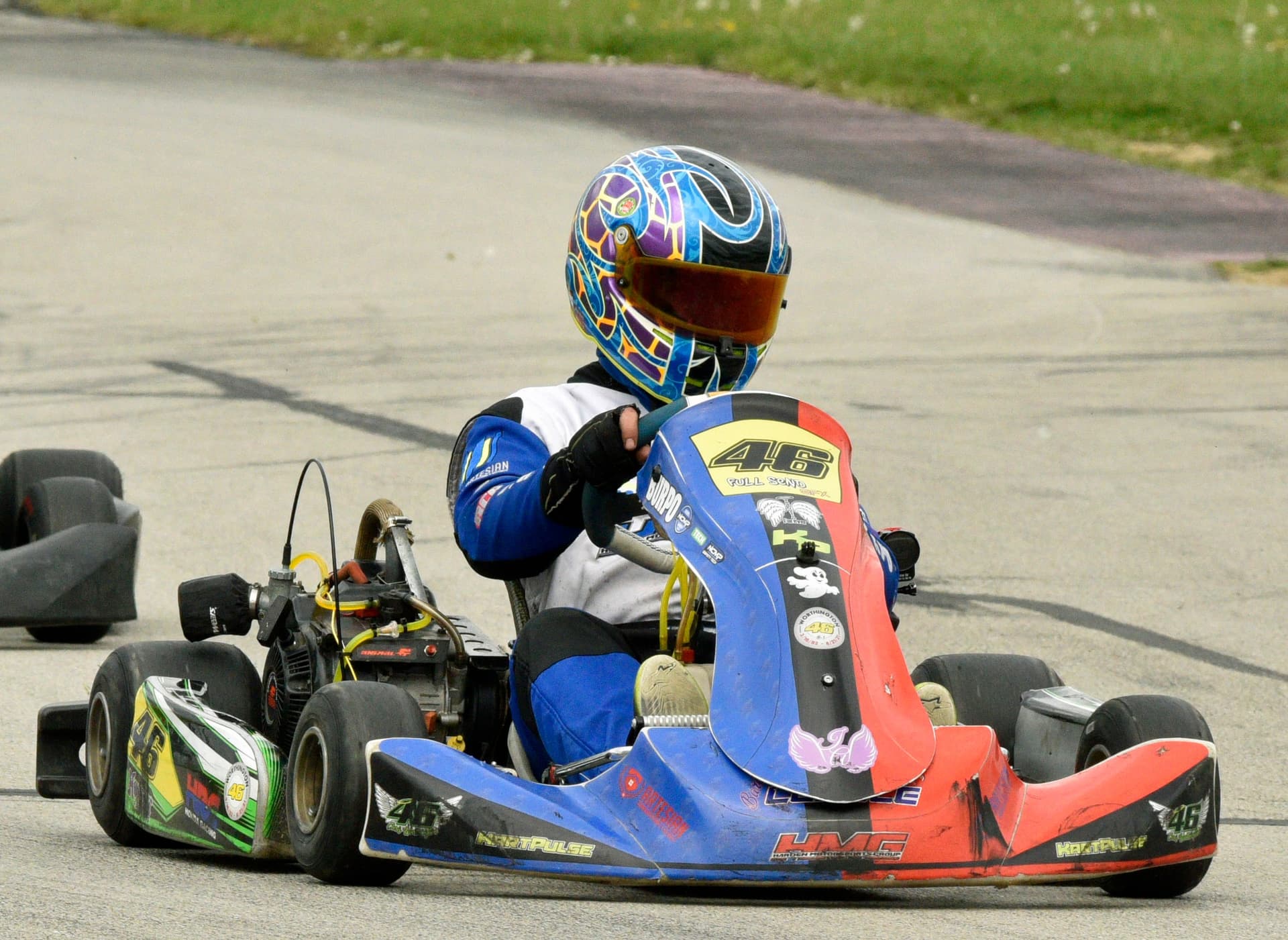

Been quietly plugging away behind the scenes here and Proto1 is currently loaded in the back of the pickup to go to New Castle tomorrow. Pics and feedback coming at the end of the day!
(Last year’s nose and fairing with Chris’s OG side pods from his 80 shifter.)
Lots to unpack from my trip to New Castle today…
Disclaimer: I’m not good at NCMP in the slightest. I got maybe once a year and am 100% a mid-pack driver there.
From start of day to end of day, we shaved 5 seconds off. The main goal was to just get a feel for the kart and try to learn how it responds to different things.
We tried some things that didn’t work, and found some things that did.
The chassis was quite a bit softer than expected and most of the time was spent trying to keep it hiked up on the outside rear, as it wanted to sit back down and flat slide on me.
Was following on race monitor a bit. Made some good strides today :+1:
Is it an illusion or are you running really narrow like a 4s?
I was pretty narrow.
51.5" rear, medium TYCA cut to 960, no inserts.
I don’t know what the fronts were… Whatever an OTK is with standard OTK hubs buried with no spacers.
From memory, I think that would be about 45.5” up front
Are you going to be using the Haase Runner stuff? Thought I read that somewhere.
Was your butt able to feel if the inside fell just from rate of lift etc or if outside let go and dropped it? Wondering since it’s softer than you thought, if being wider rear could help keep outside planted and not over load it.
Runner spindles, yes. They match to OTK aside from the actual stub being about 1cm longer.
It’s definitely just dropping the inside and not staying up. Going from caster all out to neutral helped. Raising rear ride height helped. Wider rear will likely help as well. That was the next step of I had another session.
Chassis looked great on the track for your first time out with it! I got a good view of all sides of it out there. It’s nice looking too, really nice welds and fab work!
Had a great time running with you yesterday. I still can’t belive I let you guys get under me in the last corner of the last lap, but I had it coming haha. I can’t wait to get to Whiteland and get a driving lesson from you guys when its done… Haven’t been on that track in 25 years!
Did you decide against it being a lefty chassis?
I can still make them lefties. I made this first one normal so I can swap back and forth.
