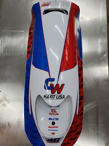

Got some pretties today…

Are these the new Burpo Rocket Karts livery?
