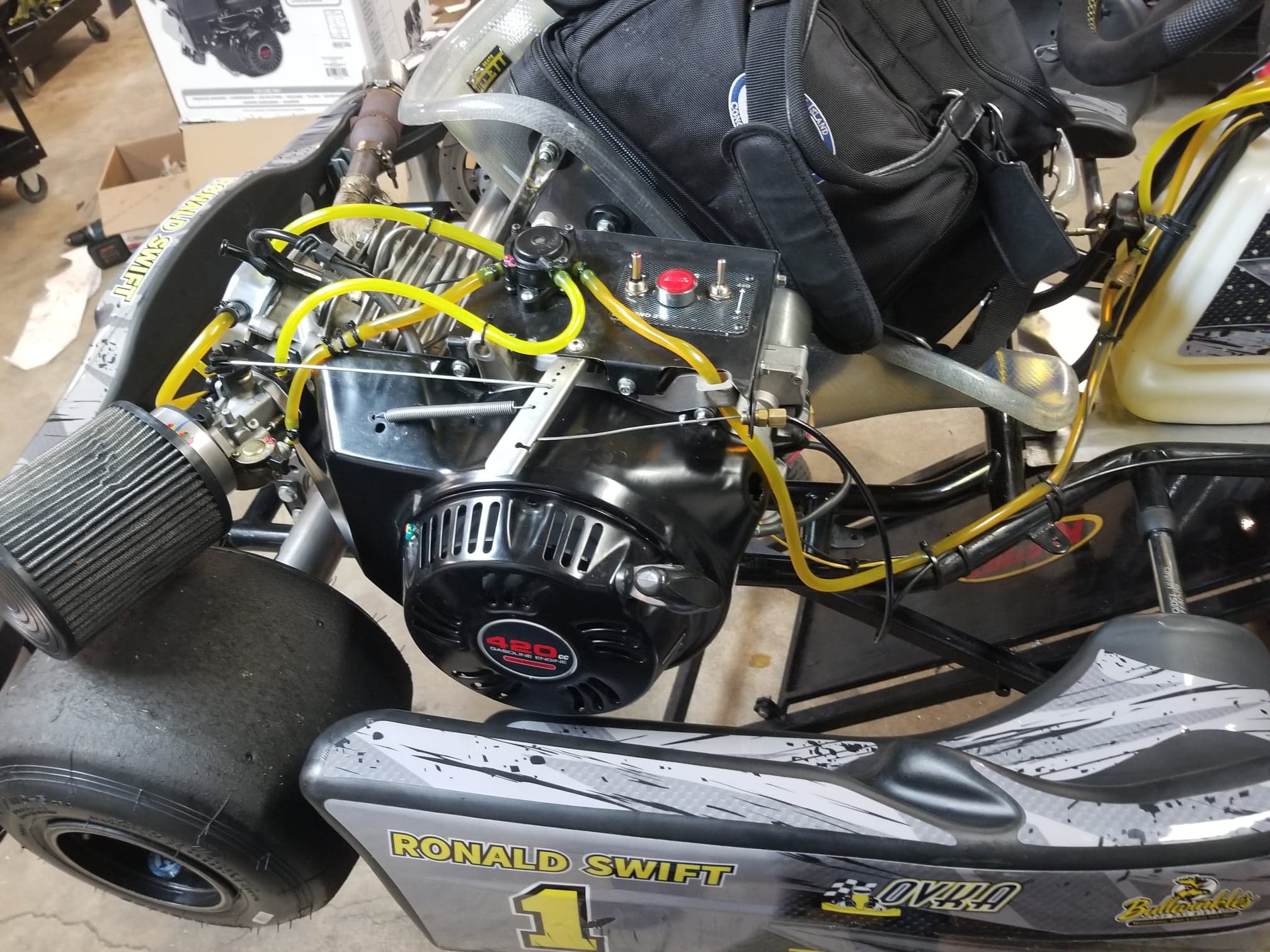

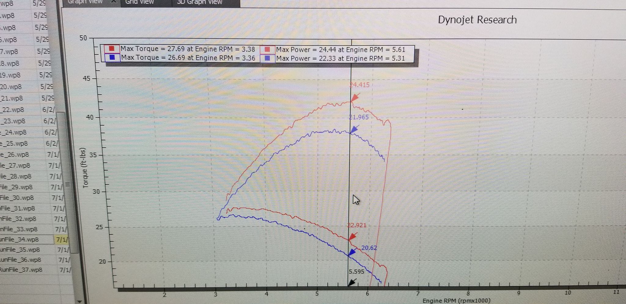

There is also a class called OVKA 420 which is a Predator 420cc based engine that produces about 25hp/32lbs of TQ with very tight rules controlling what you can/cannot do and it is a builders class no 2 motors are the same just built to the same specifications. They run same times as Yamaha with Pipe at most tracks when they weight in @460lbs but at 400lbs they will run with KA 100 class no problem.
Dyno at the Rear Wheels (TQ is higher before clutch hits)

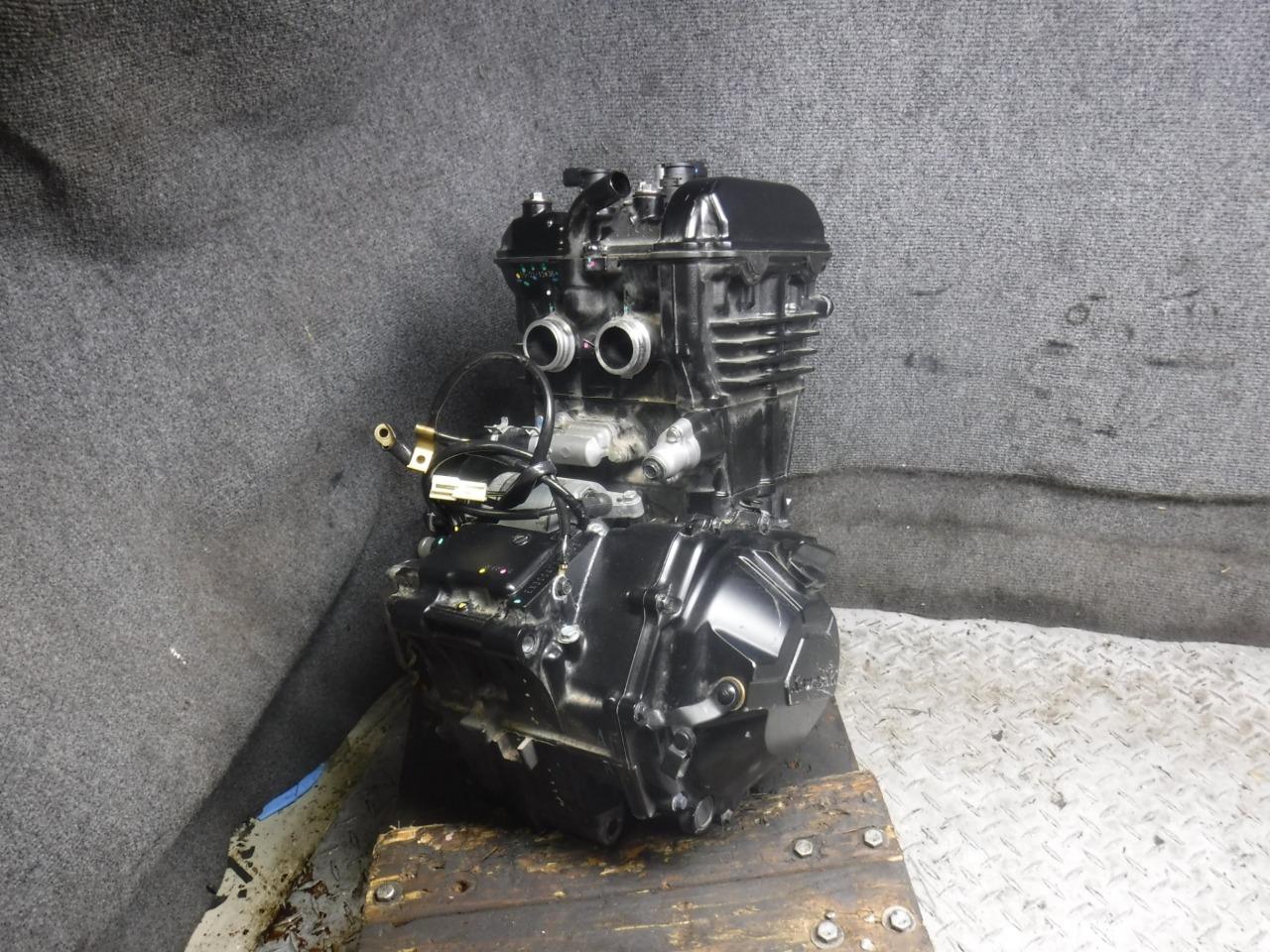

I tried to run a Kawasaki 300ex for road racing. At 29 kW (39 hp) @ 11,000 rpm and a slipper clutch I thought it would be a reliable good fit for an open class, but our karting organization is closed minded and wouldn’t allow it because it was more than 250cc.
I’m surprised you weren’t able to run the Ninja in an unlimited group where CRF450’s are permitted with superkarts.
Ron, I saw that OVKA 420 class run… I’ve been to G&J probably 7 or 8 times in the past few years. Those things are CRAZY fast. It looked intimidating to me because they are so big and fit looks challenging but for a Harbour Freight engine they are great for cheap speed and a good option for really heavy guys that have no chance racing anything else. I loved the fact that OVKA had an option for guys that otherwise couldn’t race competitively because of weight. Do you have difficulties with getting high performance parts for this engine? Are various builders still achieving engine parity? Does the rule set successfully keep costs down? How is reliability? How hard is teching these engines to keep people honest? (OVKA always had the most thorough tech for local races imo!). Do you think if an engine like this could be locked similar to 206 it would be even better? Sorry for so many questions but I’m super interested in this because it really is a good case study to learn from for a faster 4 cycle class. It’s the only one I’m aware of in the Midwest US. Thanks!!
Made for drivers who are to heavy to run in other classes you can make weight at 265lbs.
There are three/four dominant builders but 0retty much everyone builds there own, infact one of the best motors is for sale right now. The average cost to buy and build your own is about $1200 to have one built I imagine around $2000. You can expect a season out of a motor before needing rebuilt. They are usually pretty reliable but we do see failures from time to time mostly rod issues and previously piston skirt issues but the rules have changed to eliminate that issue.
Between the top 4-5 motors there is very little difference even all being built differently but all legally.

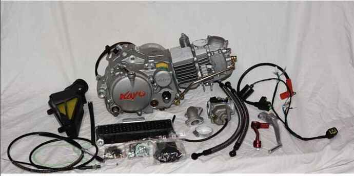

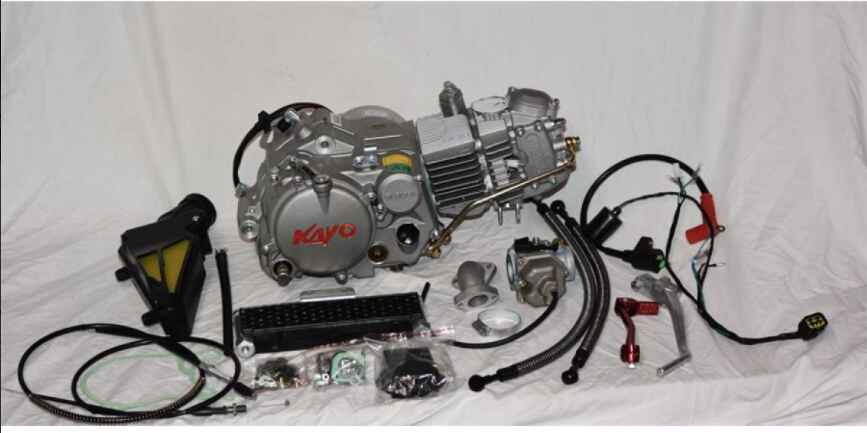

Lately I’ve noticed an uptick of interest in scooter based four stroke engines again. Here’s one project that looks like it will be an actual thing…
Here’s a link to the engine running in the vid: Explore Daytona Anima 190cc Motorcycle Engines — for PitBike
The great advantage of these scooter based packages is that they generally have an integrated shift lever and clutch, with speeds around that of a TAG, they don’t need front brakes either. So you get to bolt-on shifter thrills to your 206/100cc/TaG. The low profile of the laydown cylinder is very nice too.
If reliability, parity and marketing/promotion and incentives are done right. these could have legs
I’d drive it. Sounds good and reasonably powerful. Seems economical.
GPX Is another possible vendor. Base package as low as $400 or so for a 90cc.
https://pitsterpro.com/index.php?route=product/category&path=10
I’ve been eyeing up the larger cc models for my rentals, not gonna lie.
https://pitsterpro.com/index.php?route=product/product&path=10&product_id=83
/frustrated their website doesn’t have featured images defined on their pages :smiley:

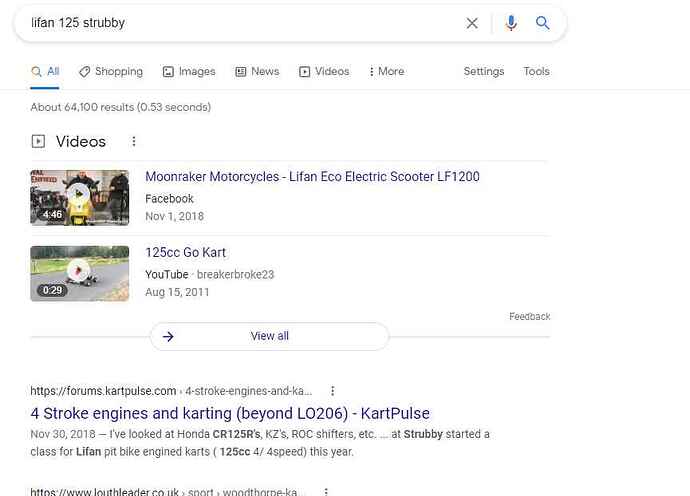

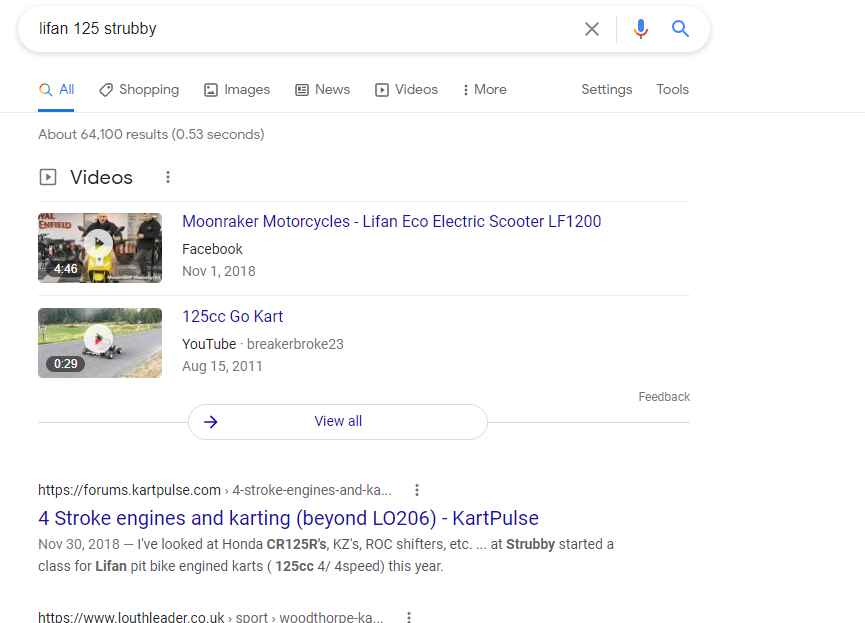

We have something like this in the UK at Strubby. They use 125cc Lifan engines
Nice! Any idea what kind of challenges they have on reliability or parity?
When I did a quick google on the class I found this…
