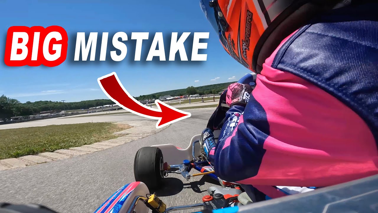

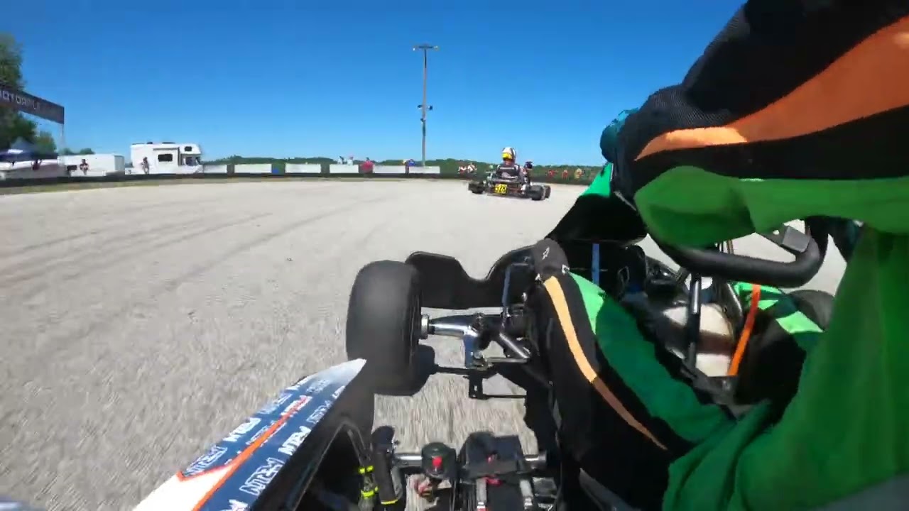

So the first image you have isn’t the corner you have pointed out on the track map. The first one on the track map (right-hander) is a steep downhill drop that is banked and the radius opens on exit, so you need to get down to the curb early and then let the kart track out on exit as the banking catches you. Plus, the entry is curved as you come off that curb, so there isn’t really a way to set up wide anyway.
The first on-board image is off the double-rights or carousel just before the final section. There you need to turn in earlier too to double-apex it, rather than sticking out wide and late apexing it. Since you’re chopping off the exit to set up for the right-hander that comes next, you need to keep the kart fairly slowed down through the second apex anyway, so late apexing it only makes the corner longer and costs time. Like I mentioned to Olivier:
The fast guys REALLY drive it in hard there, braking so late they’re almost in the corner, and they really diamond the corner off a bit more. Use the first apex area as a zone to slow the kart down, get it rotated in the center, and roll into throttle early, keeping it low on the exit. You’re too focused on making it a late apex, when it needs to be more of a double-apex.
The next corner you pointed out on your track map (double-left) is another one that opens up on the exit, so you can take more liberties at the entry since you’ll be tracking out more on the exit anyway. There’s also a little bit of a ripple in the track closer to that entry outside curb so braking and turning in there makes it super easy to upset the kart. The most important thing in that corner is getting the kart down to the apex at all costs and letting it down around the bottom. If you swing out too wide in the middle of those two apexes, it just slides and opens you up for an overtake into the next corner.
