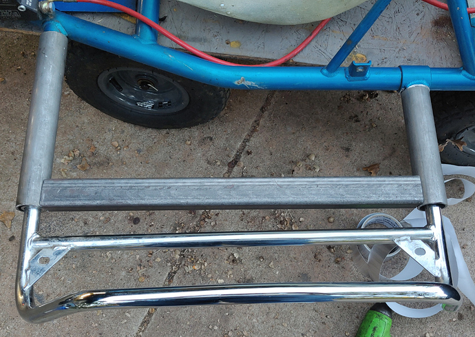

Finished cutting all but the forward battery tab, ready to start welding. I think this will work great (if a bit heavy). Should be plenty strong.
Shown with bare battery base. Area scored to the left will be cut out for wheel clearance.

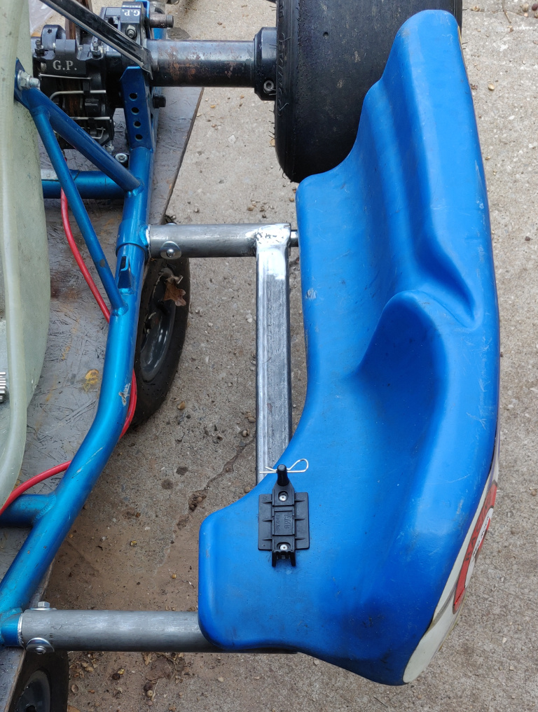

Sidepod battery holder welded. The OEM sidepod bar can slip on and off separate of the battery holder, but it is attached by the front bolt for now. I need to get it painted today and decide what to do with the sidepod plastic. I can cut the current one at the front to start with, but something thinner would be nice long term to match both sides up.
Is the spacing on these mounting points somewhat standard for adult karts?
I think so, although I have never measured it.
Curious about this question too. Is the distance as shown by the yellow highlights the same for all karts?
EDIT: I fixed my pathetic grammar
FWIW the distance between the pod mounting sockets on my chassis is 17 3/8 inch. centre to centre.
This is an old chassis and may not be representative.
Meassuring over my wider tubes and subtracting the width of one tube, my 08 CRG chassis measures 19.727 inches. Converting this to Metric produces 501mm. So a 500mm design width center to center.
Excellent info. Thanks.
Nuxland confirmed that his is also 500mm. Hillhater also posted this:
CIA kart regulation specs are online. And sites like this can be useful…
https://www.fiakarting.com/page/technical-drawings
Great info. Thanks for sharing this.
