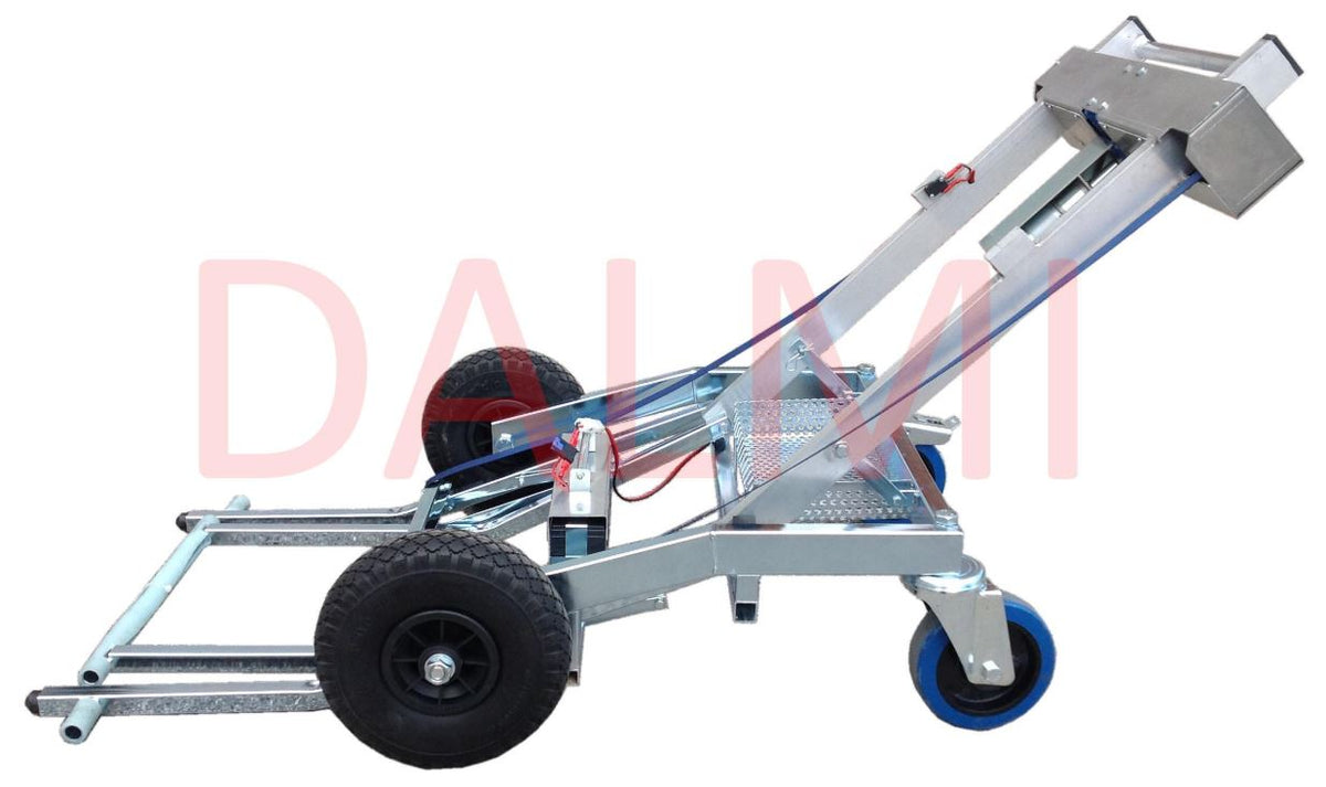

I use the Dalmi Kart electric kart trolley and am very happy with it. Comofortable height to work on, easy to use, battery lasts very long. Can certainly recommend.

The Dalmi stand folds down quite small for storage.

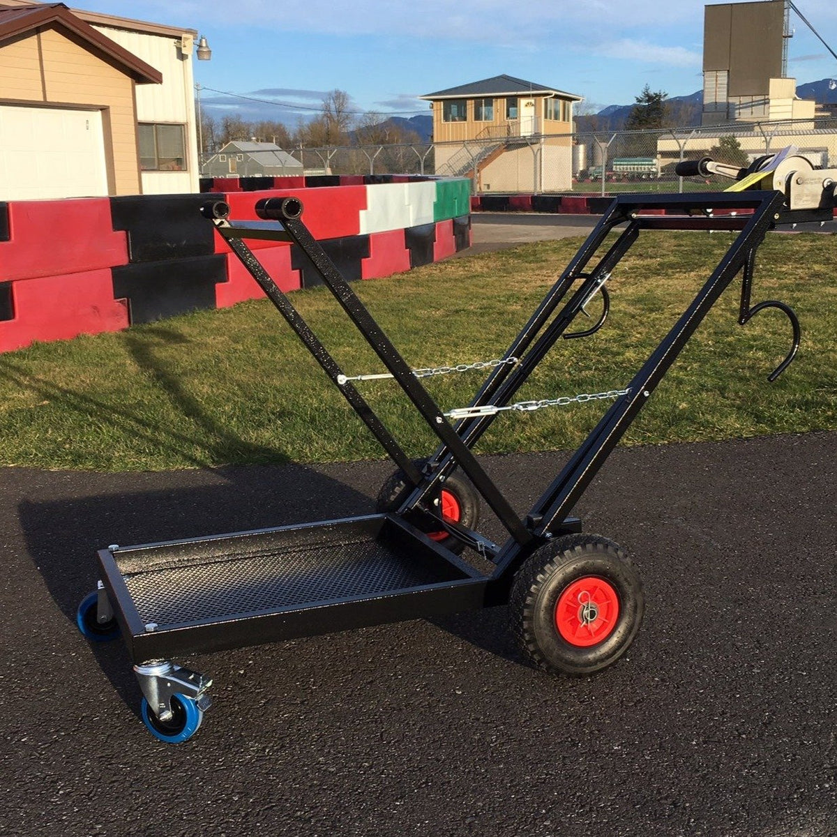

What about the non-electric one man stands? Like stone? Much lighter.

I believe the Dalmi weighs about 20 kg plus battery 5 kg, folds quite compact. I usually Transport it standing upright behind my kart in my trailer. Maybe that helps.
How is the stability with those Dalmi big wheels? The wheel track looks too narrow to deal with the horrendous pit areas out here. I dumped a kart with European style trollies because the track wasn’t stable enough.

Thank you everyone for the replies. The Dalmi definitely works for me, but man that’s a steep price tag. That Stone stand is interesting, but unfortunately doesn’t fold up small enough for my particular case.
This semi-automatic is probably your best bet for not insane money. It’s a winch which is easy to reel as a 1-man job. They also sell a fully automatic which is relatively compact/light, but for similar money as the dalmi. Only drawback is the winch part does stick up a few inches higher than than otherwise compact folding setup. I agree with others that the kartlift/streeter models are ridiculously heavy, probably around 80lbs, it can be done but not fun to lift (not an issue for those with trailers).
The Dalmi is pricey, but really nice. I finally bit the bullet after tweaking my back at the track and bought one. Where are you located? There is a guy at our club here in canada that imports them directly from Europe and sells them for a lot less than Italian Motors.

I’ll be grabbing a Dalmi at the end of this year. I’m usually a one man operation at my home track so just makes the most sense. I currently use a E-350 Box truck to lug my stuff around. But I have a normal rolling two man stand that I can get it in and out by my self. Just have to figure out how my strategy will change getting the kart on and off with the Dalmi.

The Dalmi would slide right under that shelf you have there, no problem.
