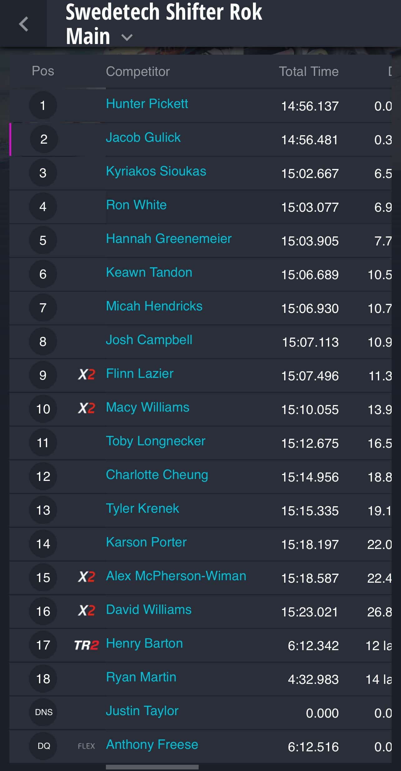

There was actually a respectable amount of shifters at the ROK challenge of the Americas this year. There were more shifters than ROK GP master, senior, & junior combined.

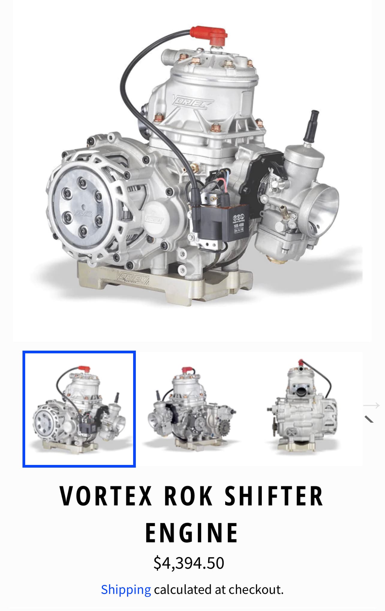

ROK is more budget friendly, but not what I would call majorly.
Well at around $2k in initial purchase price alone it does seem more budget friendly. Jumping from Rotax/X30 I’m sure the ROK is plenty quick.
