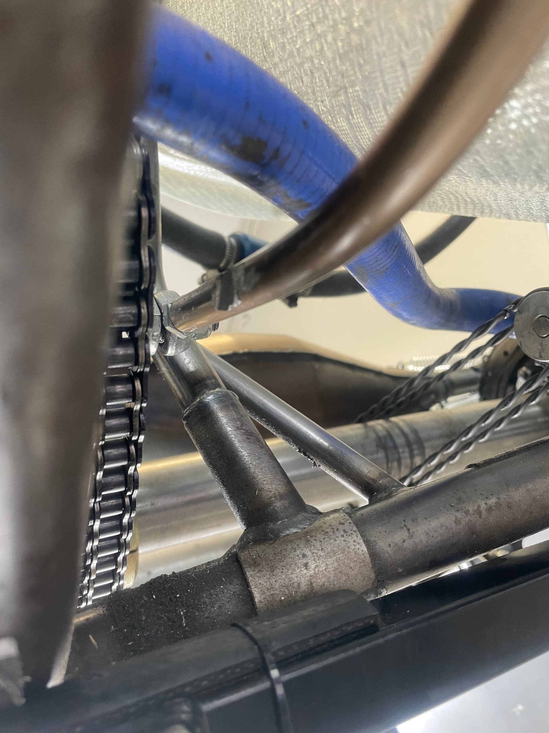

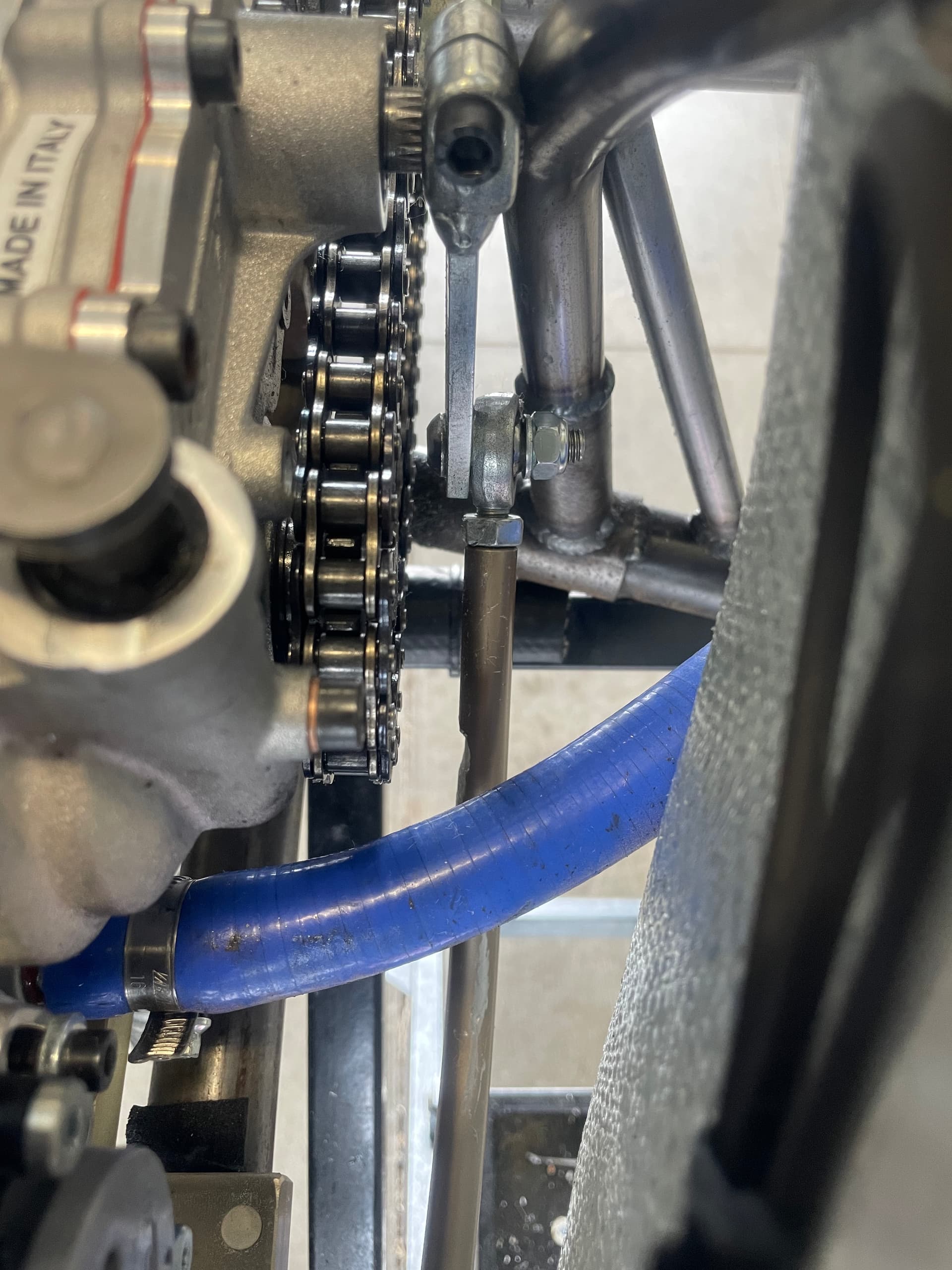

Gonna hijack this thread for a second :joy: I just got to turn my first laps in a Rok shifter this weekend at GoPro, but the clearance for the shift linkage has been less than ideal. Any solutions I should pursue to increase the clearance from the seat mount and to avoid hitting the chain, as shown in my pictures?
Longer chain. What chassis?
Praga prototype 20char
I know there’s a company making aftermarket Rok shifter engine mounts that shift the engine right a little. Gotta remember who it is, I know it’s one of Kart Chasers sponsors because that’s where I saw it.
You thinking of Rev Performance Materials?
Just found it.
I guess you could heat the J-Arm and it a bend it a little, assuming the throw is not affected by the seat bracket behind it.
