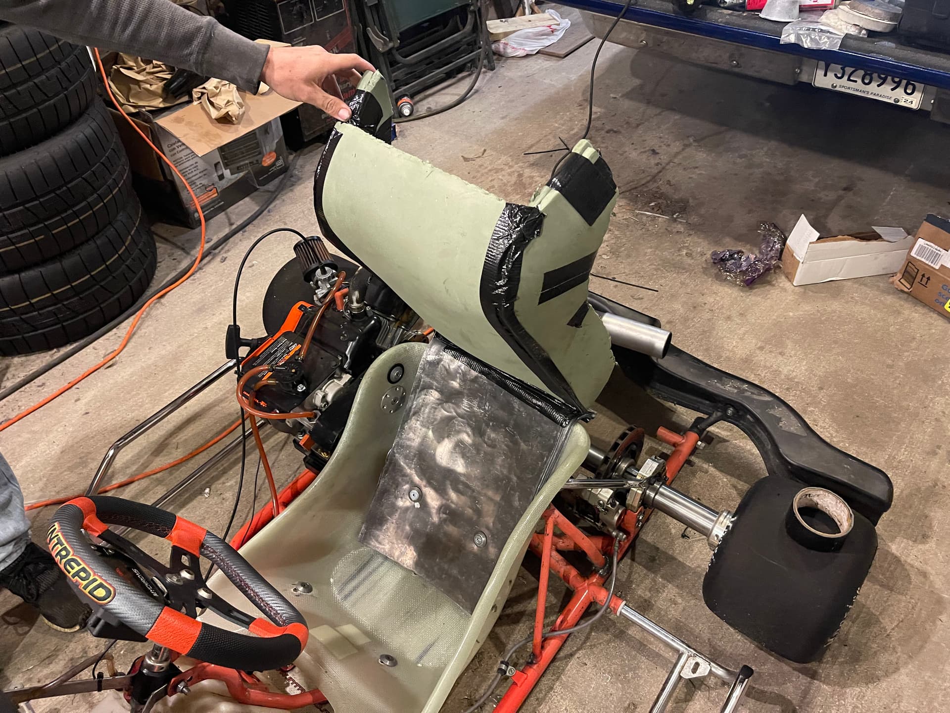

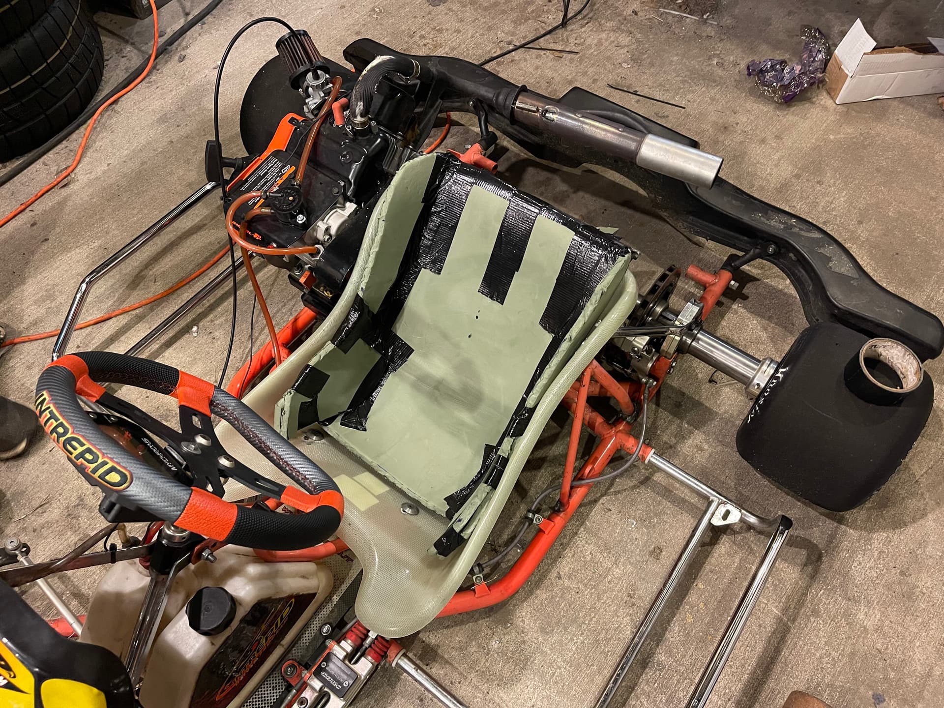

Hehe one of the fellas on my other site did this which I thought was clever. Personally I would be suspect of how it might push me forwards in seat but maybe a slightly larger seat makes this work:
65lbs of lead
Credit: HunterindaKnight

Debating in my head if that is genius or this . . . ejecto-seat!
ejecto2
Apparently the kart is shared:
“The perfect part is the guy that needs the weight is 5’2” 110lbs, and the seat is for me 5’8” at 215lbs. The lead helps him fit better too :rofl::rofl:
