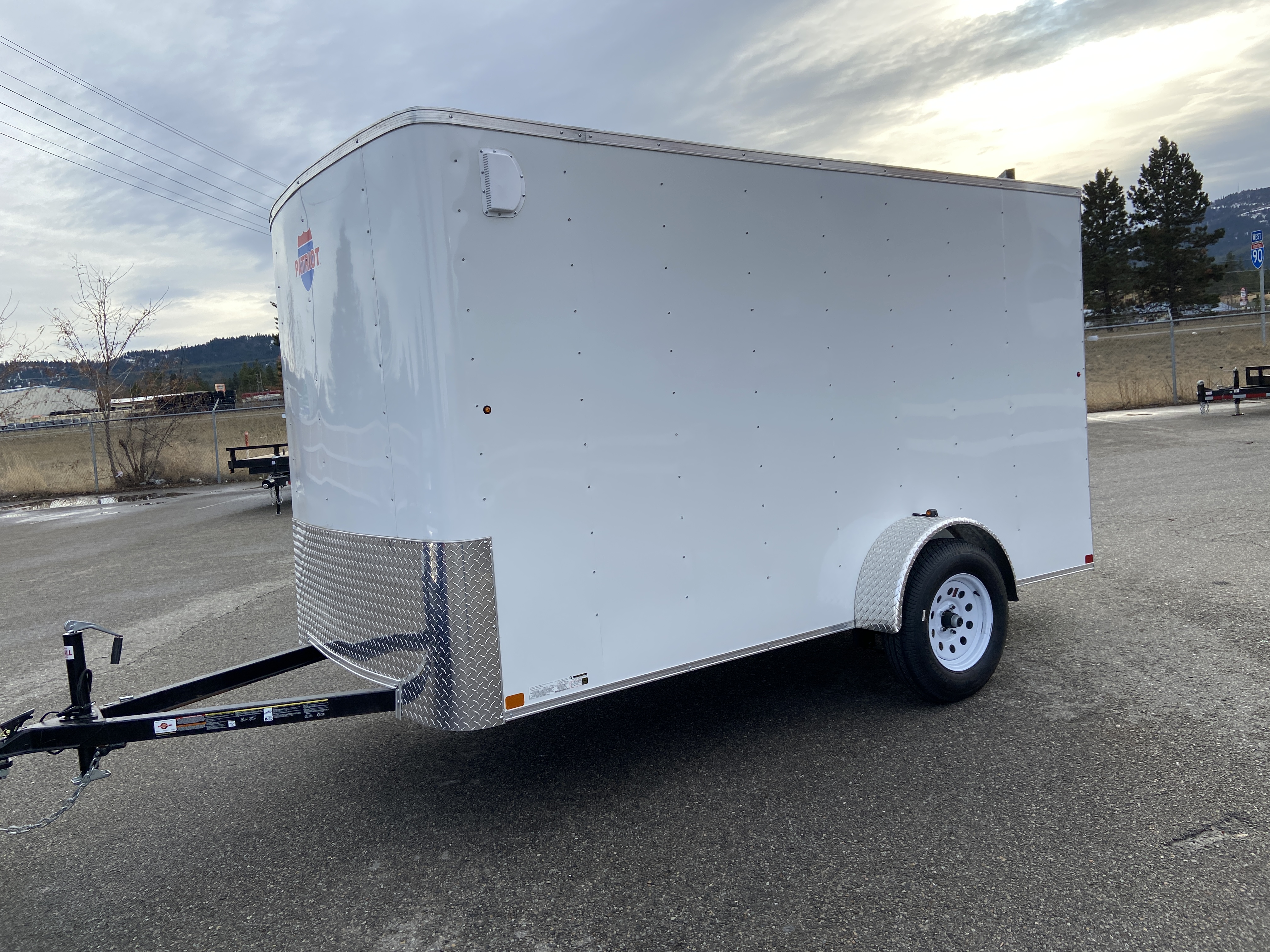

My brother and I got a trailer over the weekend. I figured I’d keep my updates in this same thread.
We found a good deal on a 6x12 in Post Falls, ID. I got 25mpg on the way up and 12mpg on the way back
We’ll spend some time over Christmas break getting it modded the way we want, and I adjusted the security cams at our shop so I can keep an eye on it when I’m home! We’re pretty excited about it.
I’ve spent a few hours perusing the popular trailer thread and I’m getting all kinds of ideas. We’re definitely coating the bottom, but not sure with what yet- maybe a can of this Kilz waterproofing coating?
It oh, you’re in deep.lol. Currently building out a trailer myself, started this season with my dirt bike utility trailer, got a 5x8, then a bigger car and just got a 6x12. Makes it much easier to lug around.
Also nice for races like this weekends race which was wet.
