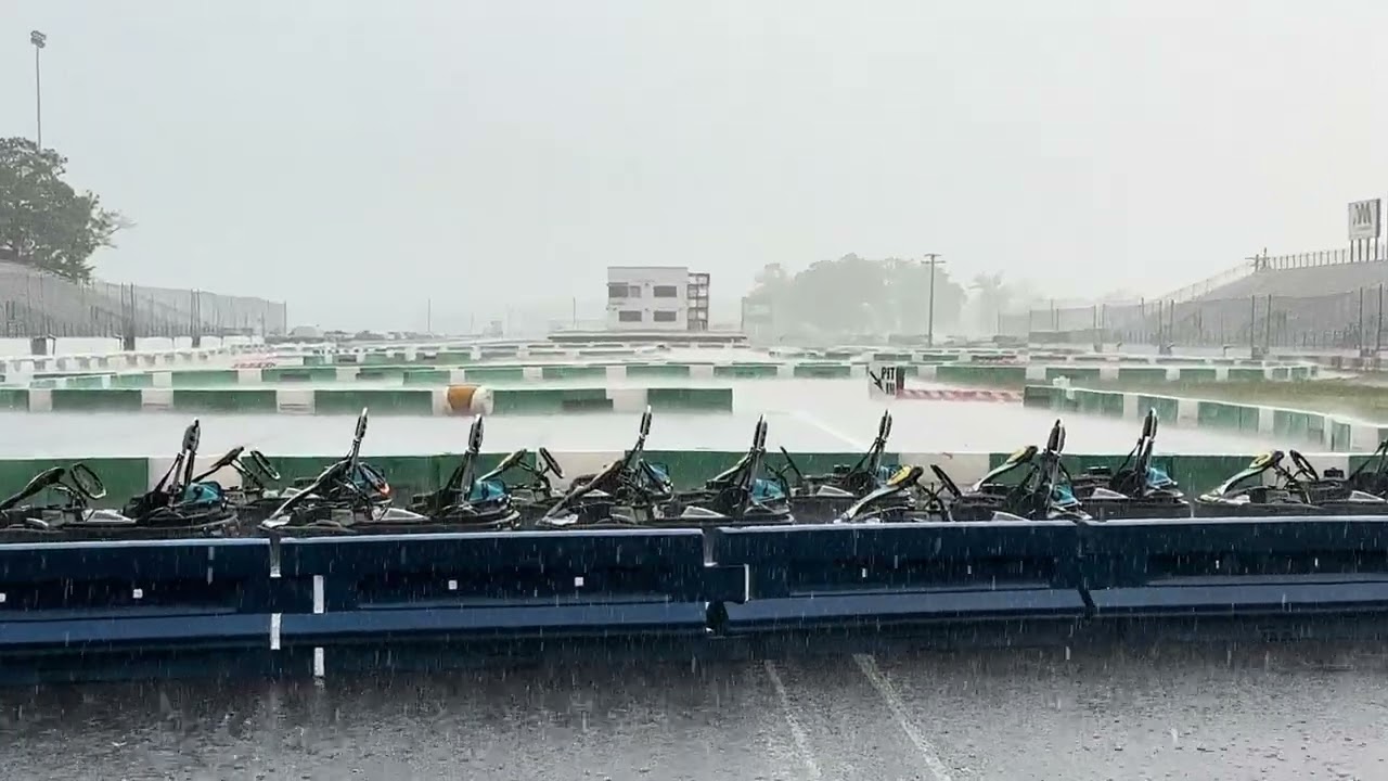

The rain sent it, hard.

This heat was really entertaining… the rain came down even harder and the track got even more soaked, if possible.
The thing that I appreciate most about GRX is Keith’s willingness to run the karts, rain or shine. This may not seem like a big deal but most rental places do not run sessions in the wet. Keith does.
As a consequence I am able to get much needed rain driving seat time and hope to eventually become a rain racing aficionado like Tanguy or Marc.
