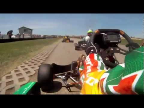

The attached video of Driver Ryan Norberg is what got me thinking about this topic. I assume he is a higher-level driver, but he is by no means the only driver I have observed driving this way. His “flicking” to me seems exaggerated but as Warren pointed out he is driving it out and making it look like it’s working. It doesn’t seem ideal to me but I don’t know much. So is this the fastest method of driving the corners?
As for smooth, TJ’s video of his KA race from 2018 is as smooth as I have seen.
Granted these are not the same classes or the same track, but it struck me how different the styles are.

Homestead is a very quick track with a lot of fast 90 degree corners and a ton of curb usage. To be quick you need to get the kart into the corner hard and fast, and chuck it around a lot more. Yes, Ryan is flicking it around a lot in the fast stuff, but look at his hands in the slower corners. See 2:16 in this tight stuff, and you can see he is smooth as glass there. This is what I’m talking about, where Ryan is a very complete driver. He is able to find that limit and get to it with quick hands in the fast stuff without go over the tire limit, but in the slow corners, he is slowing everything down and being as smooth as possible to keep the kart stable. He is combining both styles on different parts of the track.
My video is from GoPro Motorplex, a very flowing track that rewards smoother driving. The only corner here where you might flick the kart around is turn 1, but even then, the corner is a bit longer than most of these 90s at Homestead. If I were racing Homestead, my hands would be quicker.
I’ve always aimed to be smooth, as that is what I learned growing up running low-horsepower stuff. That is probably why I am better at places like GoPro or New Castle where smoothness is rewarded, and I’m less successful at other tracks.
