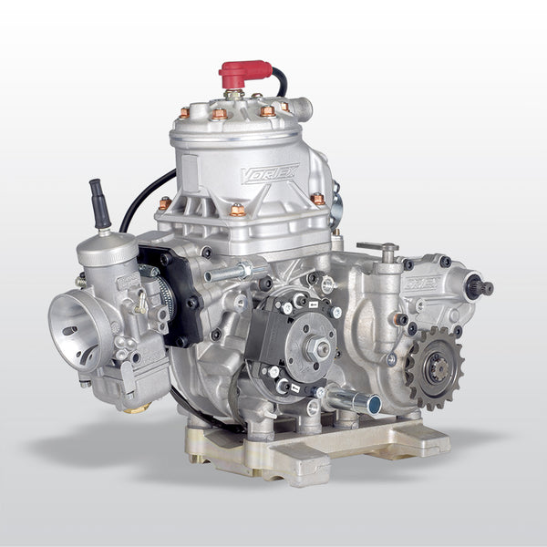

Looks like the 125 is about $1000 more than a RoK shifter?
Looks like you’d have to buy an airbox and water pump for the Rok for it to be a true price comparison. Seems like an air filter might be included with the FZ and I’m going to assume it has an in built water pump.
So the advantage has to be maintenance costs?
