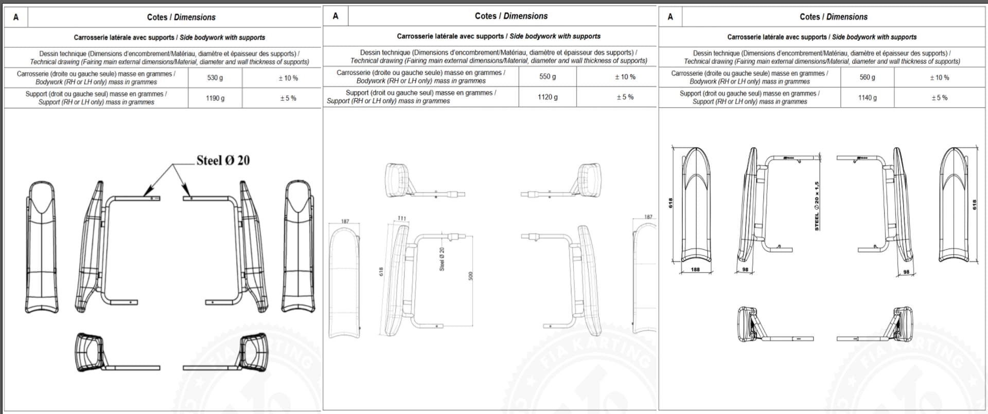

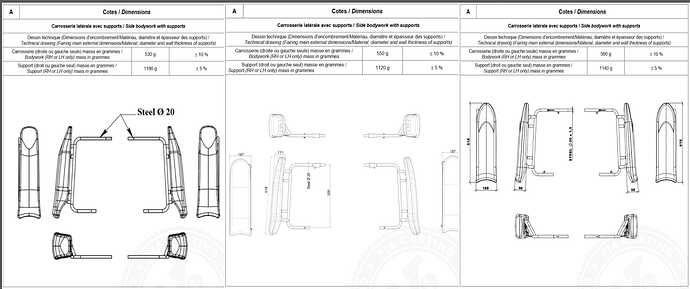

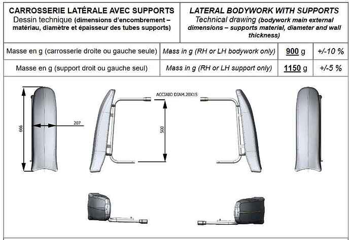

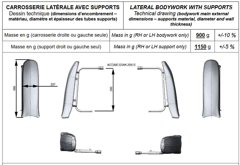

I am answering my own question. At least comparing homologation documents, the M10 OTK, KG 507, and Parolin Dynamica are all within 50g. Also, the sidepod spacing appears to be somewhat standard at 500mm on center.
Edit: The M6 bodywork is heavy! M6: 2050g (4.5lbs) vs M10: 1670g (3.6lbs). Total saving of 760g (1.7lbs). Guess who is buying sidepods this week.
Final Edit: Noses M6, M10, KG, Parolin all are within 150g. Interestingly enough the homologation documents do not list the weights of the fairings. Does anyone have a handful laying around they want to weigh?
