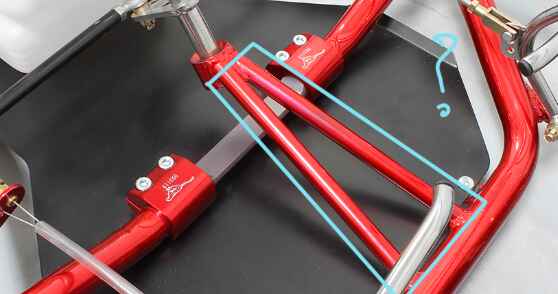

Yea that what I originally wanted but for my chassis I just can’t find anything that would work. Maybe someone here knows of something? Here is what it looks like.

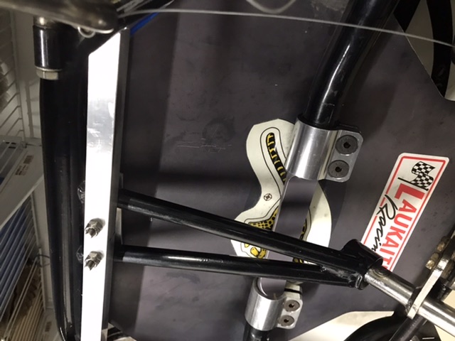

I made this one. Small steel plate in the bottom

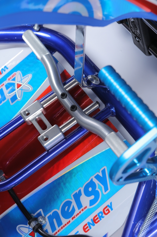

Similar to Moises’
