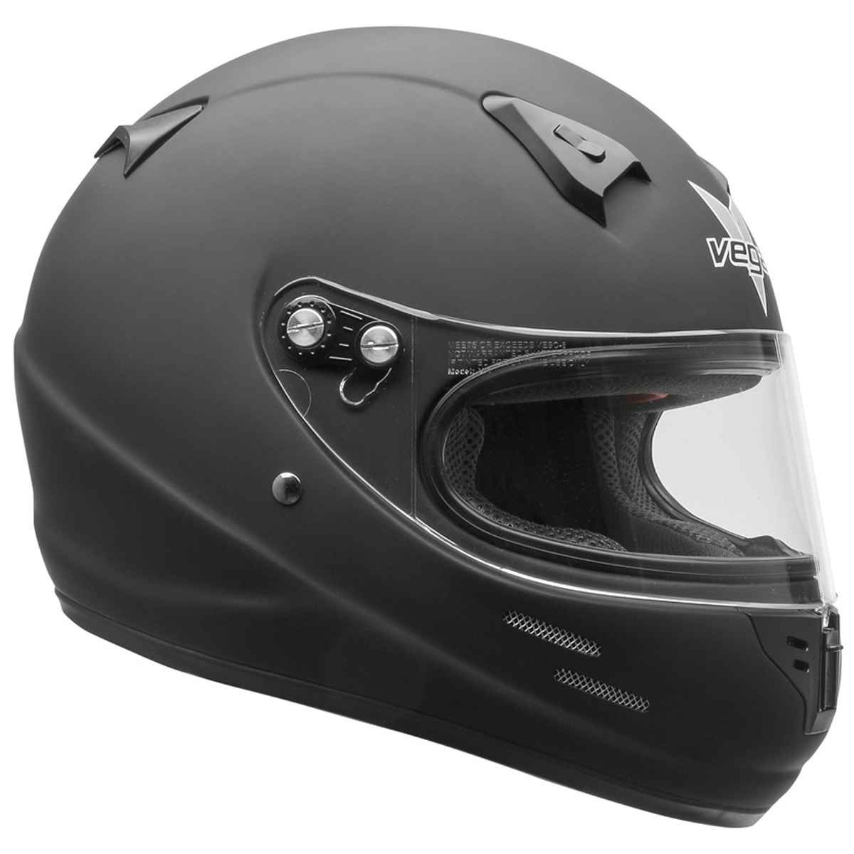

Not sure why the dislike the Vega helmet. One of the reasons I chose them for myself and my son is that they meet the Snell spec. In addition they will warranty crash damage with a free replacement helmet for up to 5 years. Removable pads are a bonus since we both sweat a lot, nice to be able to clean out the funky smell.
I agree you should buy a helmet that fits properly, but to dismiss a helmet solely because it’s not one of the big brands seems silly to me.
The general quality on the lower-end Vega helmets is pretty atrocious. From the interior materials to the shell which is very thin. Plus that sharp point on the chin always make me cringe when I think of that possibly contacting the driver’s chest.
They also have this one though, which actually isn’t too bad for a budget helmet.
Just because helmets meet the Snell spec, doesn’t mean they are all equally safe. Some helmets are designed to simply meet the requirements of each test, and some are designed to exceed the requirements. Not to mention the increase comfort, durability etc. you usually find in a more expensive helmet.

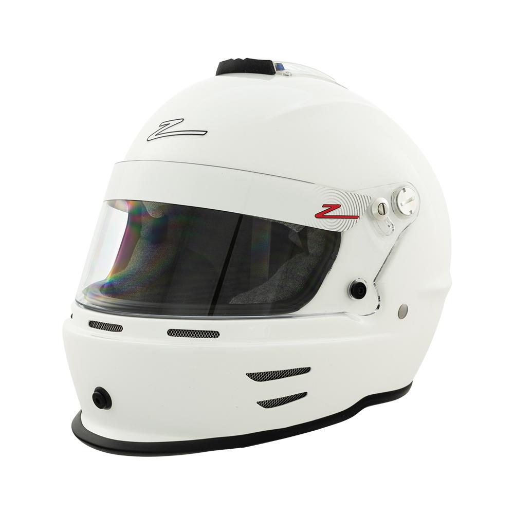

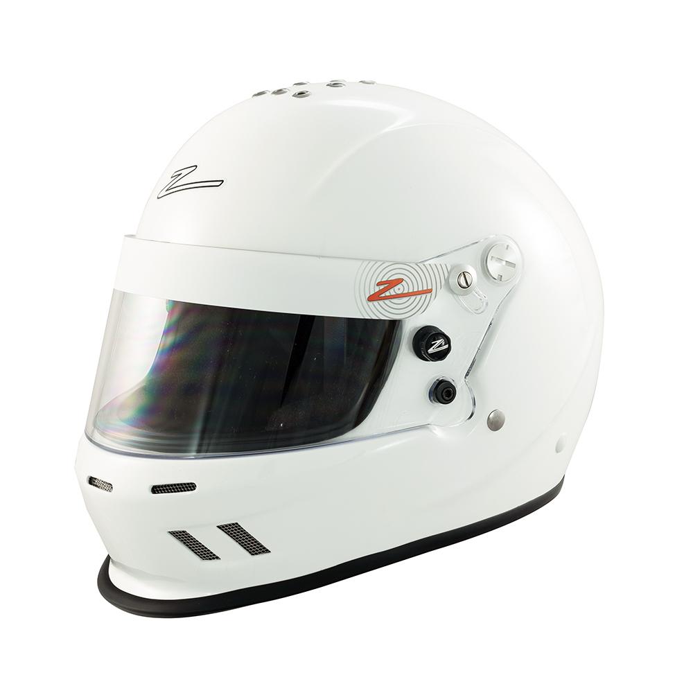

Check out Zamp helmets, their youth offerings are really great pieces. They have a RZ-42Y and the newer RZ-37Y. Much better fit than the helmets with the adult shell and tons of padding, and much lighter.
