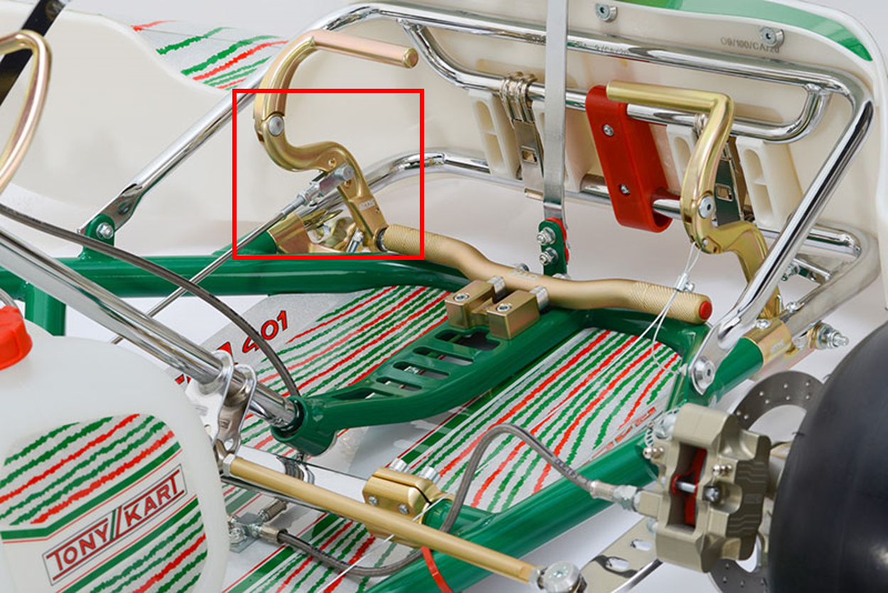

Hey Michael,
Welcome to the forums! Speaking of the long brakes, (@NikG’s comment is great for changing driving technique, but I think he might be asking about the actual engagement point of the brakes on the kart) have you tried adjusting the brake rod on the master cylinder?
If you have adjustable settings on your on your pedals, you can change the angle of your brake rod to change the fulcrum point on the brakes so they engage earlier.
See the area that’s boxed? Those notches on the brake pedal can be adjusted to change the engagement point of how far the pedal moves before it’s pulling on the rod.

So, I adjusted my brakes by moving them to the top hole on the pedal, and it feels like I lost a lot of braking power/feel. Is that due to the pedal adjustment or something else
