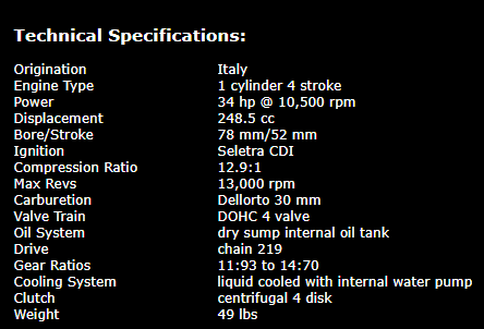

Oral OR 4TK - 34HP at 10,500 RPM

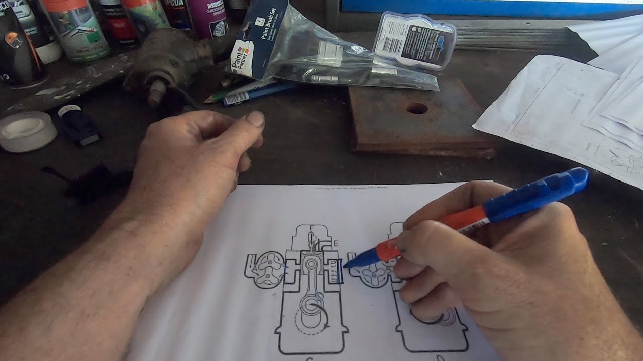

Sounds like you might be referring to the likes of the Detroit diesels, screaming jimmy etc…. Those are also two strokes. They still fire every second stroke. They just happen to have poppet valves for exhaust. The cam gear turns at at 1:1 ratio with crank. At 5:20 in this video there’s a good explanation of how poppet valve two stokes work.
Don’t get me wrong, I understand that most people associate valves as being a four stroke only thing and that two strokes can’t have a separate crankcase oil system. However the two stroke diesels have both of these.
