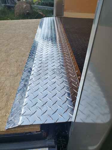

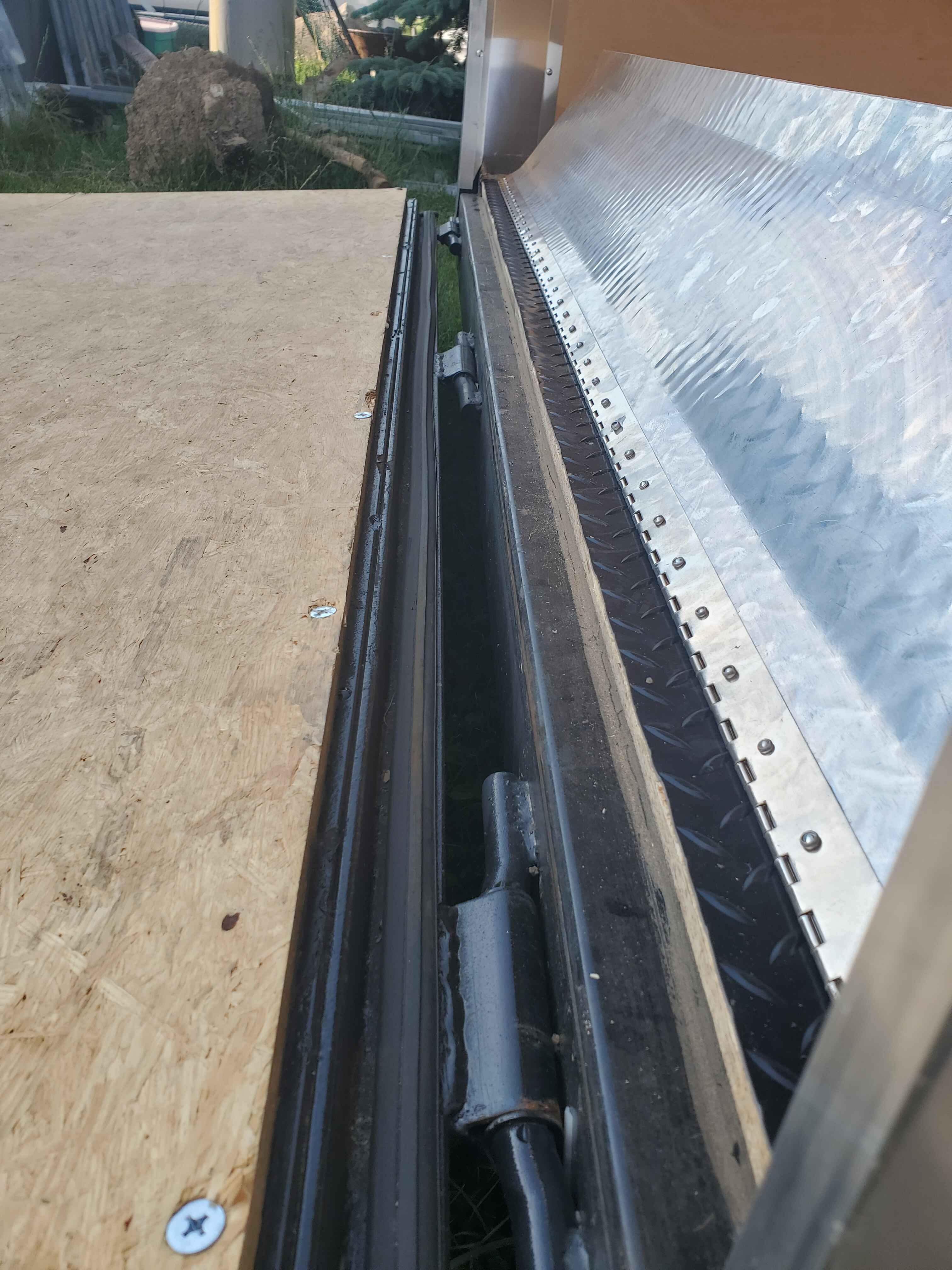

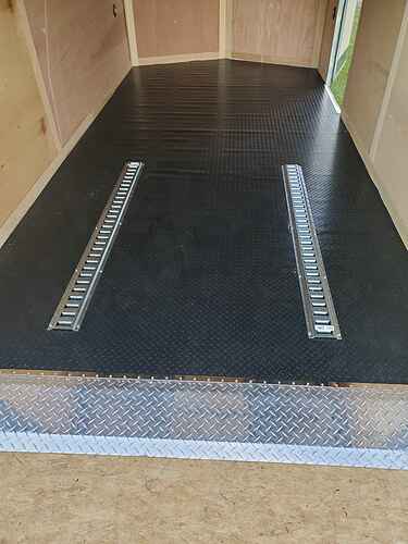

Fabbed up a transition for the ramp and bolted down some e track with my 9 year old tonight.
You fabbed it? Impressive. Looks like the 2 I bought (Another for the ground end of the ramp). Real benefit for moving heavy objects.
Well it helps that I work for a trailer manufacturer and have access to a massive hydraulic shear and brake press!
The trailer I bought came with a 12" plywood flip down transition on the end of the door, so I only needed to do the one.
So did mine, but I wasn’t going to keep it. Aluminum is more durable & stronger, so it can be thinner, making for smoother transition onto the ramp, especially with heavier objects like a loaded tool chest.
So far I haven’t had an issue with the plywood transition, but I’m also not rolling a tool chest in and out. If I find its an issue in the future, I’ll shear another piece of checker plate and put it on.
