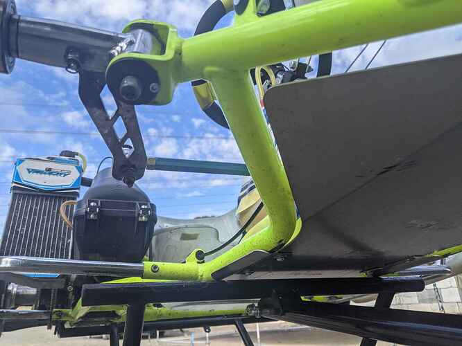

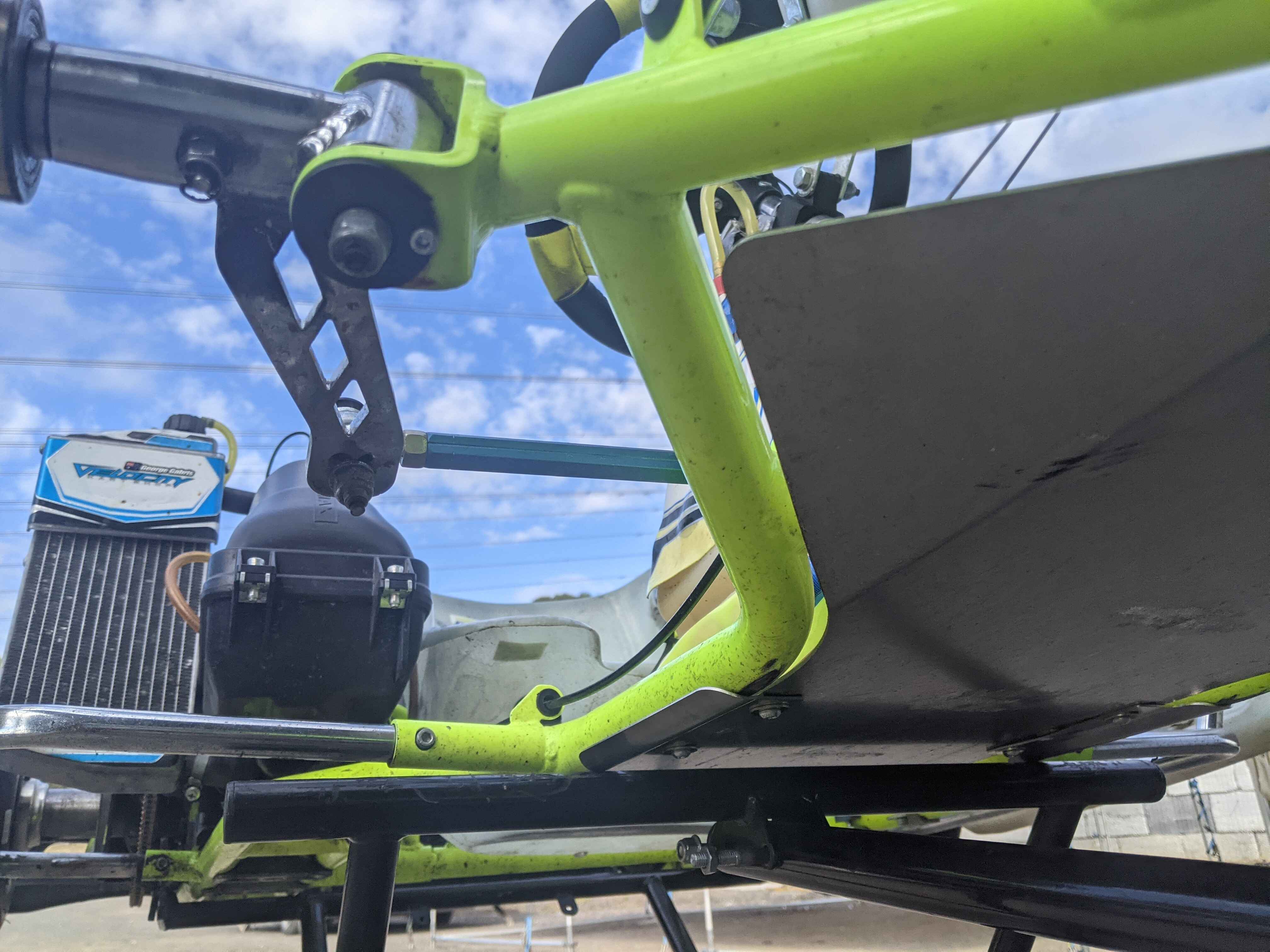

ok you guys have converted me. I had the stainless steel protectors installed on my Compkart covert 3.

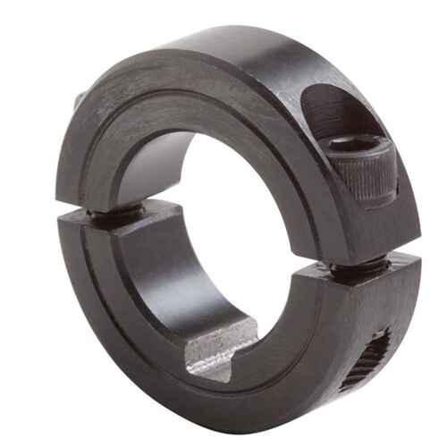

On my new kart I used lock collars like this. So far they’re working great.image
