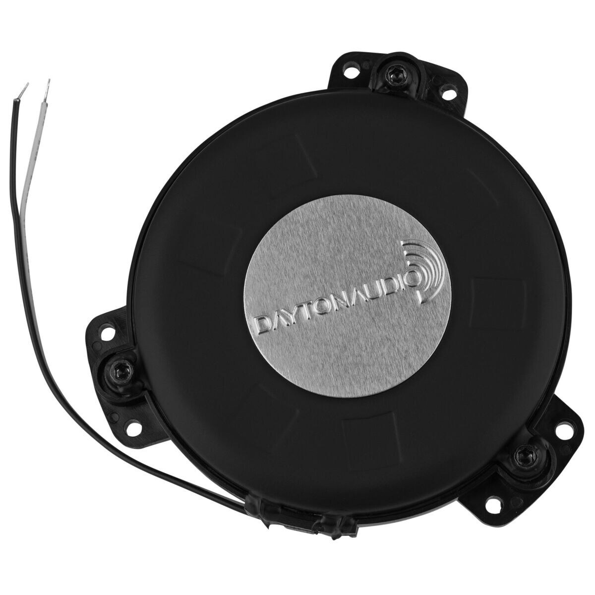

Yes. I run 4 shakers in each corner with simhub.
It is night and day, sorta. I feel wheels skid, hop, lock. I feel chassis flex.

The built in vibrators (fanatec v3) are more of a toy. This pulls the ffb data from the game specifically tethered to tire model etc. most shakers are mounted directly on pedal base.
Not knowing what was going on with the track surface and brakes used to drive me nuts. This isn’t perfect but miles better. You need to feel load and grip to drive sim. Otherwise you are guessing.
Warren bought inexpensive Chinese made amplifier. Simhub is donationware. Parts express sells kits. Dayton pucks are currently $10. I use the more expensive 45 dollar ones.

I now want another two shakers on seat. These would be for constant effects like rpm etc. I currently run 4 effects. The constant effects sort of need to be separated to be best otherwise the shaker is being asked to doo too many things simultaneously.
Since I don’t really wrench, the wood was my compromise. Ideally you’d connect somehow rigidly metal to metal. This hard wood does a decent job though. I run the amps at 50% and the effect on simhub at 50%. Way more power than I need.
These are mainly used to shake couches for movies and musicians on stage so they can feel their drums.

I don’t think I get as much out of my shakers as Dom does, but I also wouldn’t go back. I’ve got a 4-chanel shaker setup that drives the larger Dayton shakers (2 under the pedals, and one on either side of the seat mount. They make the driving more immersive and more fun, and, if the software is setup well, they can convey an additional source of feedback for sensing the limit when cornering. Also, one of the software applications I use does allow configuring the front shakers to respond to slip & lockup, but for me, the resolution was not sufficient to provide any benefit.
I’m not super into the tech and tweaking, but I’ve got multiple ‘slide’ parameters setup to trigger on different frequencies so that they vibrate at one frequency as load/slip is building in the tire, and then, when the tire starts to approach ‘the limit’, a second frequency kicks in and creates a resonance or oscillation that is easier to perceive when driving. I ended up with two main shaker presets; one for cars with ‘race tires’ and one for cars that use street tires (Skip Barber & Miata). I needed different setups for the cars on radials because they basically slide all the time, so I had to tweak settings to get the oscillation to not happen all the time.
