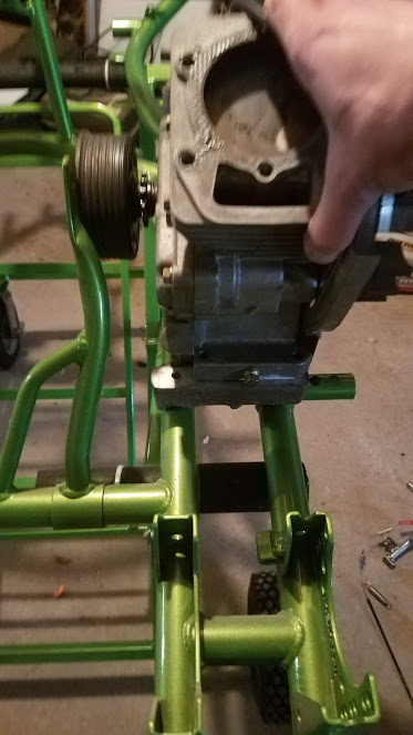

Aside from the tires, I don’t think a 4stroke is going to work. I’d need to run outboard with a lot of engine offset. Plus, this is just a drum vs disc, my disc clutch can only run inboard.
This is using an old Tecumseh F200 block for eyeballing fit up.
I’m waiting to here back from SMC for size of the Vortex and info on it be run outboard, based on their website it can be done.
Any insite? 20190119_144056 20190119_144107 20190119_144400 20190119_144409
This is a pretty common issue. There’s a few solutions.
  1. An engine mount that will allow more offset to the right (up to the point that the axle sprocket is close to the bearing carrier).
  2. Bend the seat brackets to the left to increase the gap between the engine and seat.
  3. Cut the seat bracket and re-welding elsewhere to allow more room…
Only drum clutches are allowed under the Briggs 206 ruleset.
I made an offset plate for a PCR frame mount to do the same thing. It’s the wrong spacing for the Intrepid. The Intrepid is a flat mount, I’ll need an 8 degree for tire carb clearance. Odenthal has one that could work for offset. If that SMC can run outboard…maybe it’ll go.
I’d rather not mod the seat post, if it came to that point I’d sell and start over.
We can run a disc clutch in the Kohler class, clutch engagement is set between 4500 and 5000.
Ah good point on the Kohler. Sorry, i’m so used to seeing 206 as the four stoke on a kart.
Here’s something to consider while you’re making or buying a mount, although it’s written for the 206,it pretty much applies to all OHV four stoke engines in karting.
