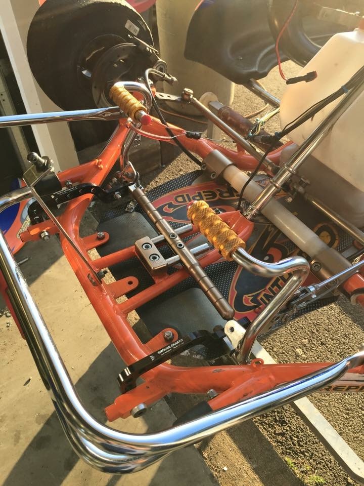

I also found that I needed to just quit trying to make the kart fit me using the factory pedal mounts. I just can’t reach them properly and trying to stretch out or hold my self in place wasn’t working for me, and I don’t feel that the bolt on pedal extenders are a good long term solution. I always joke that I need a 1010mm shifter :stuck_out_tongue:
On my old intrepid I used some Wldkart pedal mounts that bolted to the floor pan. There were two issues with them and they were both the reason I tried to not use them again: my legs were always on the tie rods, and the Intrepid/Praga floor plan is fairly narrow.
I’m also a big fan of 3D printing and attempted to design a solution. It worked ok but I just couldn’t get back far enough to make it work.
So I’ve spent part of the day installing the IPK pedal mounts on my Praga. I still need to make a new brake rod and add a throttle spring but these things are pretty nice.
I’m not joking when I say I have no legs :laughing:

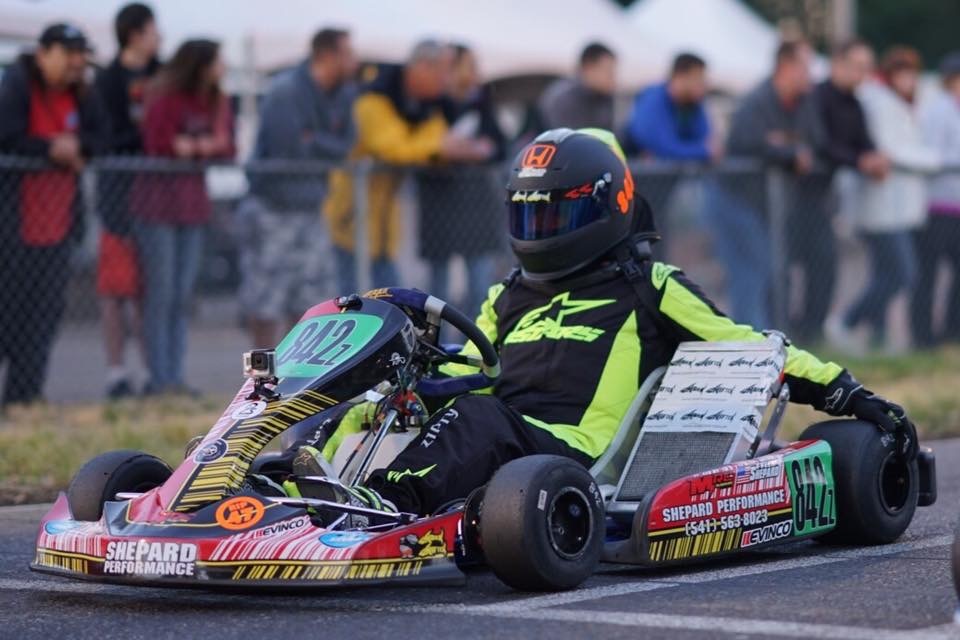

I can’t wait to see some photos of you in the kart. I’d like to see how your position has changed, since you’ve raised the seat and put those pedal risers in.
First picture is the seat mounted to factory specs. Second is raised. Notice how my feet are stretched out. Third pic is my intrepid last year. Seat is mounted to factory specs but I did have the pedals moved back.

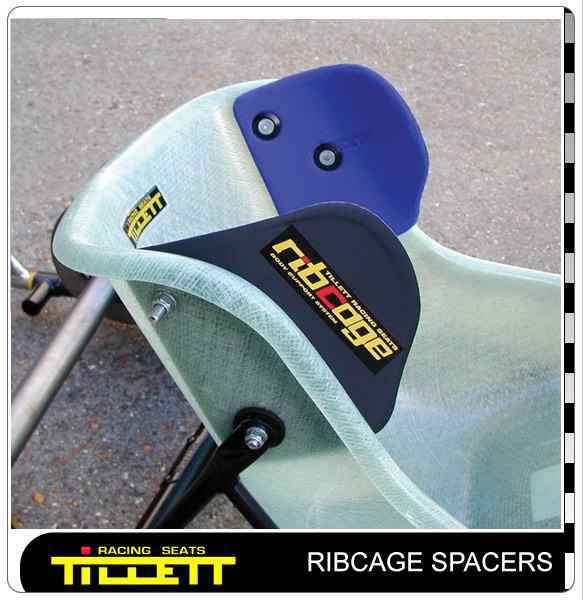

I’m having an annoying seating issue.
I like that plastic Tillet seat. I find it very comfortable and could drive on it all day. My SH has it and my Lo206 Corsa HAD it, until I gave it to my buddy so he could put it on his JollyKart TAG.
Now, I’ve bought a new fiberglass seat, sized large just like the plastic Tillet. It fits me right, but it leaves too much wiggle room for my torso, so my upper body is not supported in corners and I have to do most of the “hold in place” work using my arms and shoulders. In retrospect, perhaps that was always an issue and I just noticed that now because the seat is stiffer.
Is there any solution to this? Would padding the seat on the sides work? Anyone has any experience with this Tillet Ribcage thing?
This EKartingNews post (last post of the page) pretty much describes my issue. Ass fits well on the seat, but torso moves around. I guess it will work!
