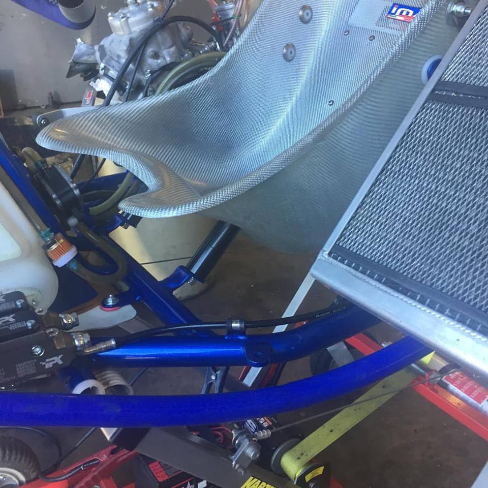

Well the issue I have with my seat is where the motor mount. I bought a birel ry30 that had a tag motor on it. This year I’m running the LO206 class and the seat strut next to the motor is right in the way. I had to trim the chain guard and shim the seat over to get away from the clutch. My seat is probably in a less than ideal position since I has to shift it over to the left but it’s what works. I feel I can make other adjustments to make up for the seat position.

As a smaller driver (5’5", 27" inseam, 165lbs), I found that the seat position in my Praga Invictus (and my old Intrepid Sirius)requires me to have the seat mounted at the top of the chassis. If its mounted down low, the kart will always stay flat in the rear as well as lose all front grip as the day gets hotter. Changes made little difference until the seat was up as well. I’ve always had to run a custom MRC steel front bar in my karts. One thing I noticed the first time I had the seat all the way up is that mid day when it got hot and grippy is that I had to put the nylon bar back in. I do have to use different pedal mounts in order to comfortably reach my feet.

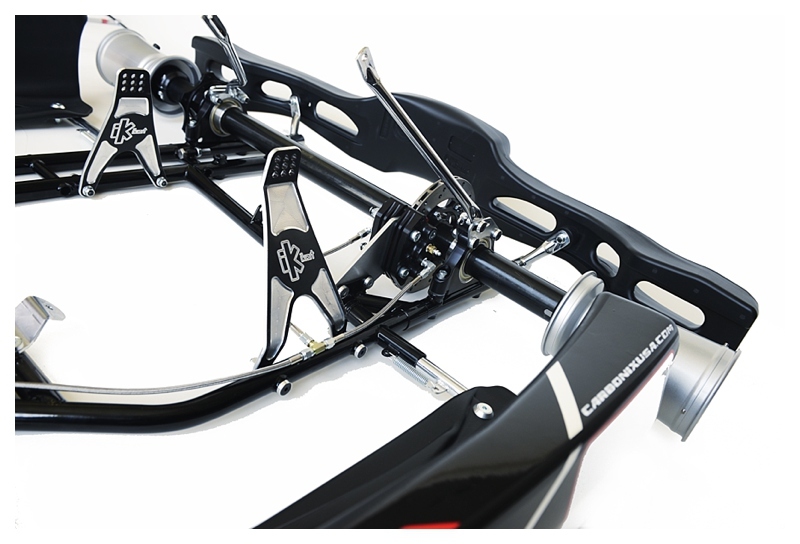

One thing that is somewhat lacking in karting is an easy way to adjust them, beyond taking them out and drilling them. Fitting a seat can be quite daunting for even the most experienced karter.
That’s a nice way of putting it. PITA more like!
I’ve seen some trick brackets that help make adjustments easier to make and more consistent. Of course, I’m having no luck finding links right now…
Here’s how iKart do it…
