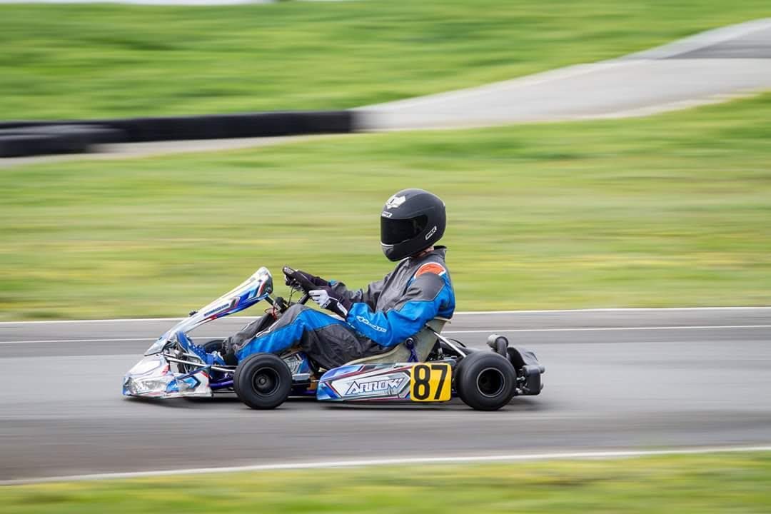

I’m in a Compkart at 6’2 188lbs. My seat is 5mm below the bottom of the rails.
With it higher up the back end hops around corners like a pogo stick.

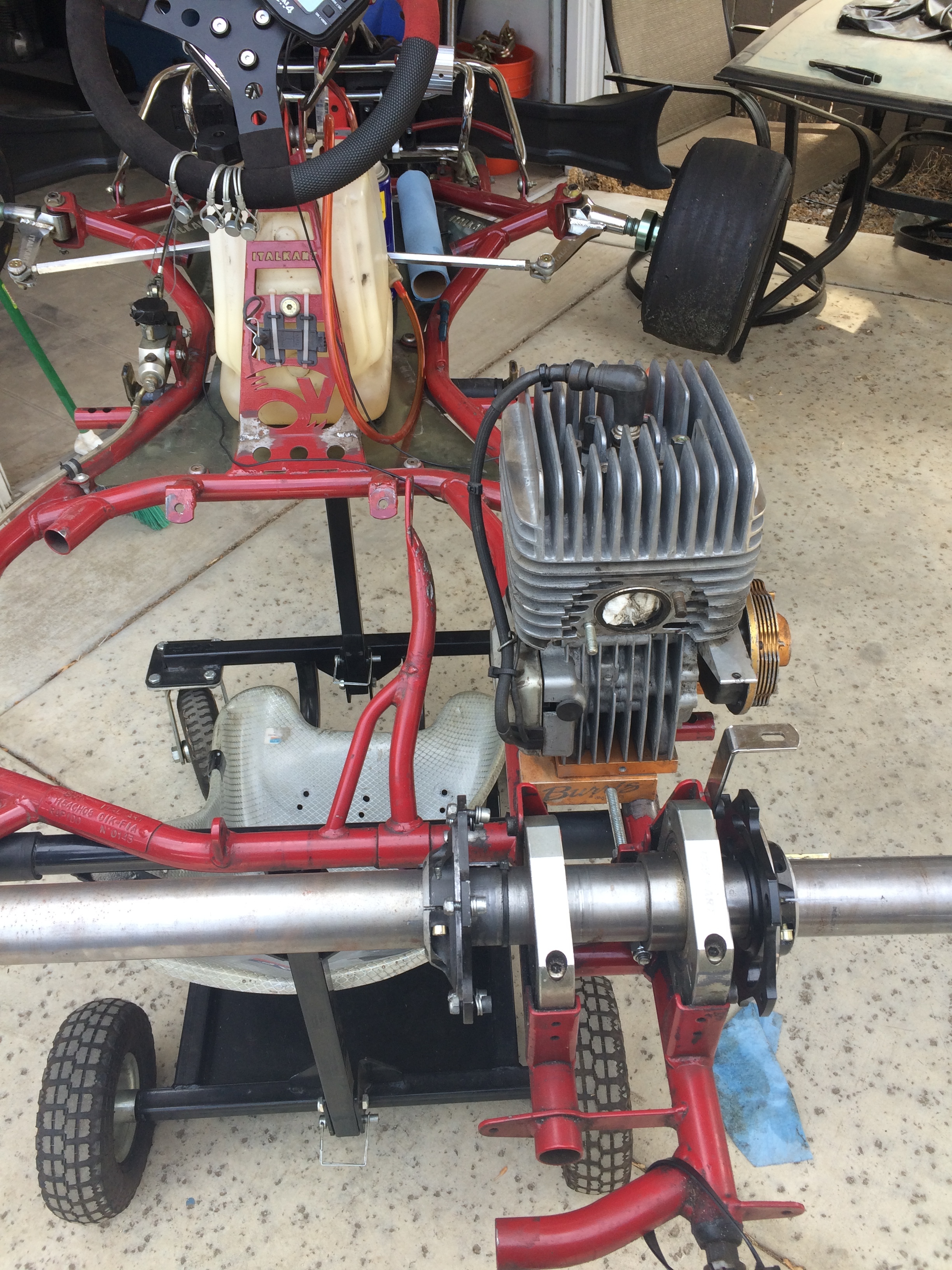

I’m going to be helping my buddy mount a smaller seat on his kart, because the bigger seat was just becoming too much of a nuisance for him. He’s also changing classes, from the inboard drive Clone to KT100. He’s also often mentioned he felt way too skewed to the left. With all this in mind, I want to bend the right seat strut over about an inch to the right to center him a bit more and help him reach the throttle pedal easier if his leg doesn’t have to bend around the tank. Doing this, though, I’ll need to bend the left strut in by about 2 inches. What is the best way to do this? I’ve never had to make such a change to a seat strut, rather just bending the tab a little in or out. IMG_3220
My gut says, scale it before you bend the brackets. Generally the seat is offset to the left as stock. Then bend them as/if needed to get the L/R balance you need.
