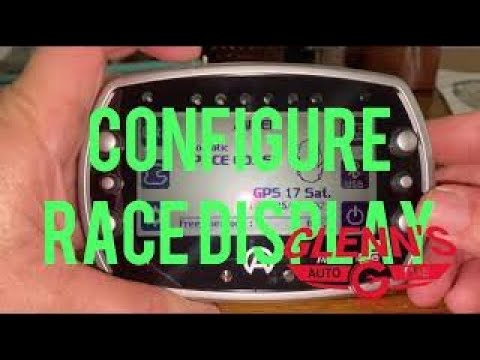

Yeah about that, this cannot be right. On my second voyage, all my sensor are new. Need to figure out why this new set up is reading so far out in left field. Everyone at the track was like, “That ain’t right.” But nobody could help me cause they’re on Micron and know nothing about Alfano . . .
What’s wrong with it?
Its meassuring EGT, but my water temp is nowhere to be found? I’m new to all this, I assume both temps would be represented.
Does it display while running?
That’s just the best lap recall. Hit ok and you can get into the data screens.
Let me do some checking. During the race, all I can remember seeing is the exhaust temps.
I’m pretty sure by default that they show both.

Was able to play with the Alfano, determined during yesterdays session the exhaust temps were in the 1,070’s and water temp maxed out at 119 degrees f.
Is that an exceptable/ safe range?
