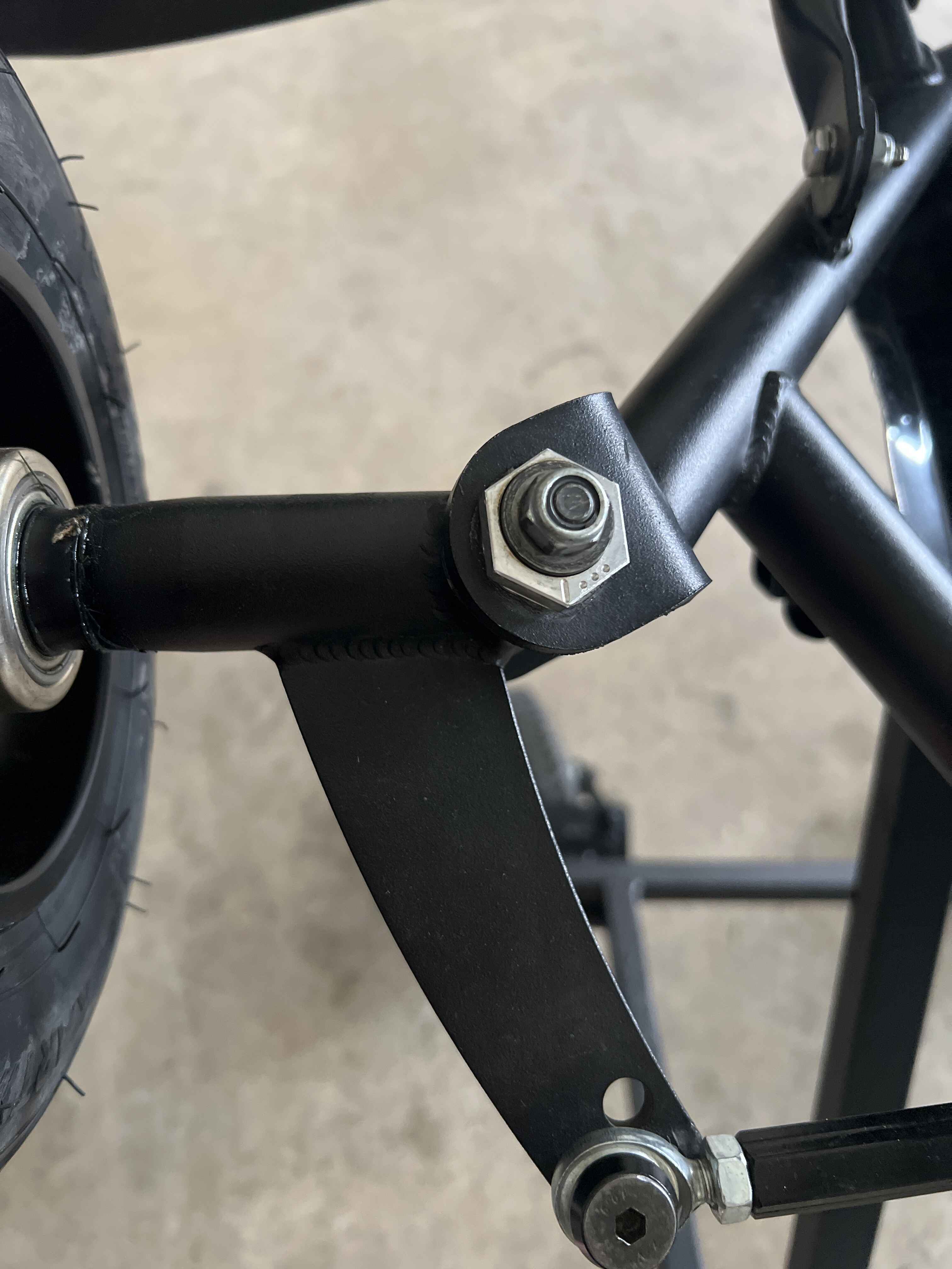

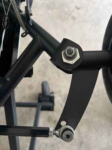

This winter I purchased a 2023 25/50 MGM out of Jacksonville Florida, it supposedly had a very neutral baseline setup on it. I took it out for our first practice recently and it was underivable, the brakes would instantly go to the floor and I would spin immediately. Then when I wouldn’t touch the brakes in an attempt to roll the corner it would step out. After that session I spoke with Paul Rice via email a few times and he advised me to add a torsion bar, new tires and up the pressure. I added the bar, new tires, bleed and shimmed the brakes, moved the rear tires in as far as the hub would allow me to and added weight over the rear axel (I’m hoping to run masters) and went back to the track Thursday. It was significantly better but still felt really loose, upon entry I would try to brake hard early and roll the corners. If I even barley turned the wheel while doing this it would lock up and spin, I then tried to trail break through the corners and when I would attempt to add throttle it would step out and spin. We race at New Castle and there was not one corner that I could take at full throttle without feeling like it was going to spin. I had to endure my 11 year old in his cadet kart (and he’s mid pack at best) making me look slow AF and he is NOT letting me live it down lol. I just want to be competitive mid pack and have fun and be safe for other drivers to be around.

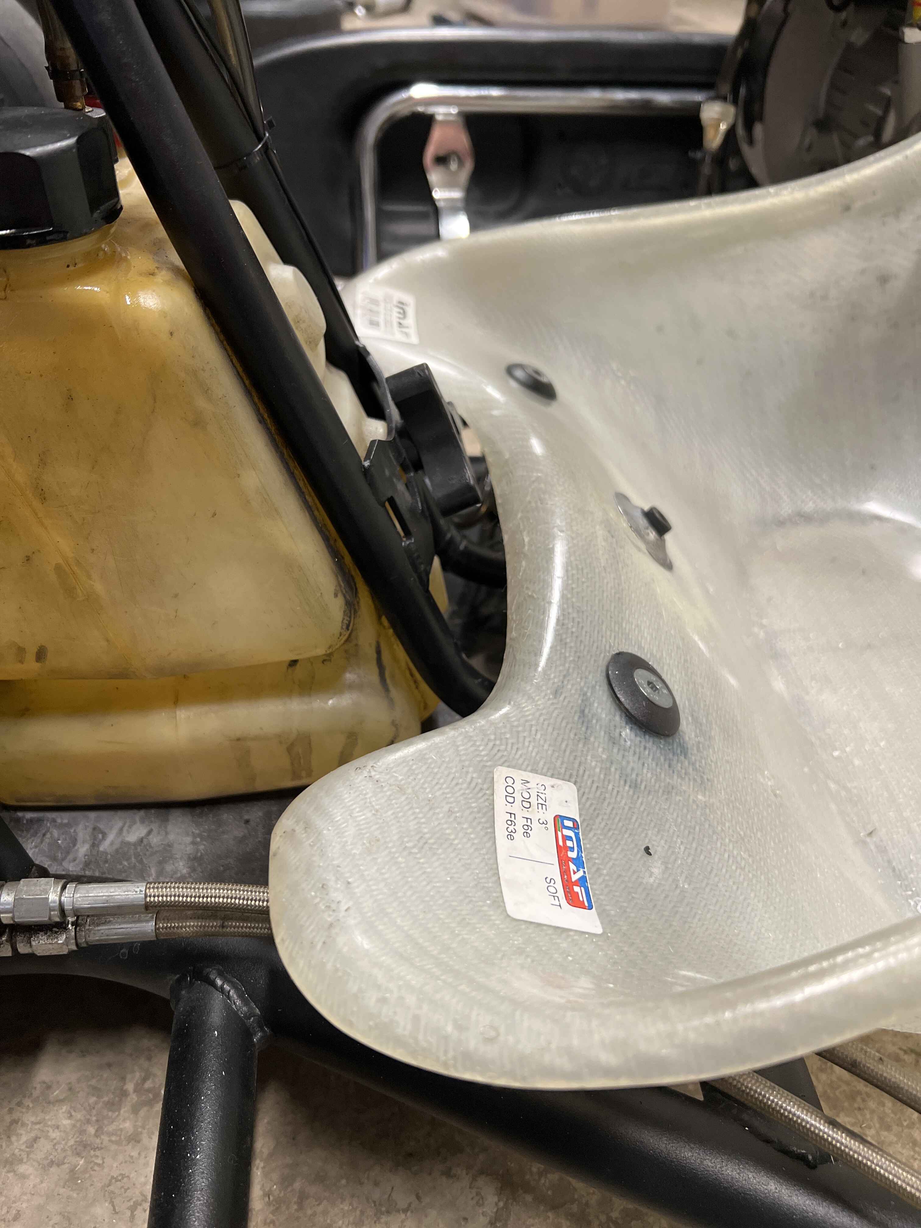

I am 6ft 210 and I’m running a iMAF size 3 soft seat
Left front pill position
Right front pill position

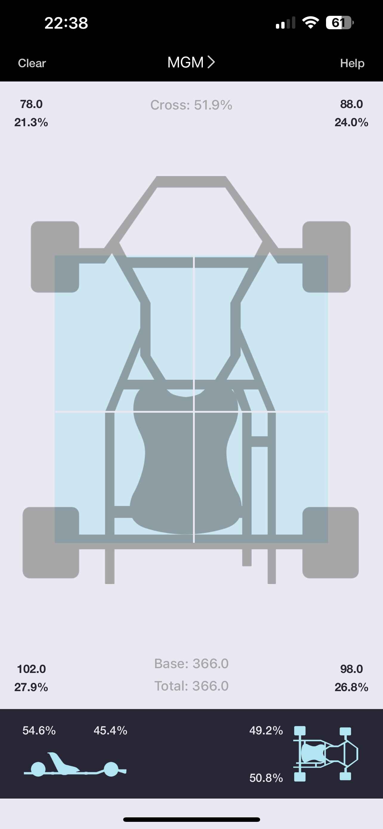

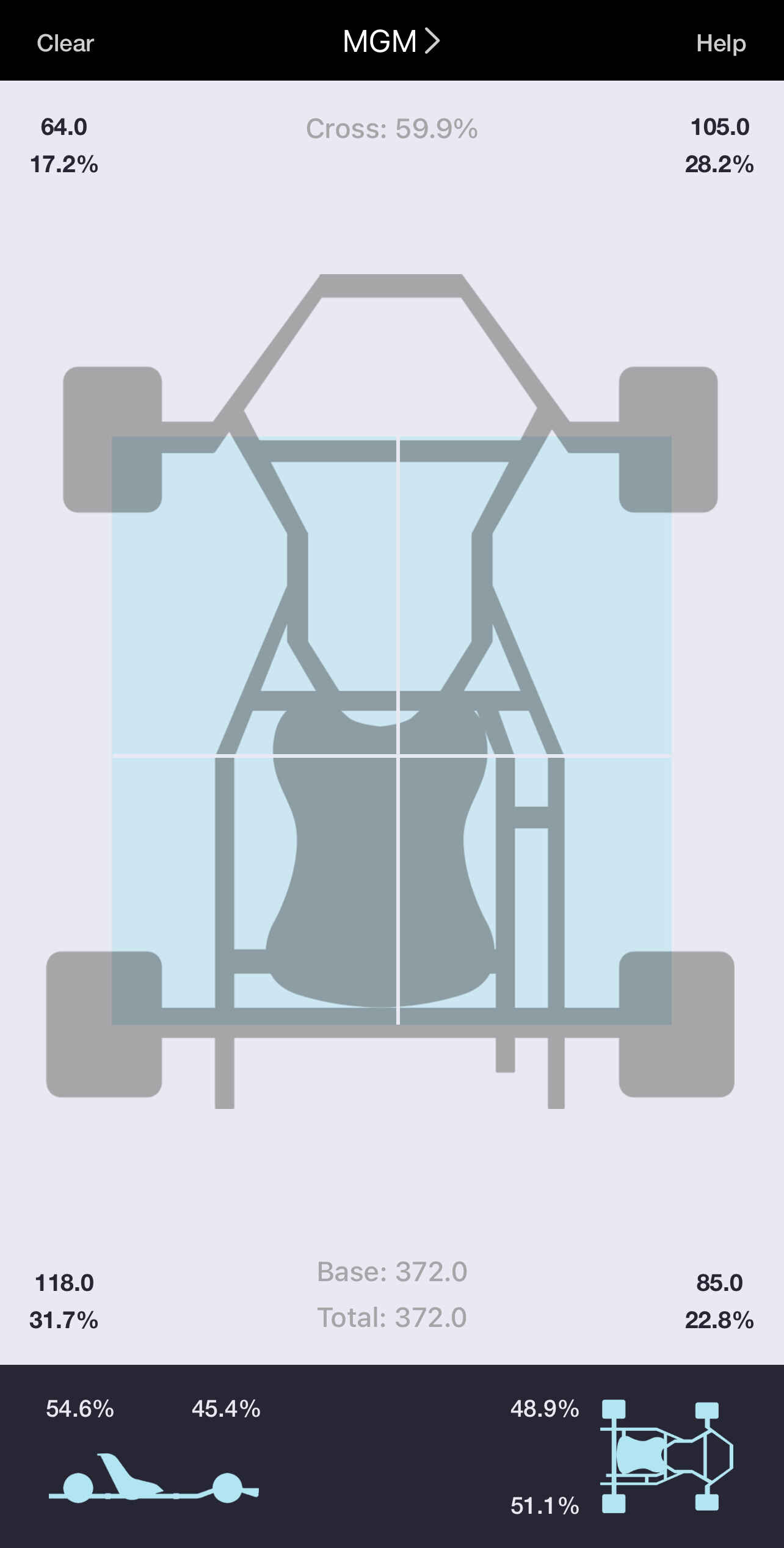

I have not, all that I have here are bathroom scales but I will get that tonight.
Here is what I got from using bathroom scales, had to add 15lbs.
Something is way out of whack. Your weights across front and rear should not be that far off.

Don is spot on. Definitely something weird going on. Definitely explains your handling problem as well

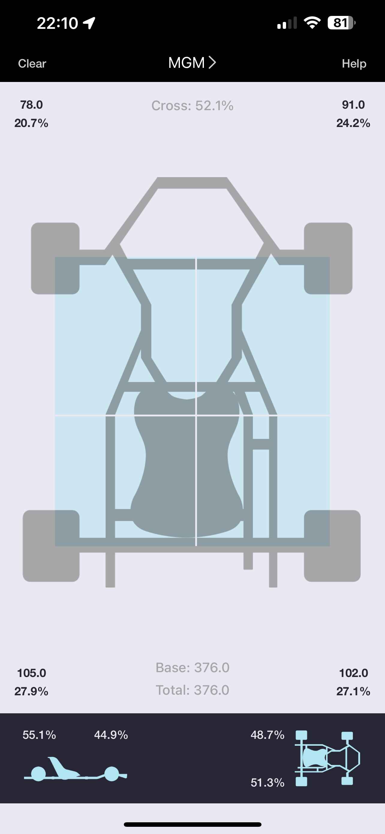

Ok verified height, set tire pressure and moved some weights around.
You’re a lot closer now. What did you change between the two scalings? Did you have 1 tire flat :wink: ?
Your kart is close enough now that it should be driveable. It is still set up to turn a little too well to the right. For NCMP, I would want cross at 49% and left at 51%. Where are your weights now?

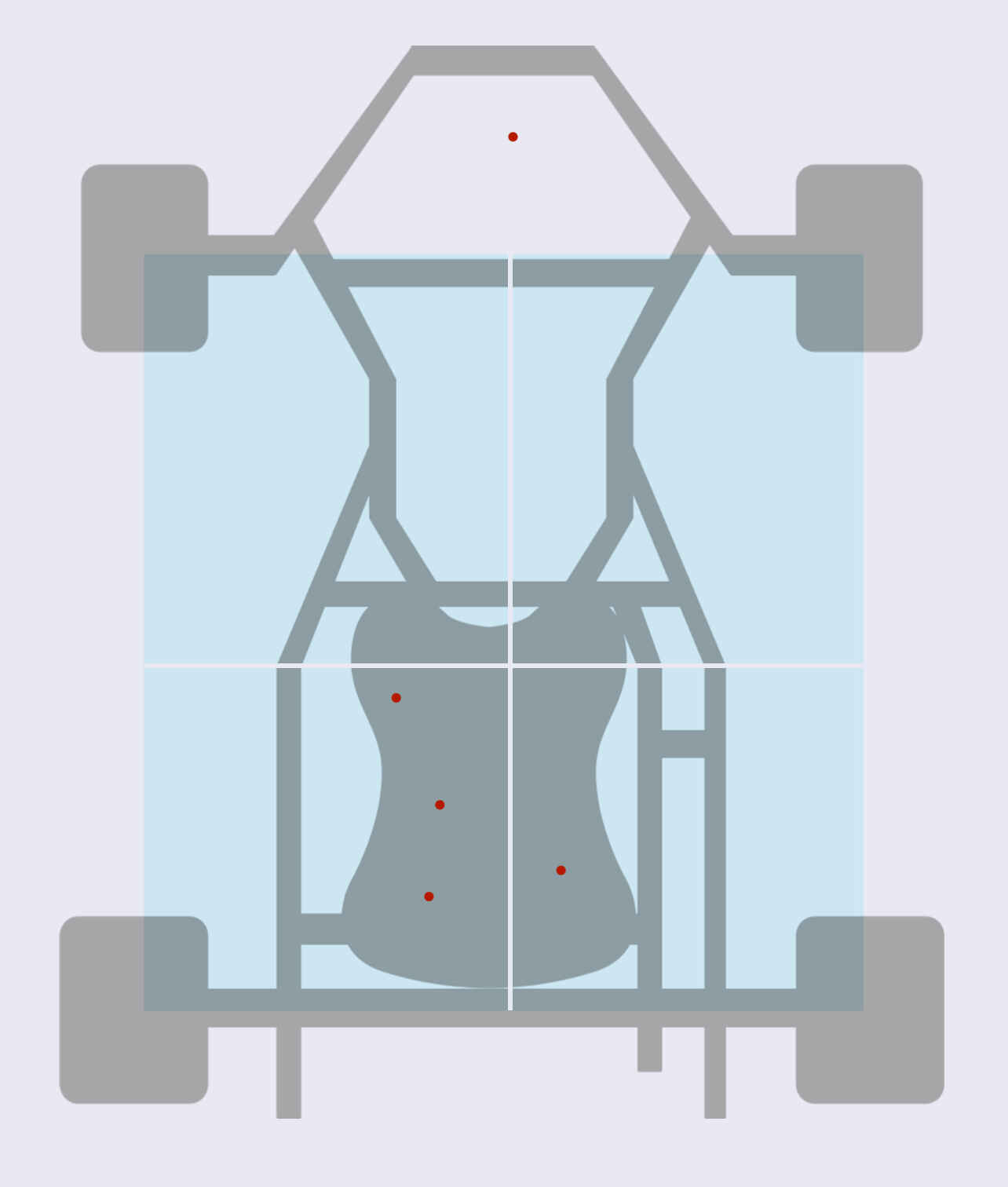

Lol damnit I was hoping no one would notice that a tire was down! Also the red dots are where I have weights located. I also have to add 5 more.
LOL, it happens. I did it once myself.
With our MGM we could find a few lbs to move cross by simply loosening the LR cassette bolts and letting it move up in the hanger a touch.
Haven’t ran a 23 but we tried to have nose 43-44%. Try putting that 5 you need to add on back of seat and under front of seat and see what it does for the nose weight %. Easy change at track and if you know before hand what it does its nice.
Ok weights have been moved.
I also feel like the seat should be moved back :man_shrugging:t3:
In every configuration you do, the LF is light. I think you should get it on a chassis table and make sure you aren’t chasing an impossible set up due to a tweaked chassis.
Was going to say the same - left front corner looks 2-3mm high at least. Not horrible but it should be noticeable.
