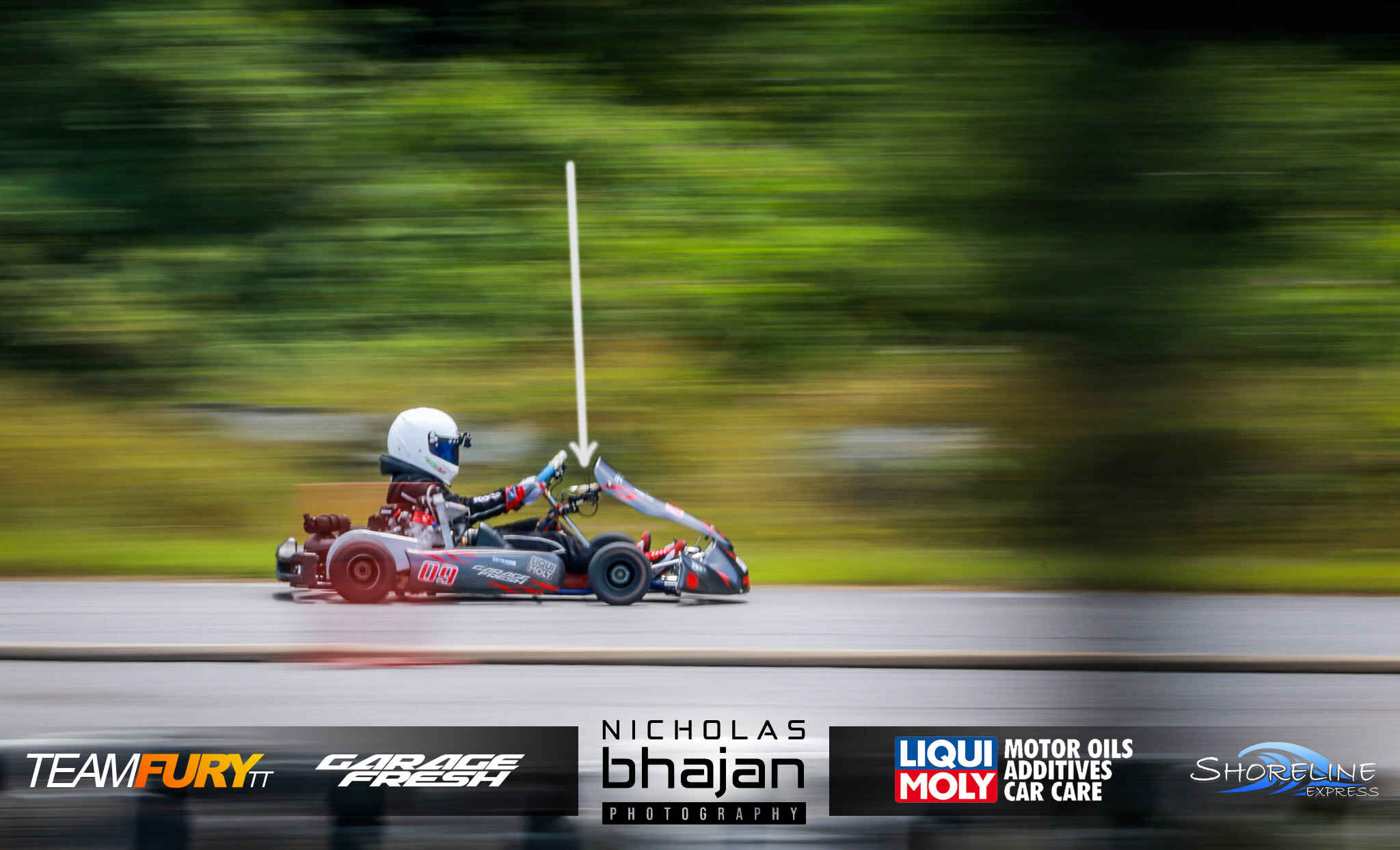

Currently my GPS module is mounted on the chrome bracket that’s between the steering column and the nose flare, see photo. Do you think an alternate placement would assist in a better reading? If not do you have any suggestions?
Also note the greenery in the back…yep that’s trees lol.

Nice pic! Generally you want to have the satellite antenna with the best view of the sky possible. Looks like you got that covered. If you’re getting 8-13 satellites with a good signal (high in the sky, not too close to the horizon) you should be fine. It’s when trees or buildings or other obstacles obscure the view of the horizon or you haven’t turned the unit on for awhile (or you moved some distance from where it was the last time it was on) that it could take some time for the GPS receiver to know where all the satellites should be. If a MC5 is getting a half meter accuracy, the WAAS processing (improved accuracy) is probably turned on. That’s something you might check on your unit. Hope all that is of some help!
