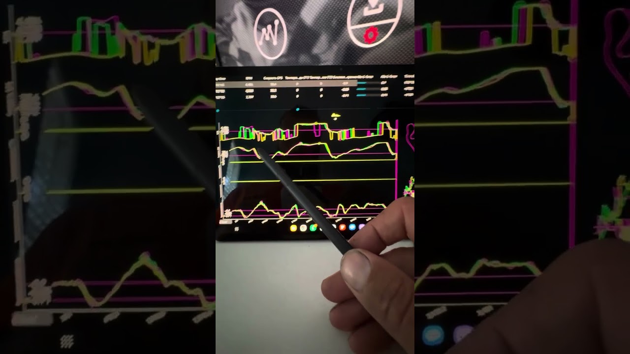

In Alfano´s you can compare different laps at the same time, even share data between other Alfano devices
Alfano, in the begining only have 1 programme (ADA). It was the same in IOS and Android and even in PC. So you can imagine how powerfull is (not less features in mobile version)
Look at this (it is Android version):
Don´t you think is powerfull in a mobile version?

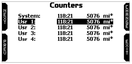

Is it possible to use a Mychron as an hourmeter, and how?

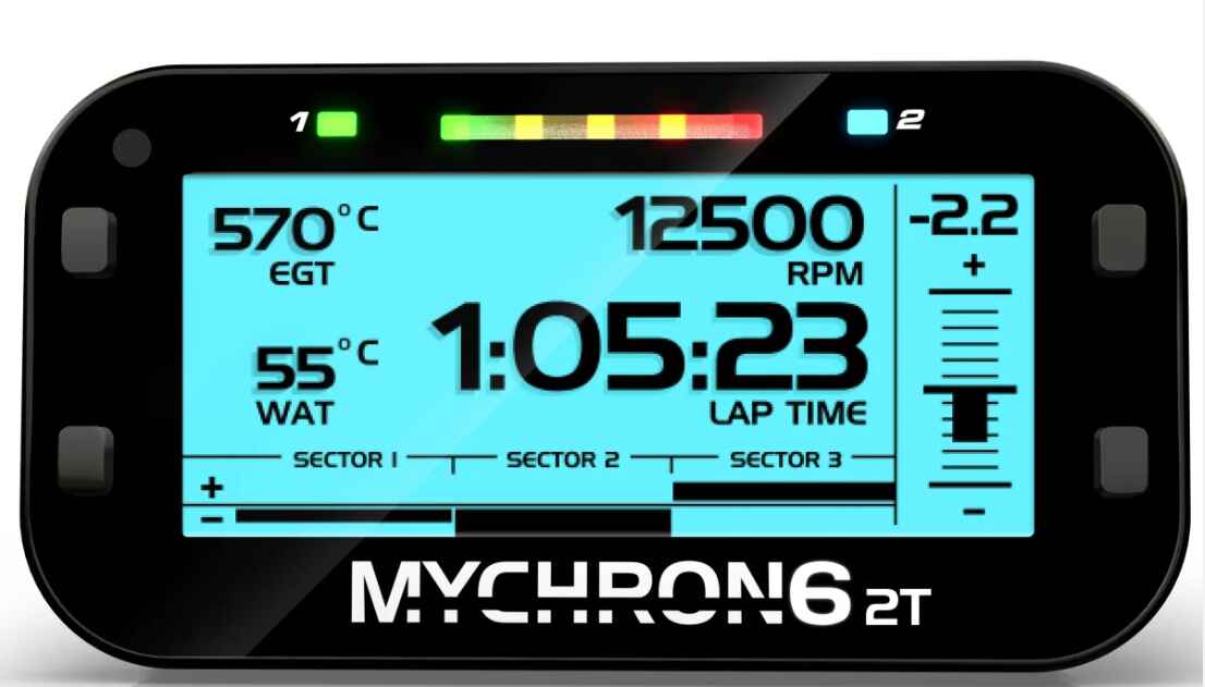

Anyone knows how to get the “sectors” down bar activated?Like in this image:
Today I was riding with a track with 3 splits (created previously in Rs3) and can´t get the sectors bar
How to get it?Ayone has tested it?

Just go to “counters” in the menu, you have 4 time/distance counters that you can enable/disable/reset and a system one which cannot be reset or stopped.

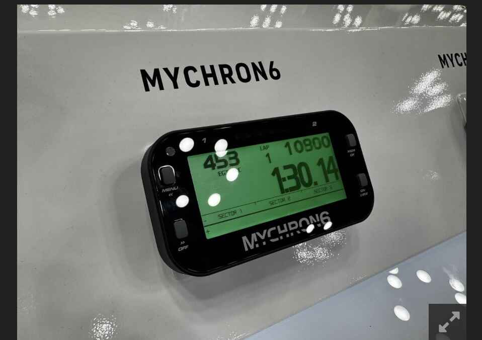

And this Matt?:
This page was shown at Pri in Aim’s stand when MC6 was introduced
So,how can be activated the lower bar?
