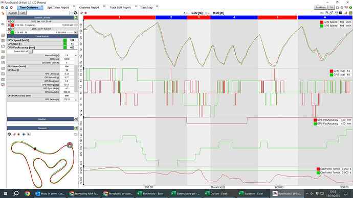

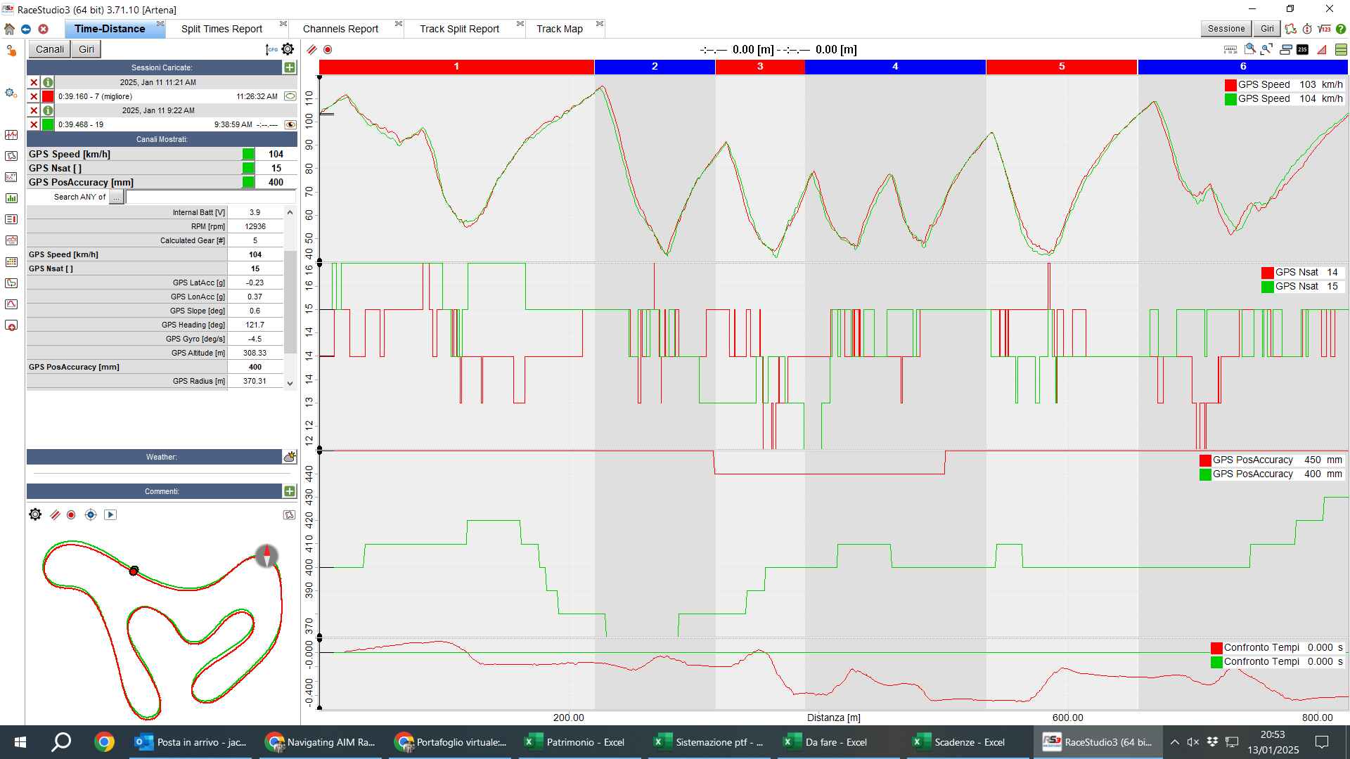

These are GPS Nsat and GPS PosAccuracy of the 2 laps, they seems different or I’m wrong?
Sorry, about that I don’t understand the point but it’s my fault. I have 2 laps, If I take one or another for reference, what’s the difference? The lines remains the same, with inverted colours, and the microsector time remains the same
What’s the GPS PosAccuracy here? It seems accurate to the millimeter, but in my case I’m not sure it is. I still don’t understand how a faster line (in km/h terms) in every moment of the sector can be slower by 2 tenths. My GPS PosAccuracy in the microsector is 400mm for one lap and 450mm for the other, so it may be a 40cm of imprecision, they are lot
The accuracy on both of those sessions is very good.

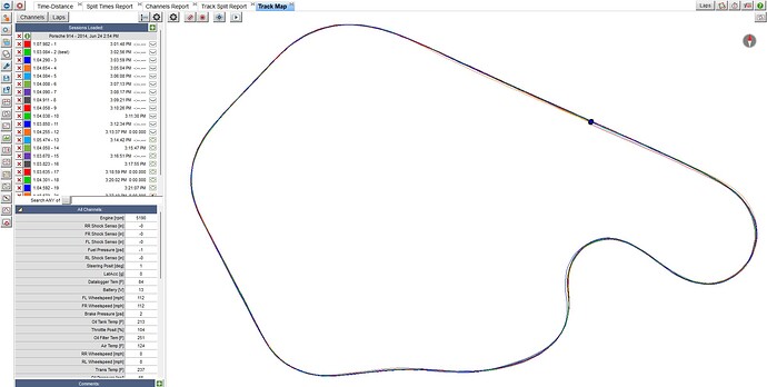

I think we need to backup a little bit. Time slip or time compare has been around a lot longer than GPS. It was originally calculated from wheel speeds, which gave us lap distance by integration. To make a quick summary from Jorge Seger’s book “Analysis Techniques for Racecar Data Acquisition” (a great book btw), the basics of time compare is the sum of difference in speed at each point along the track as a percentage. Note that there is nothing here about position in the world, it’s only lap distance which you will find to be very accurate on an M5S. My friend Samir does a nice job explaining this a little deeper, but not too deep, if you want a read Introduction to Motorsport Data Analysis: Delta-t I believe Chris Brown has it in “Making Sense of Squiggly Lines” as well.

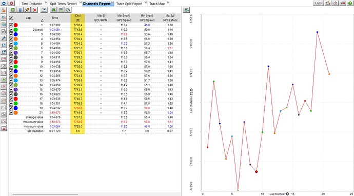

So, it’s important to remember that the lap distance is what is important and you can see the lap distances you drove in the channels report. I’ll post the graph of lap distances along with the channel report showing them. You can see that I was within 27’ in lap distance from the shortest lap to the longest.
Offset in the data does not change the accuracy of the data. The distance from S/F is what is important and that is very good provided good GPS reception. I’ll take a look at Jacopo’s data tonight or tomorrow and repot back.

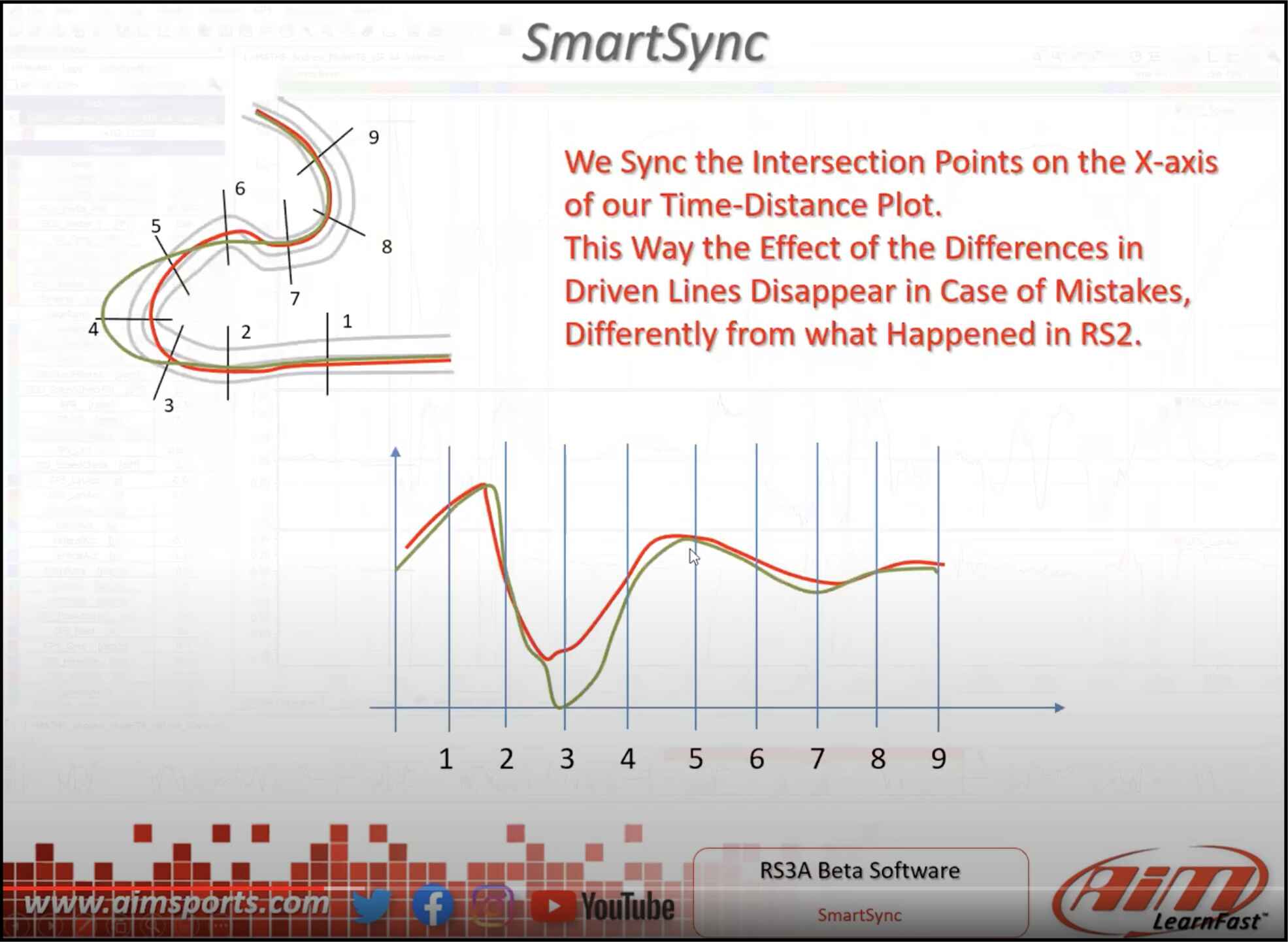

My understanding is AIM has a reference racing line (shown in grey on the middle of the track in the photo above) for each track. They use this reference line to sync the two laps together by projecting an intersection point to the driven line at a fixed frequency. In their examples it’s 1, 2, 3, 4, etc… Looking at points 3 and 4 in their example, I believe they will take the distance traveled between them for the two laps and using this and speed, and other factors, come up with a delta time.
To me it seems if your GPS data is offset (not talking about just S/F line offsets, but overall lat/long offsets like mine and Jacopo’s data shows), then the calculated distance will be different at each point in time during the corner and thus lead to inaccuracies in the time compare.
The overall distance traveled for each lap will be similar because the GPS offsets would be averaged out across the whole lap, so I’m not saying the lap distances are incorrect, they are just locally (in that particular corner) incorrect.

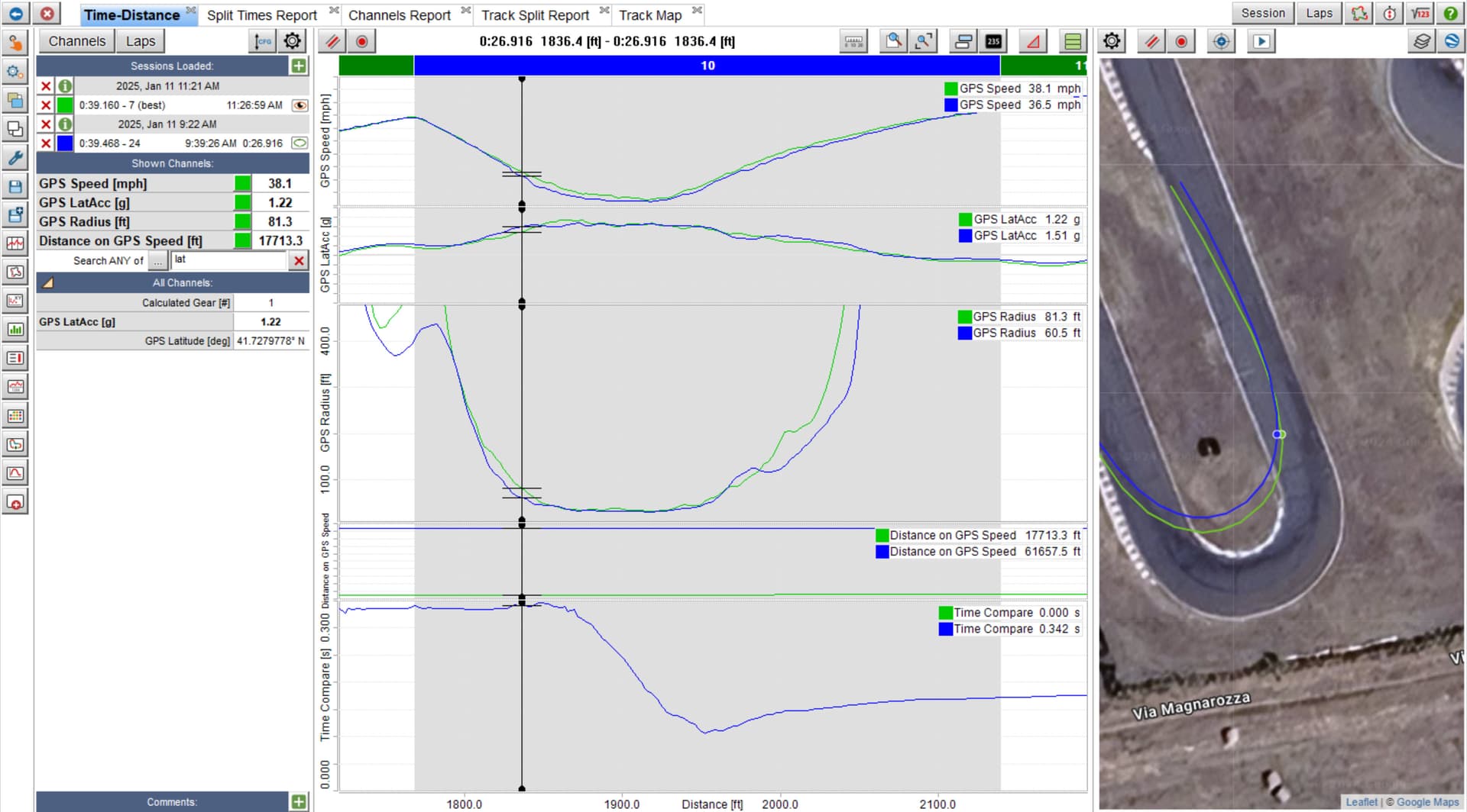

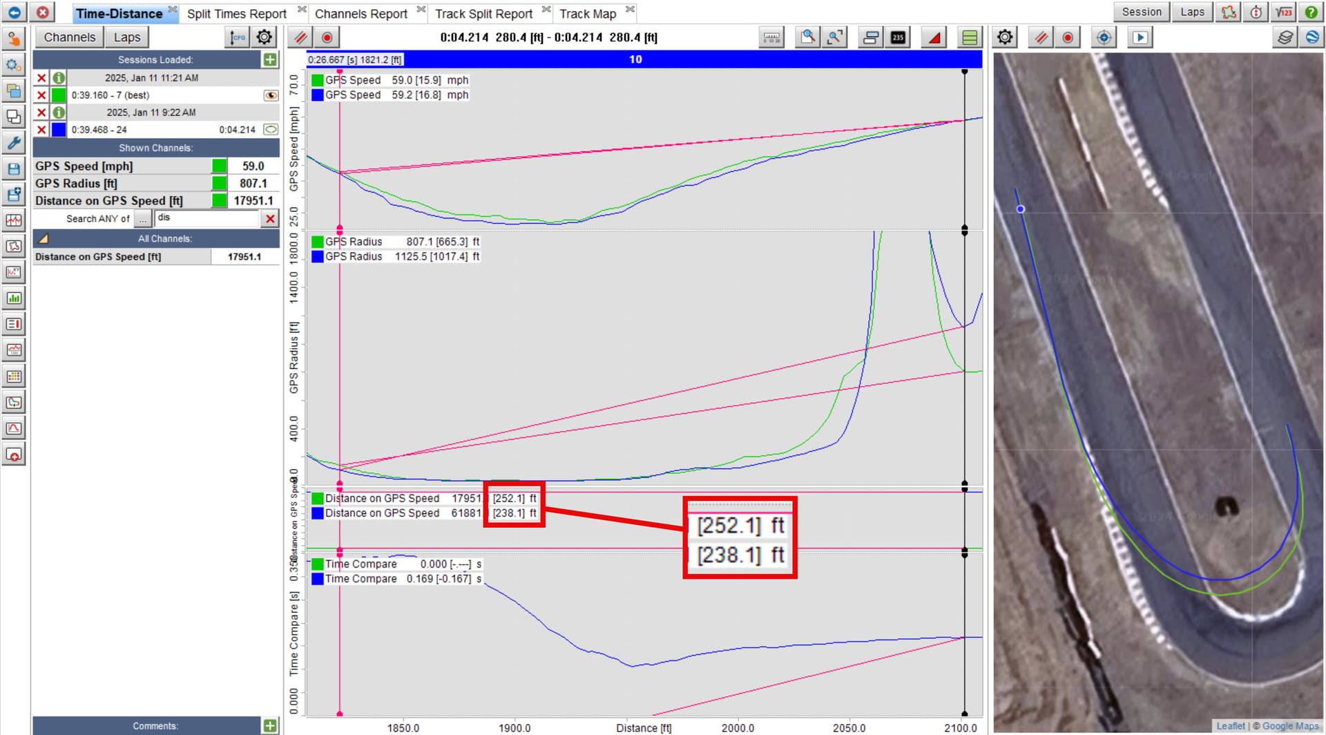

Here is what I see. You drove a different line in that corner that was roughly 6% of the corner corner length. You can see that it was different in the lap distance, GPS radius, and lat G plots (lat G was higher with a slower speed = tighter radius). The blue lap loses time on the entry and it loses it through the whole corner.
The GPS is measuring 25 times per second (25 Hz) and then calculating the speed based off the distance change and the time. It is not using the line for that.
Still lurking, still enjoying the conversations. Fwiw, based on this thread I was inspired to start dinking around with RS 3 Analysis today. (loosening my grip on RS2)
I’m seeing the blue gains time during the entire corner not losing it according to the time compare? That’s despite running a lower apex speed, exit speed and tighter exit than the green line.
Thanks Matt, so you confirm that is possible that in this lap I did a very tight line that give me lot time advantage (almost 2 tenths in one corner is incredible) despite having slower speed for the whole time. I’m honest, this sound very strange because this is my home track, I have maybe 1000 laps around it and I’m pretty sure I didn’t do something special in that lap; plus, the inner kerb is so high and not usable. I went to see ALL my records in RS3 and my best time in this sector is only 0.028 faster than the blue lap, but with new tires and more grip (think about that the faster lap was 7 tenths faster than the blue one).
