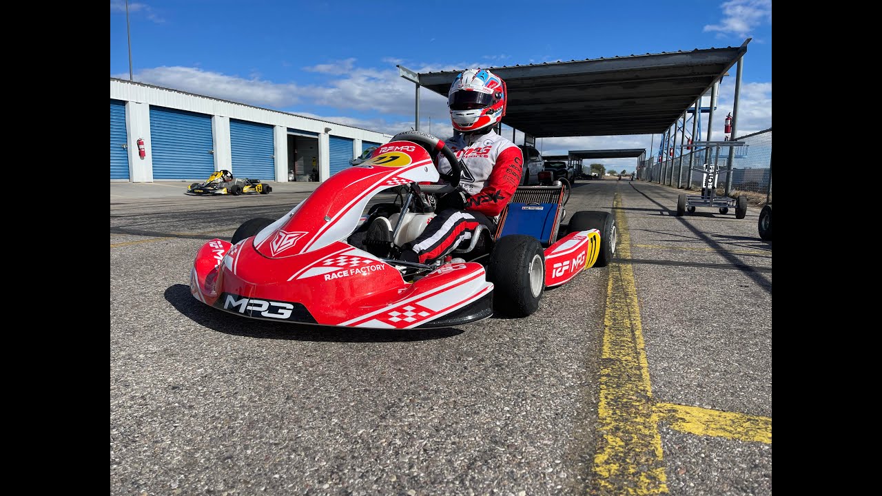

Another team testing OK-N
Chase Jones with MPG/Race Factory

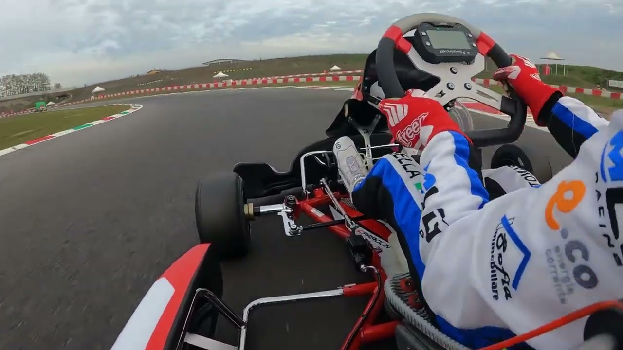

as expected. Looks pretty good until … that rev limit hits :grimacing::grimacing:
Doesn’t seem super well geared tbh…
P.S Still checking for your DM request, i revert ASAP.
EDIT:
No limiter here :grimacing:
By the age of the kid, i believe the engine is in the Junior variant here.
Agreed on gearing. Not surprising given the title of the video is “first ever laps”.
