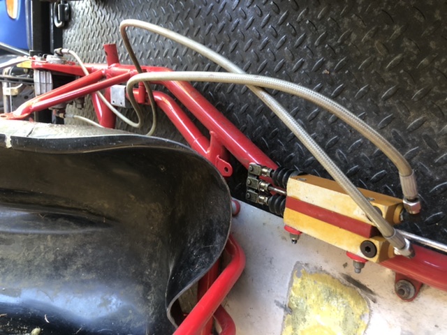

I’d start with the brakes. As Dom mentioned it’s looks in good shape, but bleeding the system or even taking it apart to check the seal and do a good cleaning is a fine place to start.
Check the axle bearings, does the axle spin freely without noise?

With regard to the brakes, what type of fluid is typically used? I have some Motul RBF600 and wondering if that will work.

Brake fluid, most likely it’s got DOT 3/4 glygol in there, in which case RBF600 would be fine to flush with as it is the same.
I would verify what type is in there first, just in case someone converted the system at some point:

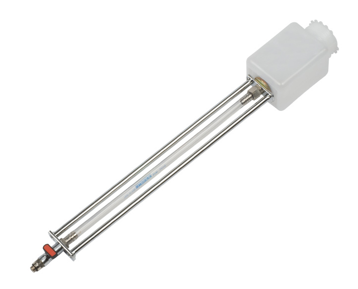

As far as current fluid it seems to be dry. I assume the two Allen bolts on top are for the fluid???
Generally yep. The hex bolt unscrews and you use a gravity feeder thing to bleed. The rubber bits may be suspect given the age of kart. Also, don’t use the wrong fluid or bad things happen, as James mentioned. On my brake system, there’s a cap you have to unscrew on caliper so the fluid that’s being pushed can leave the system (and make a slick mess). Use a catch can or something. I’ve always used the compkart one but I am assuming (probably incorrectly) that the hex bolt on master cylinder is the same across brakes.

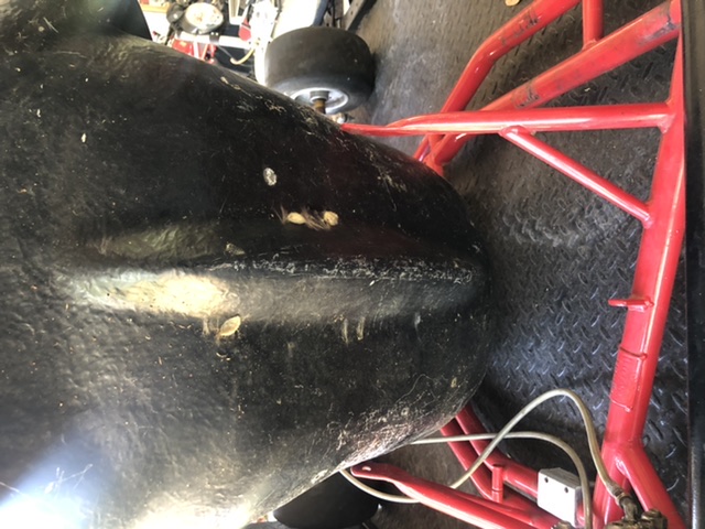

How does your boy fit in the seat? If he’s swimming in it, he could mess up his ribs.
Thanks Dom. I have some reservations about the seat as well. Doesn’t seem to be a good fit for the kart. Not sure why my pics continue to upload sideways.
So it should be snug with a rib protector on. He should feel like he’s being held in a bit from waist down and he should have just enough room such that the rib vest is making contact but he’s not squeezed. If he’s loose in the seat and he’s hitting kerbs right,left,right, it’s an issue. He’ll be pulling 1.5-2.5 G’s every 5 seconds and being thrown against the edge of the seat (if there’s too much play).
The seat looks like some kind of rental kart seat, definitely not what I would want to be using with that headrest in back. Make sure you get your son fitted properly for a new seat so he is comfortable and snug like Dom mentioned.

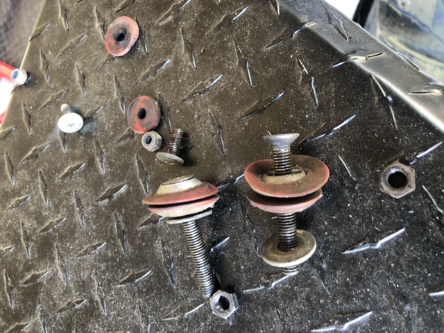

Not sure why the back bumper needs bushing like these but we just removed it to clean it up and figured I might as well buy new ones.
