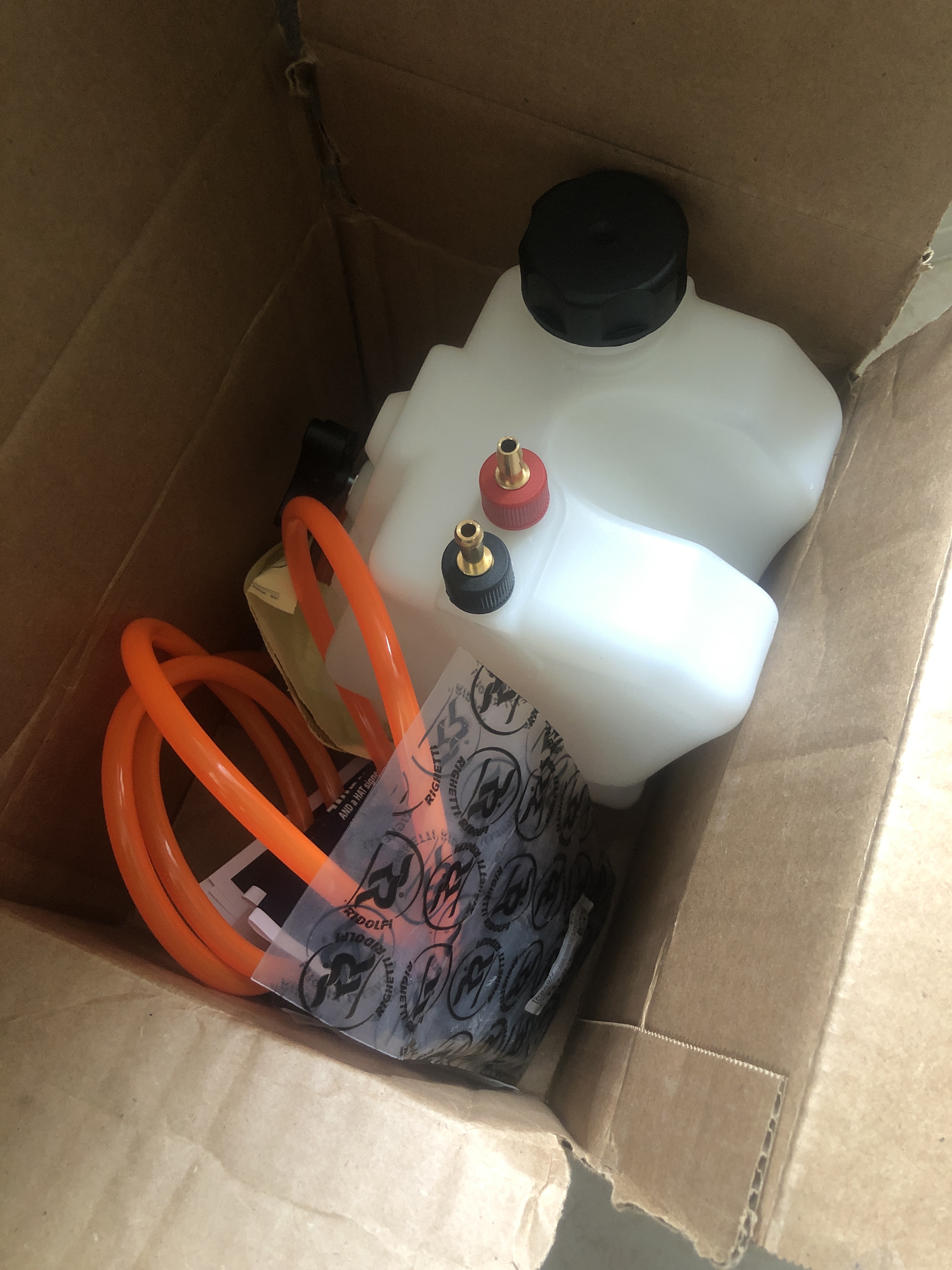

The fuel tank, line, and filter arrived today. We’ll get those on this weekend in preparation for the engine. Leaving the big ticket item for later on.

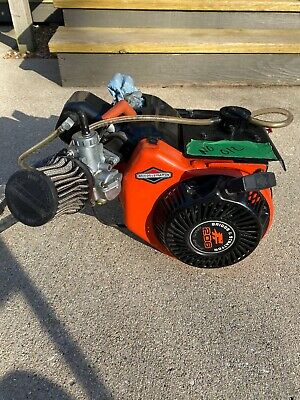

We’re getting ready to buy the engine and came across this listing on eBay. It’s the animal version and has some of the extras on it already so wanted to see what you thought. Is it worth it to go this route or should we just opt for a new LO 206? As always thanks.
Technically all 206s are Animals. The difference is that the 206 is sealed and prettymuch stock. So the 206 is a specific version of the animal if you will.
So that’s a 206 for sale. If you look closely you can see a small black wire wound in the cable of the seal. This is good as it means it’s got the legal seal. Earlier version without this black wire are not legal, but they may be allowed depending on club\series.
At $500 landed to your door, I think the price might be a bit high. Brand new 206 without ancillaries like the one in the listing runs about $600+shipping. You’ll have to factor in the cost of a mount, clutch and chain guard as well.

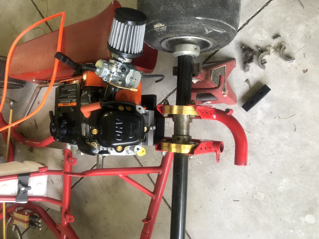

Mocking up the engine. I have it sitting as far back as it can go. Not sure how the chain and sprocket alignment should work out. I have my son googling. Lol. I thought I got everything but looks like I still need the chain and sprocket.
Yep you’ll need to offset the engine to the right as you look at the kart from the rear. You mount may have predrilled holes for this.
It can be a tight fit between the middle bearing carrier and you axle sprocket, but it should work. You’ll have to probably reverse the bolts on the carrier though.
