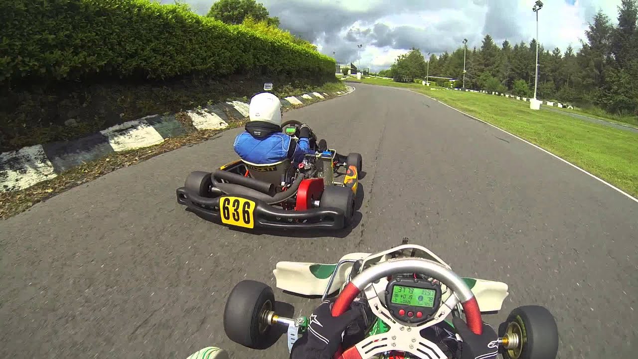

Ireland is a hotbed for rallying. There’s also more kart tracks than showing on that map though. Seven off the top of my head.
For a place half the size of MN and a population under 6m… that’s not too bad.
Here’s some samples
