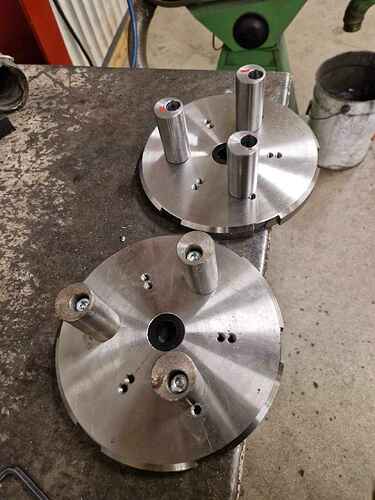

I’m in the process of disassembling my PCR TSL98, very fun! Gathers lots of experience along the way🙌🏻
You have the equipment for bottom end rebuilds?
Semantics from me here, but the head looks like a TSL 95?
Yes, I own a press and a jig for disassembly. Copper hammer and a jig to press it all together, a jig that is adjustable and works for most cranks👍🏻
Jig to check runout, basically all you need :grin:
Sweet stuff, yeah you are right!
After some digging it is a 95, weird since the previous owner told me it was 98 :flushed:
Do a rebuild video sometime! I bet there’s folks who would love to see old engine rebuild.
I’ll try my best! I am very bad at editing videos💀
It is very interesting tho, and pretty time consuming
I have watched some and yeah it takes a bit. A lot of labor to get at what needs getting to!
Sure!
Hopefully it will be less time consuming with this jig, pressing everything down straight so that there is less corrections to do :raised_hands:t2:
