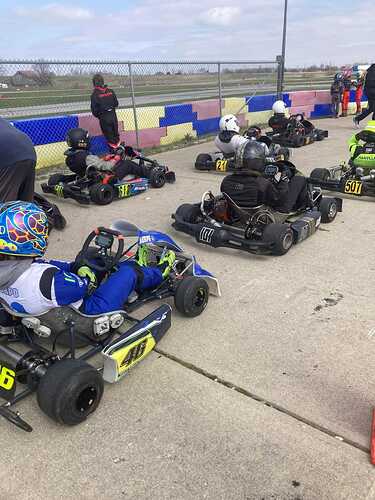

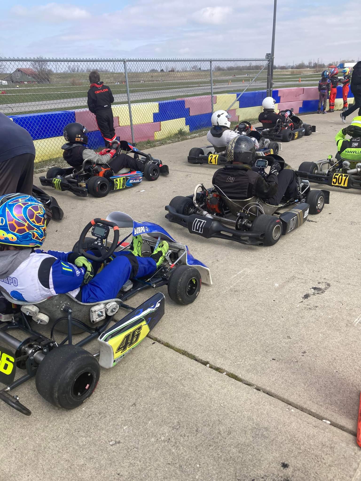

Dean, I am wondering why I am looking over at you in the one picture.
Probably thinking to yourself, “Who is freakin new guy?"
