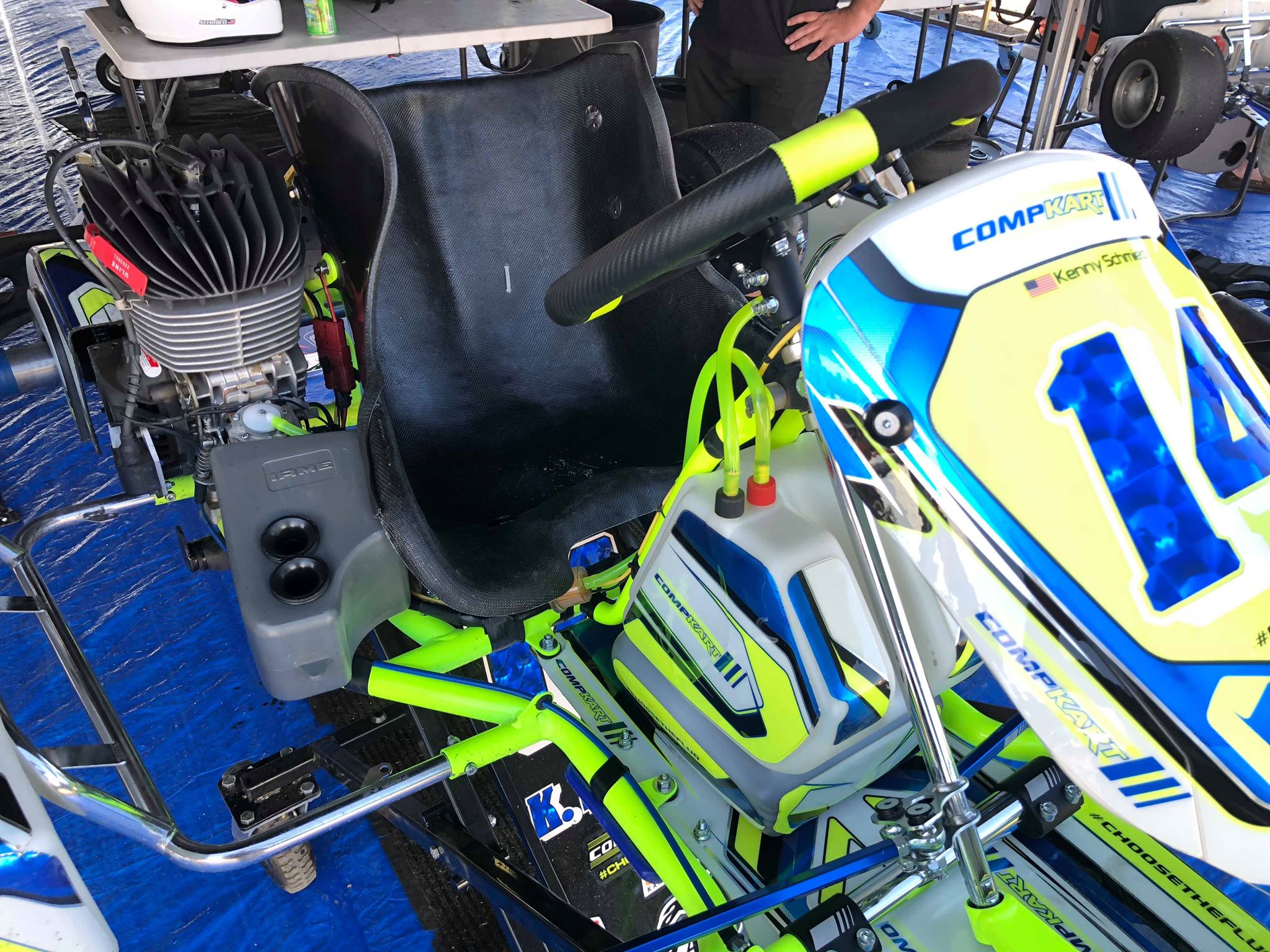

I figure this thread could use an update!
After looking around a bit for the Bengio with no luck, I went to a local kart shop and tried on the ribtect 4. It fit really well and the side panels didn’t end on that raised area of my ribs, so I bought it and gave it a shot. It was definitely less thick and bulky compared to the FreeM, but provided adequate protection. However, it soon became obvious that the rib vest wasn’t the problem. I tried to pad the seat in several areas, and tried both .5" thick foam (the sparco seat pads) and something much smaller, about .2" thick, when I realized the thick sparco pads were squeezing me too tight. I tried the seat with just the bottom and back pads (no rib pads) as well. The .2" pads worked well for being so thin (these are the ones I used), but really didn’t change much. I was starting to wonder if I needed to make a bigger change.
Then 10 days ago at a practice session I felt a pop on the left side of my ribs, and my back began hurting something fierce an hour or two later. It hurt so bad that I could hardly walk or close a door. Being that this was the second time I’d been to the doctor in my two months of karting (bruised ribs, over and over, and now a pulled back muscle), something needed to change.
I emailed Tim at DeepSeat a few days after I pulled my back muscle and spoke with him about the seat and the sizes. I had tried on a ML ribtect at a local shop (without a rib vest on) and it was HORRIBLY tight. We agreed the 15.5" DeepSeat was the way to go, so I ordered it with express shipping so it would be here in time for the last race of my season (colorado karting tour).
The seat came in on Wednesday and I mounted it on Thursday. I was still sore in the back and ribs and decided not to practice on the seat before race day. I was hesitant to do this, since I had no idea how the seat would feel or handle, or whether it would agree with my body and actually be a help rather than a step backwards. As recently as yesterday (one day before the race) I was doubting my ability to drive in the race. My back felt particularly sore, and I feared that I’d get a few laps into the day and “pop”. Thankfully when I woke up today (race day), I felt a bit better so I took some ibuprofen and off I went.
The track we were racing at is Unser Karting Centennial Colorado (used to be known as “the track at centennial”). In a KA100, mid 58’s is a good race pace for the lead of the pack. While I know the track very well as it’s my “home” track (I got into karting on their rental fleet), I didn’t know it very well in the KA100. My best after the 30 laps I had coming into today was a 1:00.5 (was a cool morning, probably similar to today).
In morning warm-up, I managed a 59.9, and I wasn’t following anyone so I wasn’t driving “their” line. After fresh tires for qualifying, I managed a near 59 flat. In my experience, new evinco blues are worth about .5 seconds (the tires I was on before qualifying today weren’t TOO worn out… maybe 50 laps on them total)… so that means I picked up at least a full second from being more comfortable in the kart.
And the best part? I was able to race all day with only minor discomfort from my previous injuries. Even now at home, when I would normally be cursing myself and reaching for the ice pack… I feel fine! I was so hesitant to try the DeepSeat since it’s a pretty big jump from the “norm”. But I can’t believe how hard I was able to push today and NOT pull a muscle or bruise my ribs! And best of all, from what I can tell… the seat had no negative effect on the karts handling. If anything, the seat really allowed me to just let the g-forces happen and focus on braking points and turn-in and exits. I wasn’t hesitant on the big-g turns, I wasn’t afraid of the curbs, and I was able to get through the last race of the season, on two-month-old injuries WITHOUT doing any more damage.
Seriously. Dom, thank you for the recommendation. TJ, thank you for having an amazing family that makes such an amazing product!
A few pics of the seat :slight_smile:
