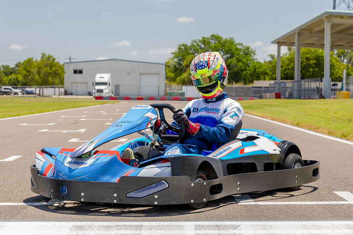

SODI RX8 :
SODI GT4R :
SODI RT8 :
On the RT8, you can’t get rotation under braking, the front tires just give up, resulting in screeching. Doesn’t matter how clean you are, you end up killing the front tires. Compared to the older ones, you don’t have the same freedom and it is a shame.
