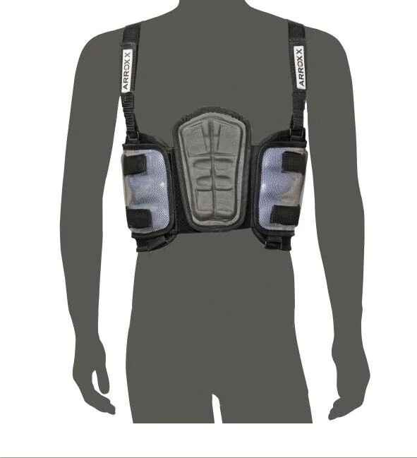

But i dont feel like i can justify $200+ on a rib protector. It just seems outrageously expensive for what is foam, fibreglass and some straps.
So i got an Arroxx TopQ rib protector for $25. One race in at a pretty harsh track and I’m doing about the same as i was when i had a bengio.
I have the same one. Can’t complain.
You got a slammin’ deal.
Yeah i snapped it up when italian motors had a deal on.
Of course now the bengio is on sale with italian motors too.
