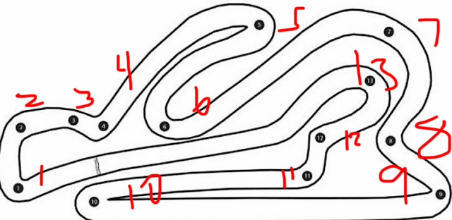

These are the turn numbers I use. Sorry for the crudeness, did it on my phone photo markup.
Intersting. I wonder why they say 3 and 4 are two different things.
Some number it differently, I have seen the t3-t4 kink labeled as t3 and the bend in the straight before t5 labeled as t4.
