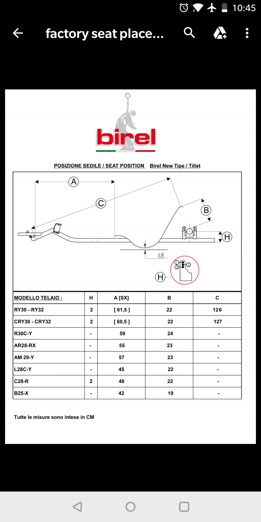

Hi, it’s a birel ry30-s5. I actually have the birel seat placement chart for the chassis but it only gives measurements from the top of seat to the front hoop. I wanted to know where to install it left right, so maybe distances from top of seat to each kinpin, but they chart doesn’t mention that

See attached my seat placement chart from Birel, but it only gives info for front rear placement. How do I know where to put it left right? Screenshot_20180912-224522
Unless you have scales, just center it between the bracket and don’t worry too much about it now. If you have access to scales, then over course get the left and right sides as close to equal as you can get them.
Don’t go all fancy trying to offset your weights for dominant corners, just put it in the center for now.

James I actually am gonna scale it but I wanted to know what the correct approach was to mounting the seat and scaling. From what you guys are saying it seems mount the seat as per the recommendations on the chart then put the kart on the scales with fuel etc and then distribute my lead to get the percentages I want?
I want to avoid drilling a bunch of holes in my new seat though this was my biggest concern
