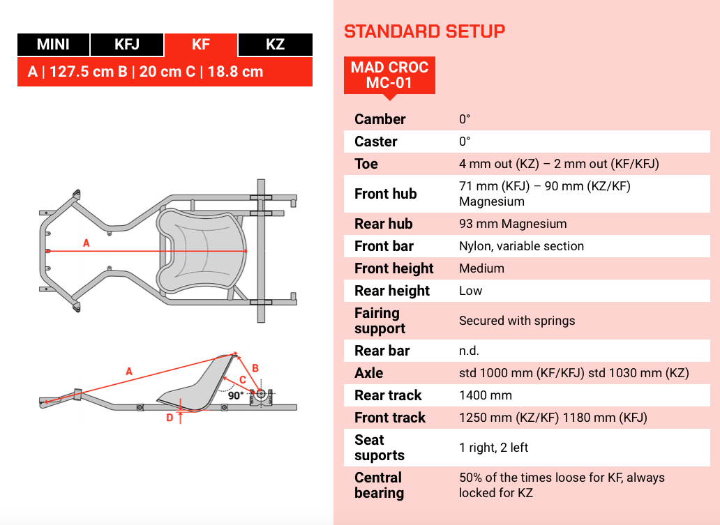

This caught my attention. Typically the rear of the chassis is set high and is rarely lowered. This gives me a suspicion that the chassis setup might be too far from standard to begin with… Might be worth going back to a “standard” base setting if you can get one and then tune from there.

James – Always good advise to go back to baseline, which is what I started with. Rear was at mid position, medium axle, etc. The kart works good with baseline at another track that gets more karts. This track is in the boonies, so less traffic and hence why we can still run there.

I saw Evan’s post on the Croc wheels so I was hunting around the internet to find what wheels they use. Instead, I found this which you may already have. If not, maybe it is useful.
Lower tire pressure - sounds right to me if you are getting enough heat in the tire already.
Wheels - The stock Mad Croc looks like a 3 spoke magnesium. Interested to know how different it is from the MXP and MXJ. Btw, I believe the MXP has been superceded by the MXJ.
Now for a crazy idea: If it is not too hot, you might even want to try an aluminum wheel. This is something that I am working on with a driver that I work with who is struggling with center-off grip on his SSE 175cc for street circuits / temporarily layouts that don’t have much rubber / grip (cooler days). I will let you know how it goes.
