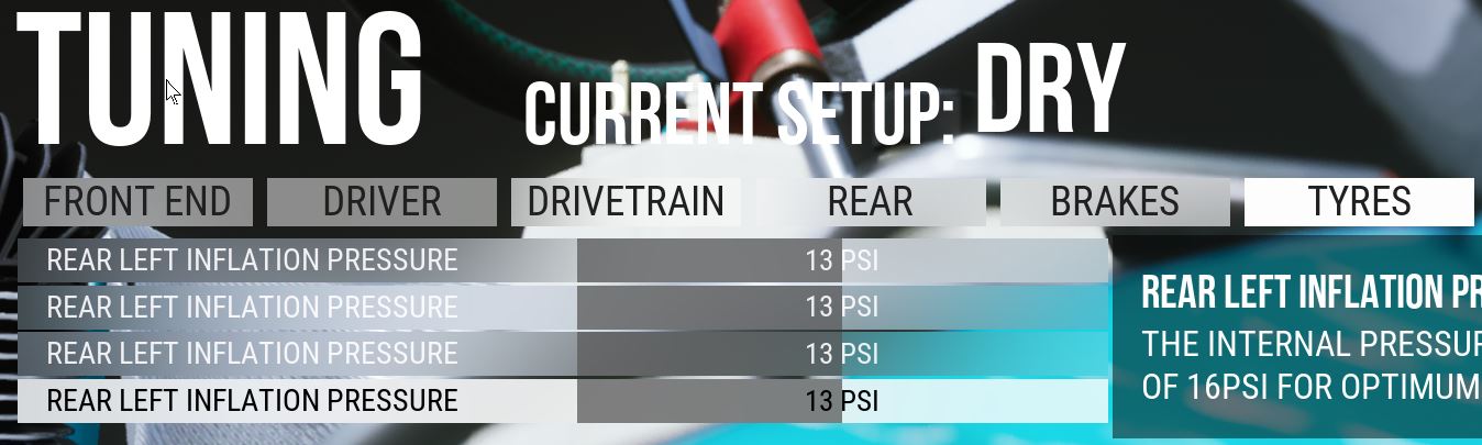

How many laps are you finding it to take to get the tires up to temp? It’s been 4-5 for me, running 13.5 psi.

If you do try ka, the gearing is fascinating. I am running 13 or 13.5 cold.

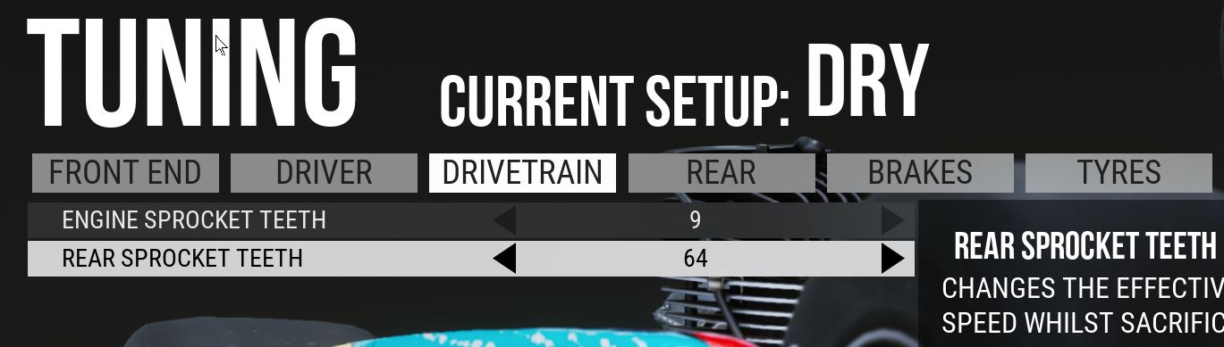

Observation: Gearing:
This isn’t making sense. If I combine the two back Sections into a giant straight to test top speed;
9-66: 64 mph
9-64: 65 mph
So you reallllllly have to have a ton of straight to get to the “limiter” (don’t hear it, actually). The last 4 mph are a slow rise.
I keep feeling like the higher teeth make more sense. Logic is as follows: sure, with tall gearing (9-65-66) time is lost in s1. But, if you get an ideal launch (kart path), you can be as fast as the shorter geared ghost to bridge.
You will probably lose the drag race to turn 1 of s2 but just barely. (Actually, I just landed a .00 S1 which appears to be as fast as it gets. So, maybe not.)
In s2, the shorter gearing is a huge advantage. I pulled a 23.0 s2 with 9-66, which is probably about 1.5 tenths faster than #1. I can pull in each corner of s2 and s3.
But, the main thing is how the kart drives and brakes geared taller. The braking makes sense finally. The kart feels balanced and alive and I can dig out of corners.
I’m a bit confused because with x30, the world record lap was 9-61 and most ran 9-61 to 9-63. I personally set my fastest on x30 with 9-64. I am finding that 9-64 - 9-66 is in many ways better with KA and it doesn’t really make sense to me.

Watching the first sector, you’d think there’s no way I could make up that gap. Wrong. Surprised the Bejeezus out of me, too. As you can see, there’s something to this crazy high gearing. 9-65, started at 14psi.

Gearing is 10-71, 13.4 psi cold
I messed around with tire temps. It seems like the tires get greasy around 18 degrees. Its subtle, but, my laptimes started to slow around 18.5 deg. and falloff was more noticeable at 20 deg. It was not so much in the feel of the kart, but in the laptimes. They were slow due to slight inefficiencies, as opposed to big slides. I just couldn’t quite get as much out of the kart.
I also messed around with gearing, chasing the fast sub 21s S1. I tried Eric Chin;s 10-71 gearing and also I tried his “Brake to rotate at bridge” suggestion and, Voila!
