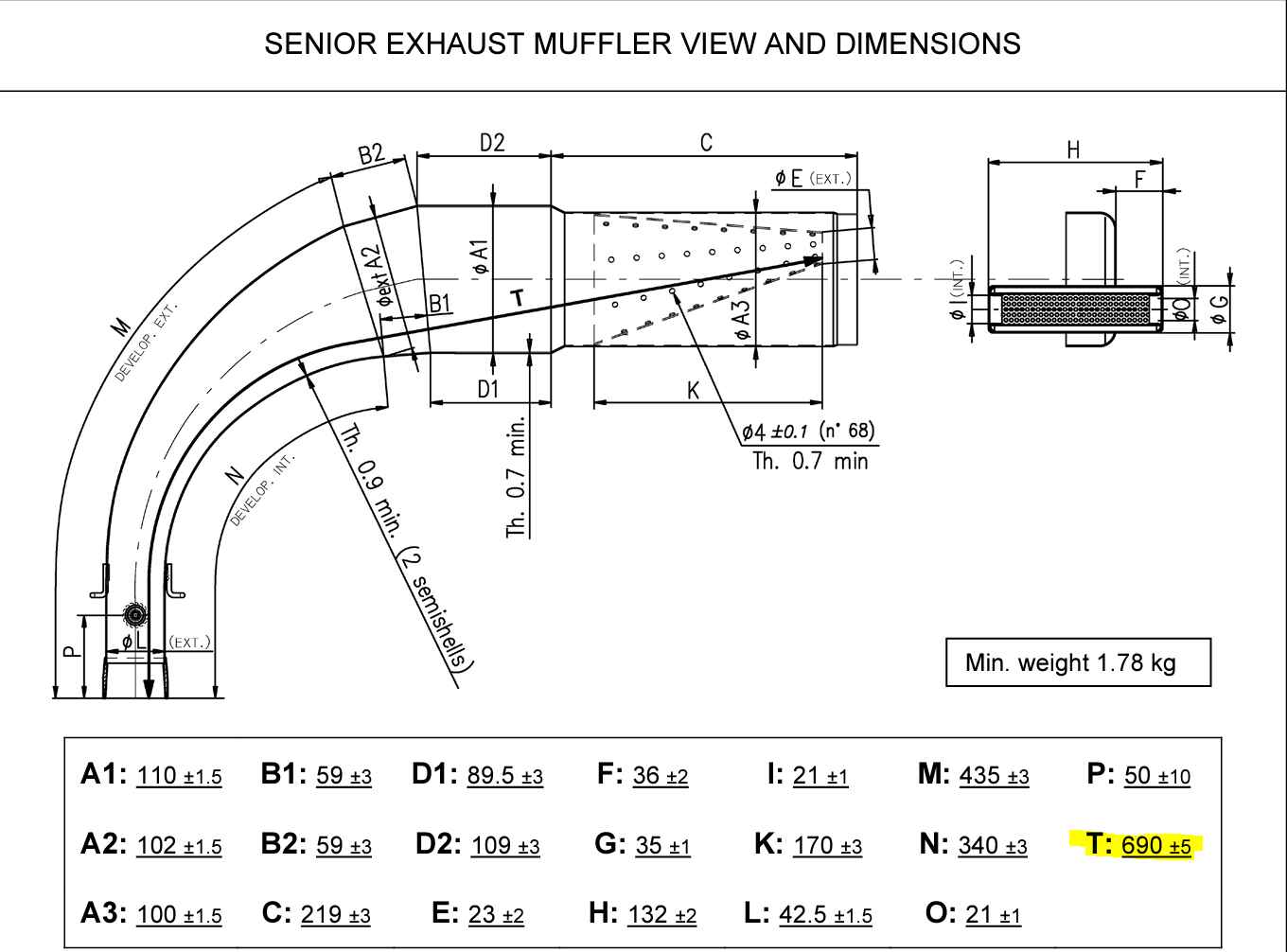

I’m not sure I buy the RPG pipe story. I’m NOT suggesting in any way that they cheated, but I am instead surprised that they didn’t know exactly what pipe went on their top driver’s kart, and whether it was compliant. In a spec class the pipe is absolutely a variable where power can be gained or lost, just due to varying measurements within the manufacturer tolerances. It certainly muddies the waters that the tolerances for dimension T (below) have been updated to +/- 3mm in the SKUSA rulebook. It looks like the rule change took place during the October 2022 revision, but it doesn’t appear there was a separate technical bulletin as SKUSA puts out for many other updates to the technical regulations. Ultimately it is the competitor’s responsibility to ensure his/her equipment is compliant. No way around that.
EDIT: I’d also like to see exactly how dimension T is measured, as it seems like the tolerance could be exhausted (no pun intended :laughing:) just by user error. Anyone know if they have some fancy tool for measuring this??
