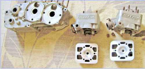

Ended up investing (?) in not one but TWO Rotax 256s. One of them was sourced from the pacific northwest, an OK condition set of cylinders, some nice heads, and a good looking crankcase:

The engines are similar looking, but inside completely different.
The UK engine has a later production code, holes in the crankcase for lightening, and bolt-on combustion chambers:
The west coast motor has built in head combustion chambers and a more robust (heavy) bottom end:

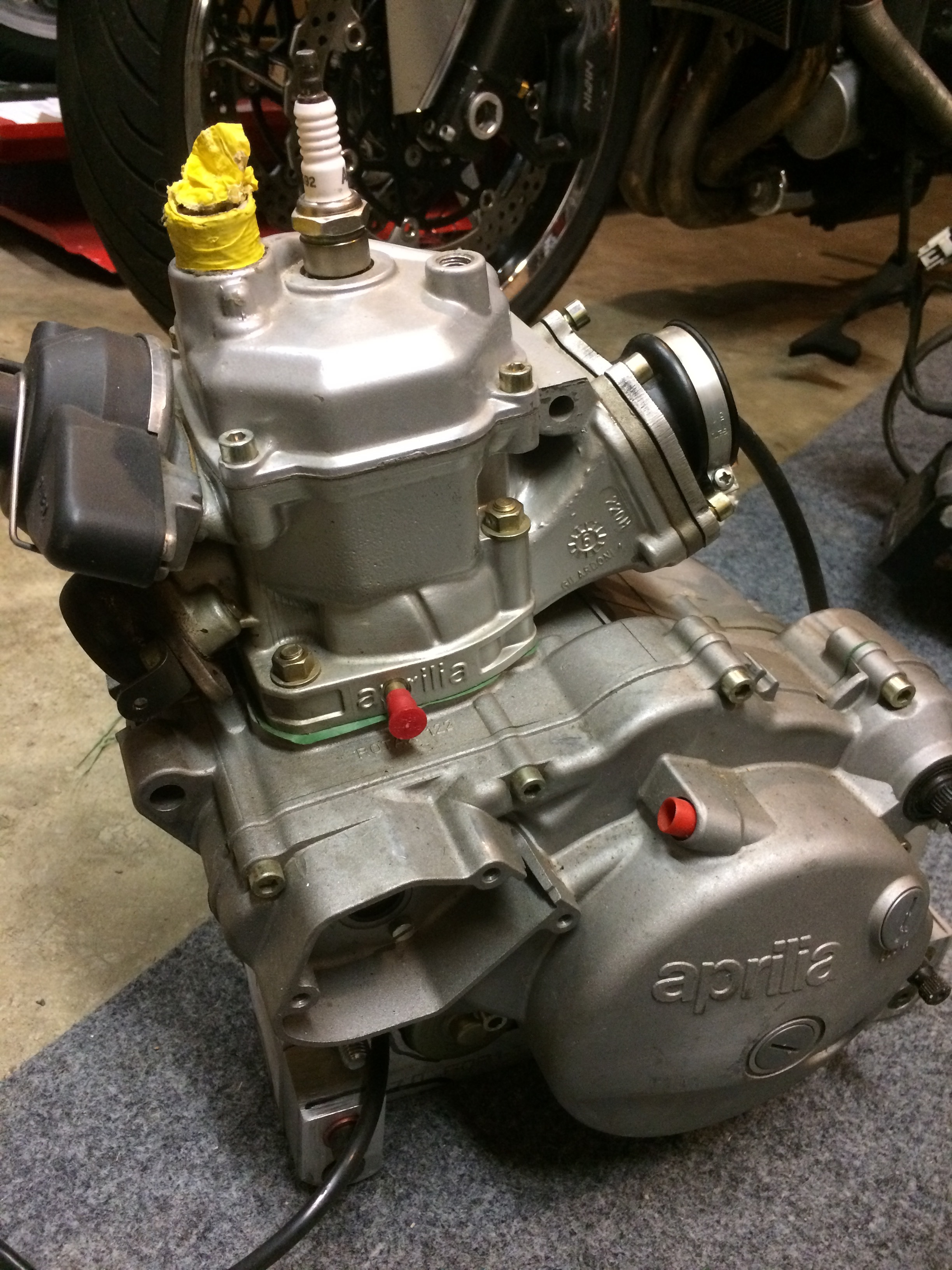

More lineage. I have repurchased the kart from Andre. I will be installing an Aprilia 125 motor with electric start. I will run the kart in the IKF FKE II roadrace class.

Talk a little more about the Aprilia motor you have.
James, the motor is an Aprilia Moto 125cc with electric start. Completely stock. I’d post a picture but I don’t have no idea how to do so here.
