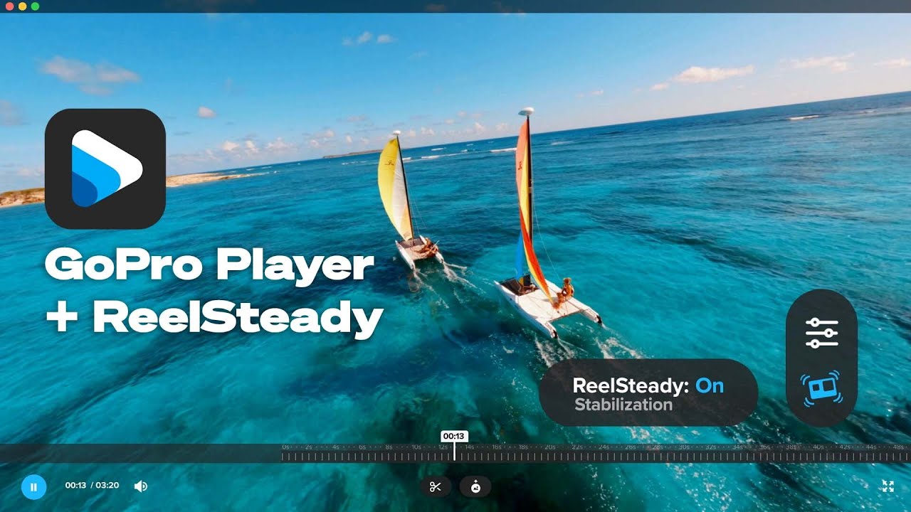

Oh cool! I’m not really familiar. Does this mean you’re shooting with stabilization off? And what angle then, can it still do super/hyper view? Does it manage to do it’s job without the extra cropping then? Interested to see the raw view :+1:
It’s a feature in Gopro player. It offers you the opportunity to try it and then when you go to export they ask you to purchase license.
Yes I am shooting with steady. I’m also using max lens view mod now.
The reelsteady crops slightly, but it’s doing it from superview with a max lens.
I’ll post the un-steadied for comparison tonight.

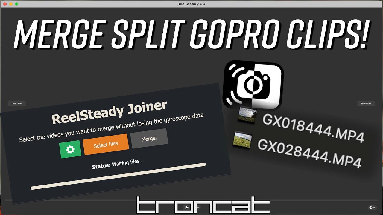

You’ll notice that where the segments meet in the video it’s dirty… that’s because segment one gets processed, then the other. Then they get combined. Can’t put multiple clips in Gopro player alas. I then had to go into premiere to combine and export.
I found this:
If you upload the segments to Gopro cloud, it joins them. Then you can apply reelsteady to one clip.
