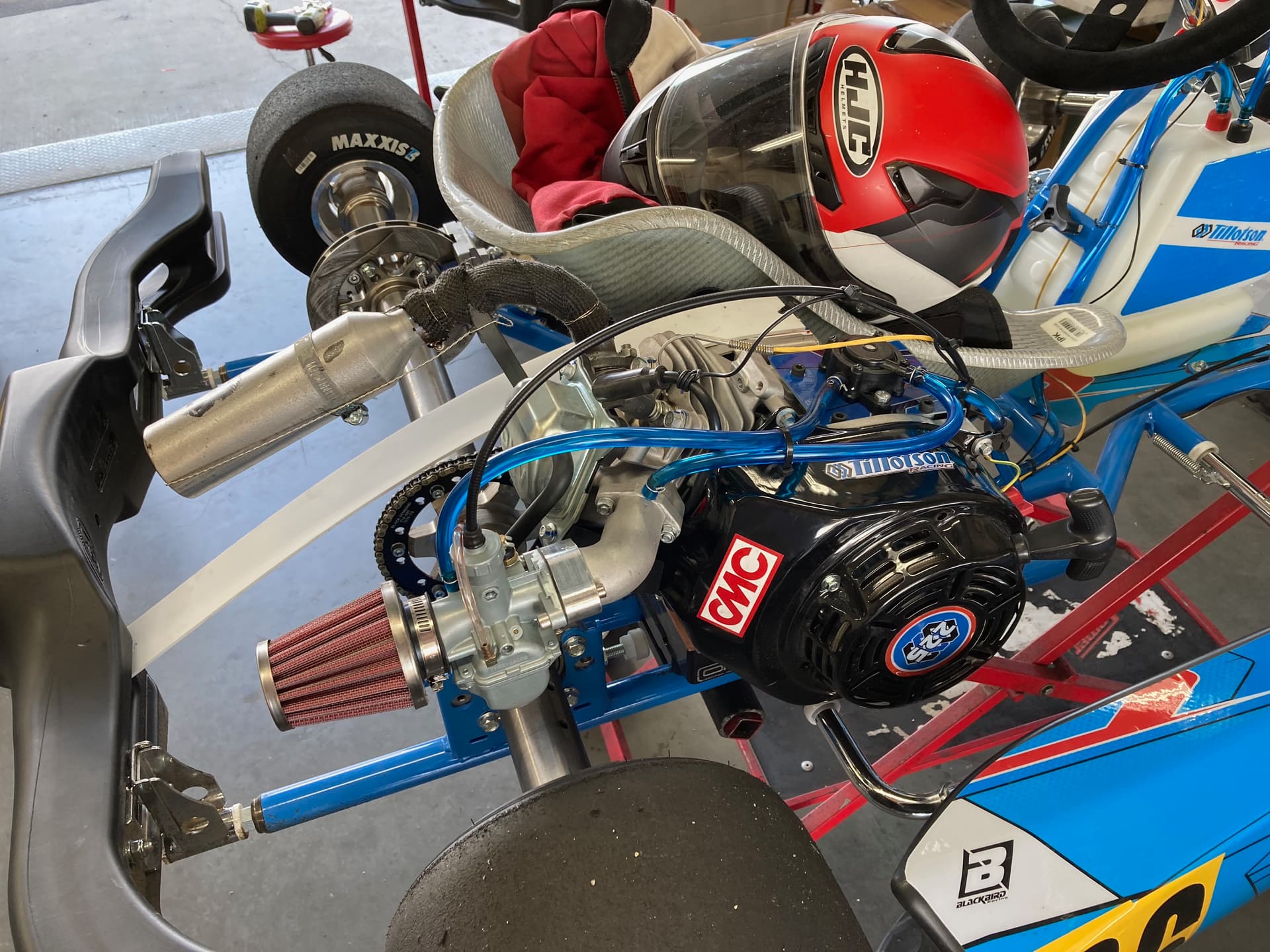

The T4 complete package along with the T225 engine class being run in the US are desinged to make karting fun and affordable. As a monobrand, the complete T4 package takes 90% of the kart setup variable out of the equation and really makes the race about the driver. There are a few things you can tinker with (gearing, rear axle length), but even there we encourage racers to share information to make the racing as close as possible. The T225 class allows drivers to use different chassis, which some people feel is an advantage, but the T4 chassis is designed to complement the engine, so we feel it is still the best combination out there. We work hard to keep the category affordable. We set the price based on a reasonable profit level, about 25% at each level, a little more on spare parts, so you shouldn’t see prices rise unfairly. We also put a lot of the proceeds back into prizes and supporting the classes.
I wouldn’t call the engine a GX clone. It’s based on the same geometry, but all of the key components are specially designed for racing and the digital PVL coil and our own Tillotson carburetor makes a big difference in performance. It is also tuned and matched to the T4 chassis to make the whole package feel like as much like 2 stroke racing as possible. Our own world-class drivers made sure it was a kart they would want to drive, not just a cheap kart to save money.

Again, one of Tilly’s biggest hurdles IMHO. If we are doing everything Briggs already does and/or provides, what makes us different? Why should someone switch? The T4 chassis isn’t enough and doesn’t answer the following from a cost v. benefit standpoint:
Is is engine quality? (Engines are built in China like most of the clones)
Is it performance? (They have the edge there, no question)
Is is cost? (A Tilly is almost double the cost of an LO206 and an inferior motor from a perceived quality and tolerances standpoint)
Not trying to be a debbie downer, but these are the questions that both Tilly and the end user need to answer to before they can comfortably meet in the middle.
Perosnally speaking, I was trying to get there and go to Tilly, but at the end of the day, I just couldn’t get there and decided if I wanted more speed, I needed to cross over to the dark side and go 2 stroke.
Having run these a couple times now. They are not double the cost. As add clutch and mount to go. They are more expensive though
A friend is doing a burn down on hours. All he is doing is changing the oil and lapping the valves at a set interval. I think he is already at the 50 hour mark on the hour meter.
The power band is far superior.
I personally got one to throw on a kart and just pound out laps. To extend rebuild intervals on my 2 stroke.
