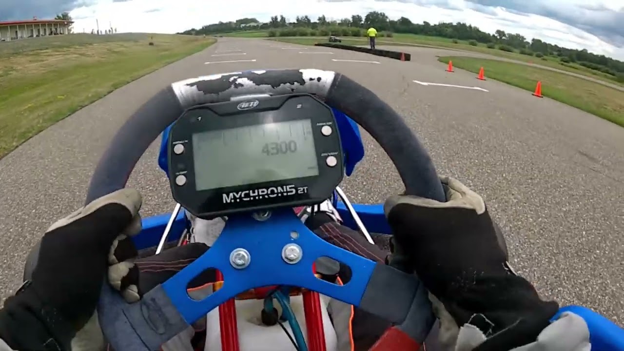

I actually “Raced” 225RS motor last weekend, two kart totally in Outlaw, other kart has a KZ R1. He give me a 11 turns jump start and try to lap me twice in 8 laps for heat 1 & 2. Last heat, we did 4 laps race standing start, and I did not get lapped. LOL
I really like the throttle compare with 206/WF, 206 throttle is mostly on or off, and 225RS has a longer throttle open, so you can kind of do some throttle modulation.
Engine cold start seems to be a bit pain compare with 206, you will need someone to start you and usually take some pulls.
Laptime wise, I am running the same as our SKC spec WF(moddied WF with not rev limiter), but the chassis is not tuned, either the driver.

In case someone wants to know how the engine compare with a KZ on standing start, it is mega!
