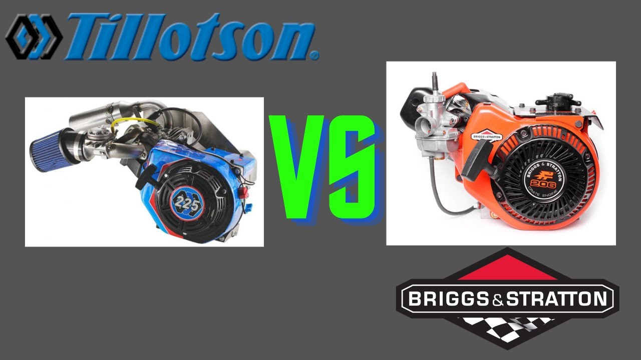

Haven’t watched this yet so can’t comment on it perse. Sometimes the white knuckle guys get a little hyped up :joy:
Theres a gentleman on the show (with a rather impressive racing background) who has been racing them both extensively. To summarize:
Tillotson: Very good bottom end and very good overall. No weak points. Faster.
LO206, less fast, and I got the impression, a little less engaging from a driving perspective.
However, the properly broken in LO is a beast that runs forever and he has one at 40hrs still going strong. Also, the parity is very high. Take 3 LO out of the box and they will be very similar. He owns four tillys and they vary to the tune of 2/10ths difference.
He likes them both equally and feels that they race differently, but equally fun. He feels that there’s room for them both and appears to enjoy/like them equally.

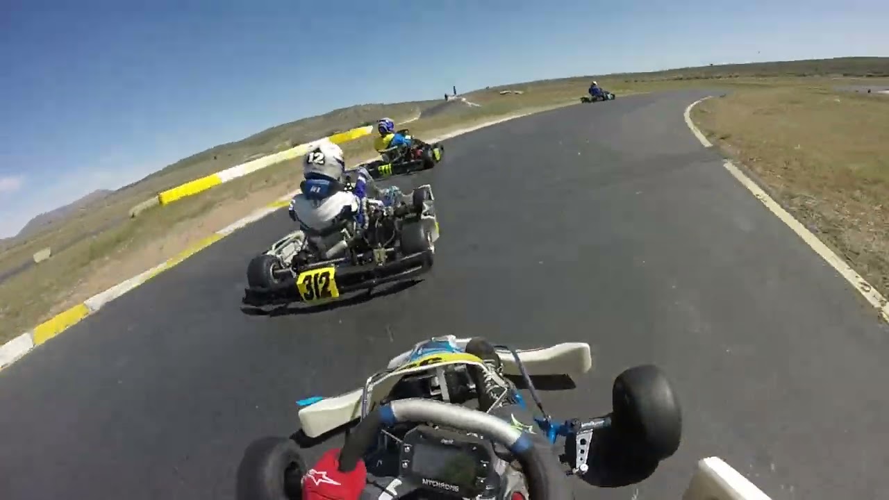

Superstock LO206 vs Tillotson 225
Found this video online with the Superstocks which I believe are 13HP vs. the 15HP Tillotson. Seems to be fairly even.
The problem is there are 30 Lo206 entries at my local track (Pittrace). The track is on a time limit, so they are not going to add another class nor would that allow running at the same time.
The Ka100 class is gaining traction and again the speed difference is pretty big between the two, so I doubt they would allow me on track. If I run in the road racing series It would be in the open class where 100cc would take you to task, if they are nice maybe they would allow you to run 370/390/Pro gas.
Again no testing to show how that would go. I understand the logic of wanting to go faster but seems like the Ka100 (Maybe VLR 100cc) are pretty tough competition.
Data and rebuilds would seem to be very important in decision making. Having raced the clone those weenie pipes seem to be first to go, having those handy seemed to be necessary. Perhaps the quality changed?
Gas SS206 is 13ish. Add another 1.5 HP for the alky.
Tilly had a weight break on that video.
SS. ALKY 14.5 HP at 390 LBS Vs. 225RS 15 HP at 360 LBS less weight and more HP make the 225RS equivalent?
Perhaps the inconsistency of the 225RS engine that was alluded to in the Fight for the Best Engine video is the rational?
I think the flywheel? on the 225RS is too light and also the torque curve. The extra HP is not really in good use compare with a ss206. 225RS was designed for dirt race in the first place is what I heard. Throttle modulation is much more important on 225RS than 206.
Rev limiter on the tilly.
